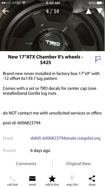

    I just wanted to double check that thease wheels will fit my 05 trd off road. Sorry for the dumb question I'm just starting to look into wheels for my truck.IMG_3051.jpg

    Better make sure they have the correct center bore size which is 106.1 mm. Better have some lift. What size tires you planning on running. These wheels are going to stick out roughly 2.5" more than stock with the original tire size. I would say you need 2.5" of lift to clear a decent tire on this wheel.

    I would not go wider than 8" wheels for that size tire. Better off going 275/70 or 285/60-65. With 3" lift up front should be ok. I just would not want that much negative offset. Tires sticking out that far will sandblast your lower doors and behind rear tires and damage your paint. That is if you have good paint. Better off with a zero offset wheel. You could always add spacers if you want a little wider track.

    FYI you can buy brand new wheels from $90 to $120 each so $425 is not that great of a price for an offset that may not work that well. Just my 2 cents.

    That same wheel is $120 new delivered. The center bore is 108 mm which means you will need adapters to center the wheel on the truck. I would not buy these for a Tacoma.

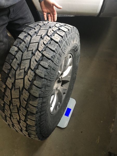

    10ply toyo atII 265/75r16 on stock 2016 sr5 Tacoma wheel

    Man that is a lot of weight. Still probably a few pounds lighter than KO2's. I would do the chalk test to get your air pressure right to avoid any cupping.

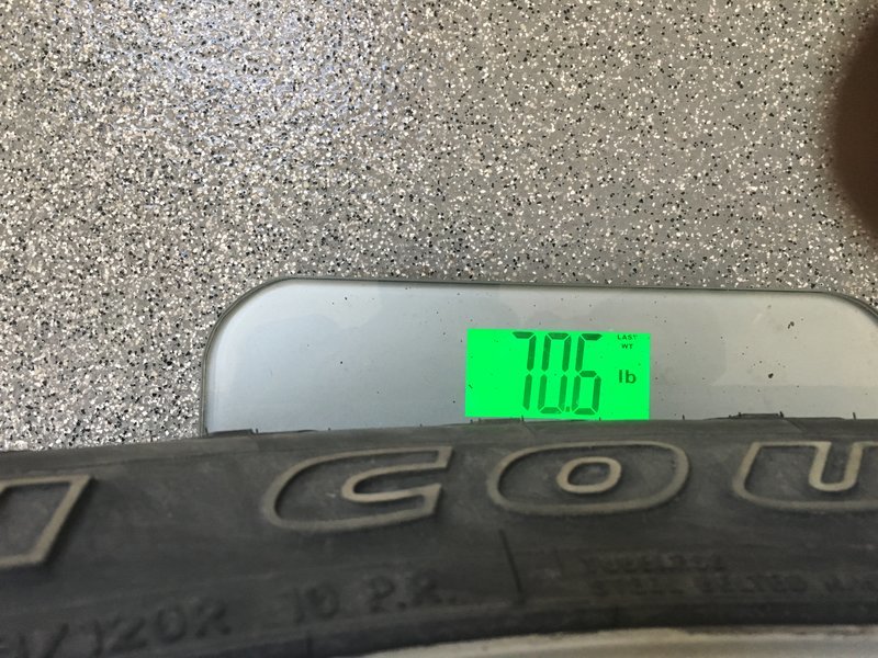

    162
    Ted
    Mississippi
    2017 Quick Sand TRD4X4 0ffroad
    Bilstien coilovers Toytec AAL w/fox 2.0's Sway bar relocate Carrier bearing drop ECGS needle bearing delete 285/75/16 Dick Cepek Extreme Country
    I'll bump hat question. Was looking for hat myself. About to get some new wheels and want to make sure they are as light or lighter.
