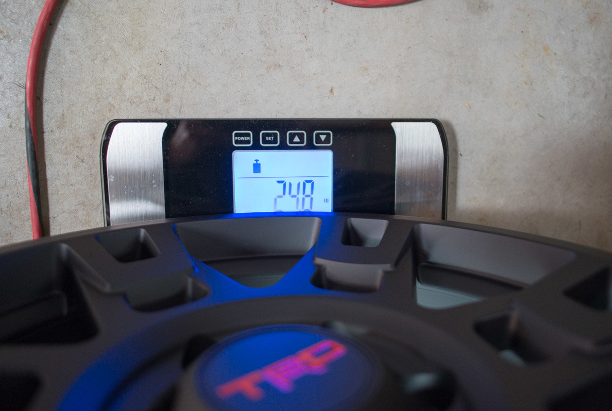

    For those curious - I weighed the Sema 17" Pro 4 runner wheels a few months back.

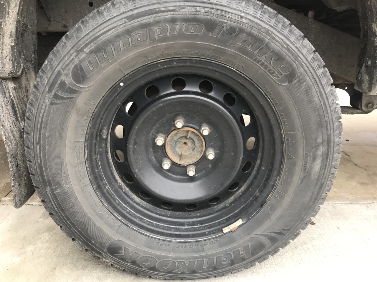

    I always wondered if my steelies were Toyota steelies. Notice the white dot on the wheel. Like the vacuum hoses. They all have it. 17x7.5
