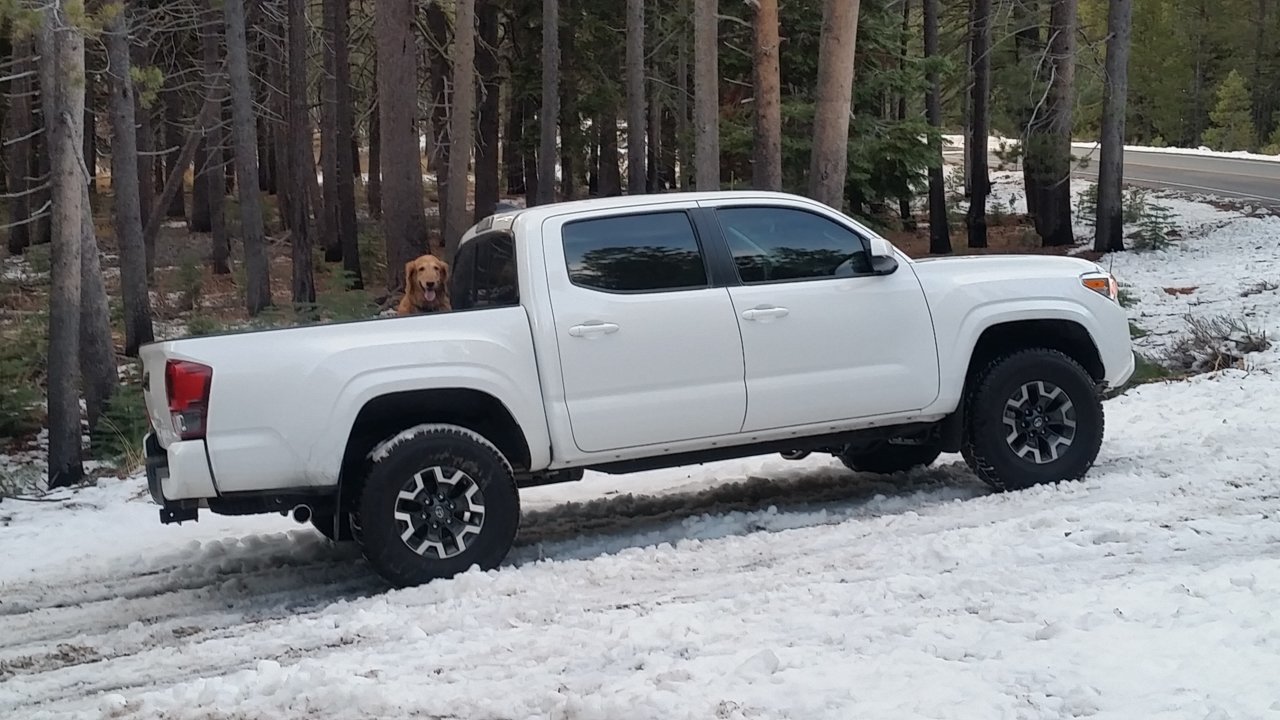

    Here's a few. Got 265/75r16 snow tires on for winter. Summer I run the 4runner Pro wheels with 265/70r17 Wildpeaks. Really like the offset on the pros. Stick out just right. Sold the steelies. Kinda want to swap the winter wheels for a set of the 16" anthracite or satin black 16's that are on some of the SRs as an option. My winter setup looks clean/oem but the summer setup looks bad ass.

    Great looking truck. How many inches do they stick out? You have OEM or weather tech mud flaps?

    Thanks. I didn't measure but I think 3/4". I found other pics on here before I got them. They sit dead even if you have flares. I liked that they would look good without flare sticking out a tiny bit or flush if I add flares. The flaps are 9" Plasticolor from Amazon. Love them. Some rock and snow slush protection, they almost dissappear with the black wheels, flexible so they won't break if you snag them off roading, cheap, have an oem look and they're flat so no tire rub. I researched for a long time on those.

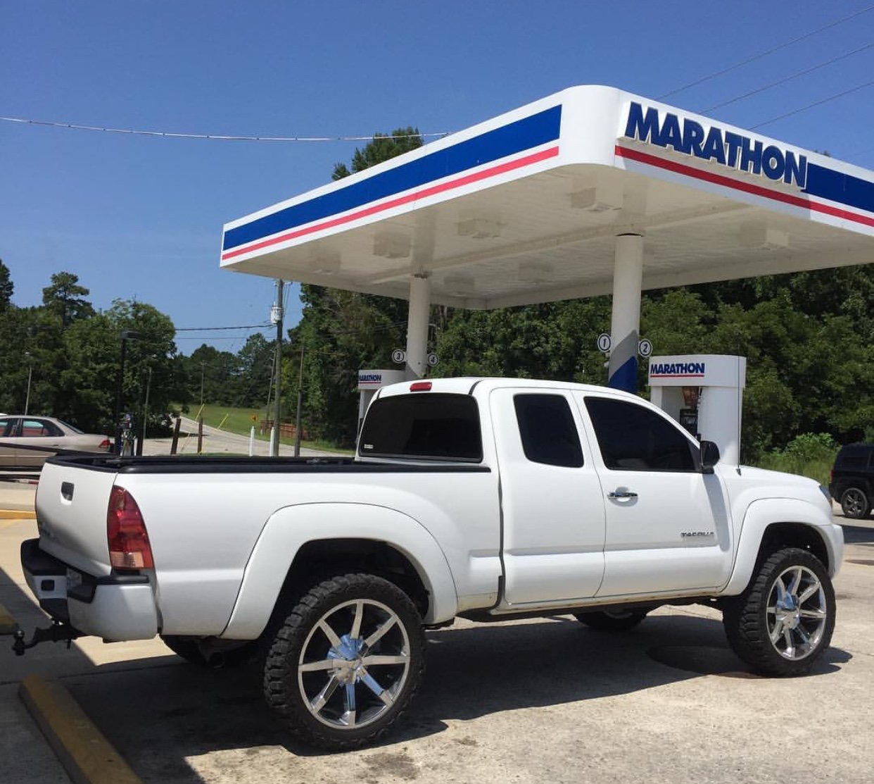

    3in lift
    33x12.5r22
    22x9.5 kmc slides +15 offset
