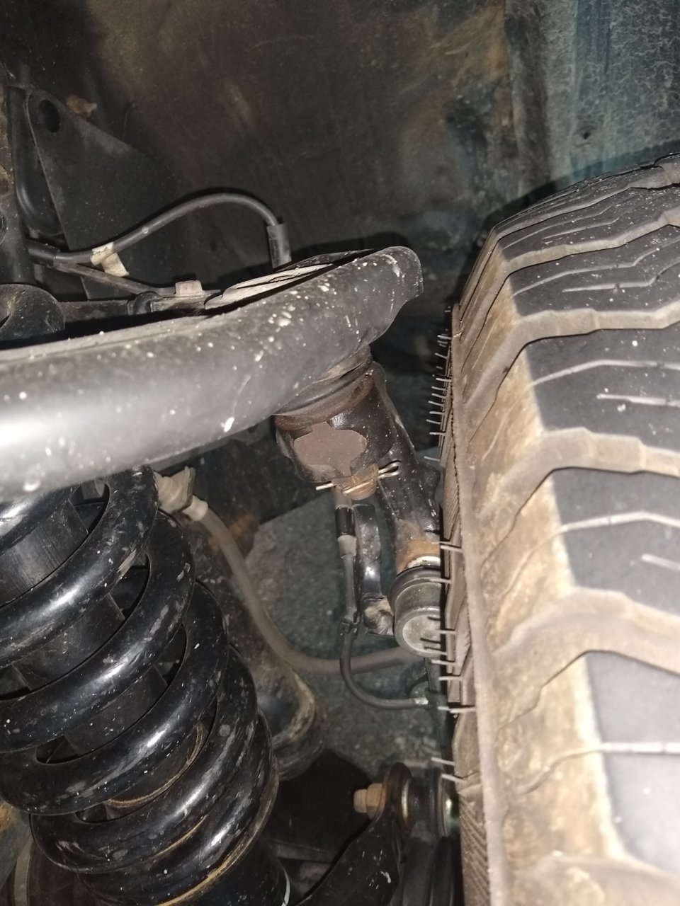

    I just swapped my stock coilovers for a fresher set of stocks with 2" toytec spacers installed, the clearance behind my 265/75/16 tire (on stock gen 2 TRD-OR wheels) to the upper control arm is pretty tight, but there's about a full fingers width of clearance and I haven't experience any rub, and might change slightly once I get the alignment complete. Can snag a couple pics when I get home of the internal clearance to the steering components, but here's what I've got for now, showing tire/wheel/lift in the well.

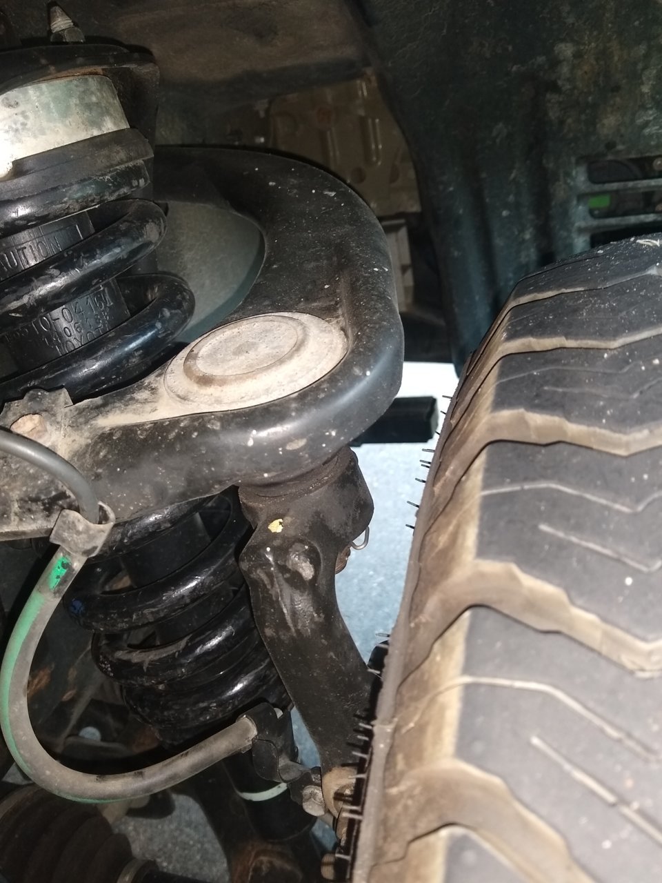

    @ThirstyLizard finally remembered to take pics before I left her for the day (while the sun was up...aka I was late to work :anonymous:)
    Driver side looking rearward
    Passenger side looking forward
    Passenger side looking forward with sausage fingers for gap gauge/scale and view of toytec spacer
    P.S. this is pre-alignment
    ThirstyLizard likes this.

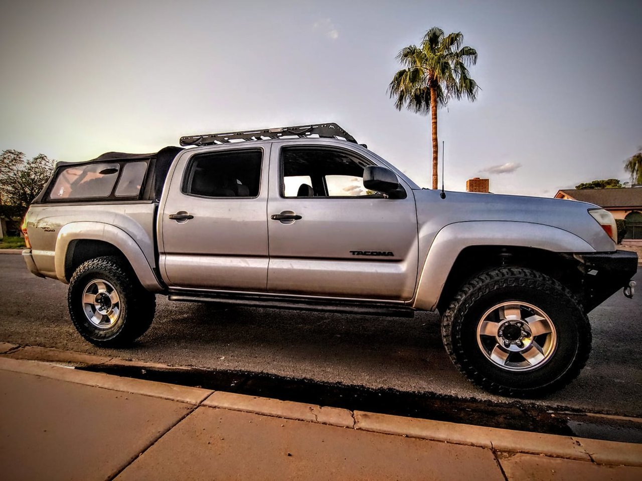

    Probably nobody needs this info but after a lot of searching I found the specs for these:
    Toyota OEM FJ Cruiser Machined Aluminum Wheels (OE part#: 4261135370)
    Lugs: 6
    Bolt Pattern: 5.5 Inch
    Offset: 15mm
    Backspace: 4.5"
    I'm getting a set of these and have been trying to decide what tires to put on them.
    Kind of going back and forth between 285/70 and 255/85...

    LOL, I forgot to post my update...!
    255/85/16 Cooper ST Maxx on the FJ wheels.
    So far, VERY happy with the way they roll. Still need to get out on a trail and beat the hell out of them but since the wheels are Toyota OEM, I'm pretty confident they'll be up to the task.

    Badass looking. Those appear way wider than 255. But 85's must be around 33". Very nice.

    Yeah, it's a side shot and has the benefit of a wide angle from one of my camera phone lenses.
    They are a proper 33", definitely taller than my old set up of 275/70/17.
    I'm excited to see how they doing wheeling with more sidewall in aired down situations.
