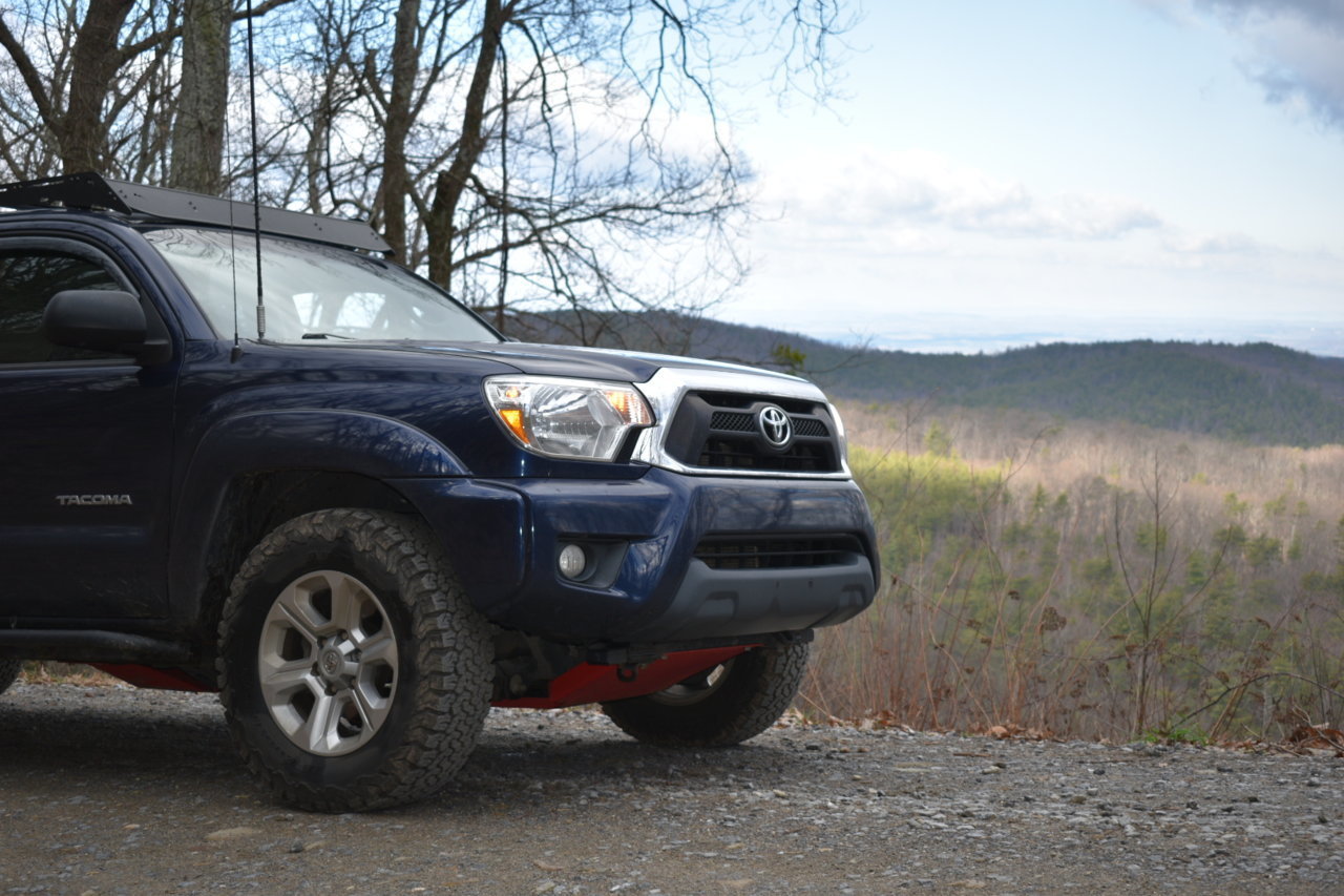

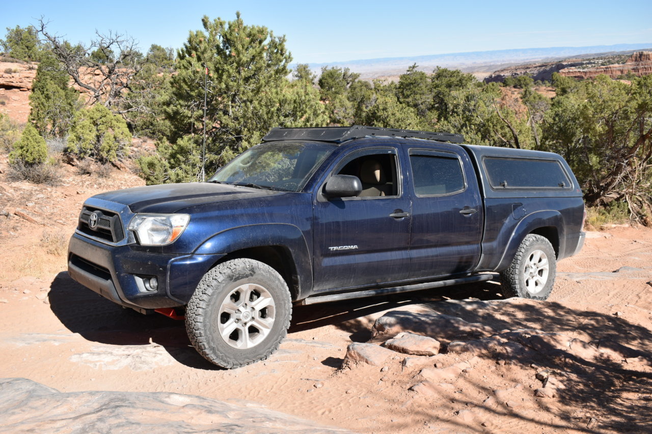

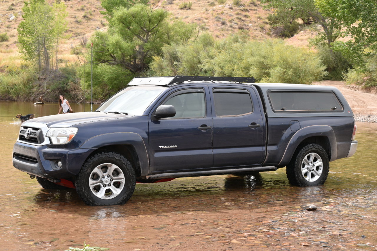

    #511
    gixxerphil
    gixxerphil @concretelander
    Mar 31, 2018
    #249012
    23,124
    Phillip
    Auburn, Alabama
    2013 DCLB
    Here ya go.
    Original's with 245/75/16
    T4R's with 255/70/17 and the same original susp. I have the IMS Dobinsons with HD leafs to put on now.

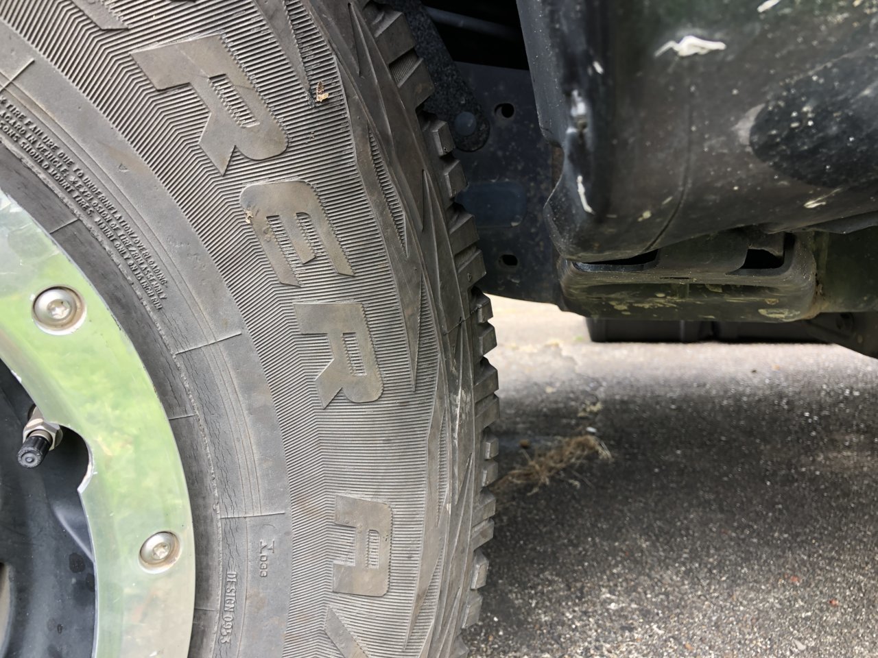

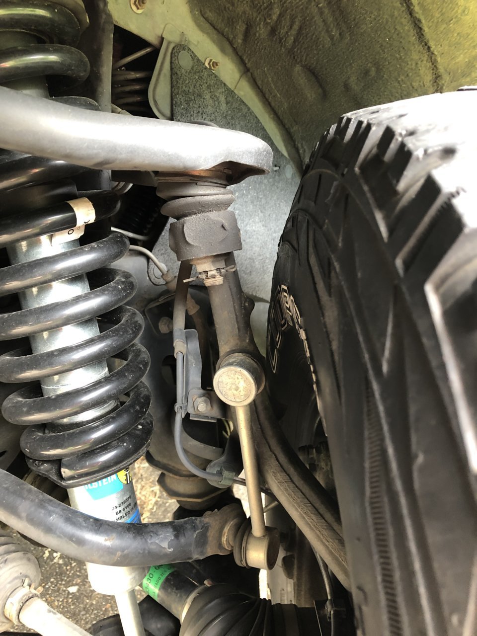

    RoughRder
    RoughRder What fresh hell is this?
    Jun 14, 2020
    #331426
    177
    Garrett
    Hampton Roads, VA
    2011 DCSB TX TRD
    5100s and OME 885 coils front, 5100s and AAL for the TSB leaf pack (overload left in) rear. Jeraco camper shell.
    Thanks for this. Used this thread to guesstimate potential rubbing issues with my TRD Beadlook (Beadlock) wheels before going to 285s. No cmc needed and no rubbing on the steering.

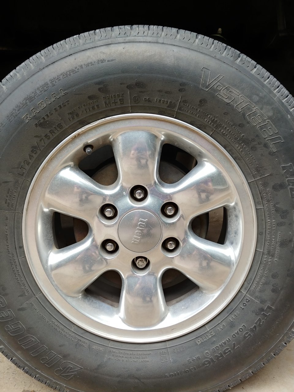

    ohcaltexscar
    ohcaltexscar Out of Huckleberry Licorice…
    Feb 28, 2020
    #320594
    1,740
    Chas
    Southwest Ohio
    2005 DCLB SR5 Prerunner
    IM4x4 2.5" NitroGas - Coopers
    My ride came with the Gulf States Toyota 6 spoke wheels, I have noticed they are not as common.
    I pulled the specs from the castings on the back if that's something worth adding to your list.
    Part# 929-GST
    Dimensions: 16x7 J +30mm (I'm not sure about the significance of the "J")
    Weight: Unknown at this time. When I get new tires installed I'll see if I can get the shop to weigh the empty wheels.
    Backspace looks to be 4.75", I just put a straightedge across the back lip and a ruler up from the mounting surface so I was not 100% on that.
    It stands to reason though, ̶c̶e̶n̶t̶e̶r̶ ̶l̶i̶n̶e̶ ̶o̶n̶ ̶a̶ ̶7̶"̶ ̶w̶h̶e̶e̶l̶ ̶i̶s̶ ̶3̶.̶5̶"̶ ̶a̶n̶d̶ ̶3̶0̶m̶m̶ ̶=̶ ̶~̶1̶.̶1̶8̶"̶ ̶g̶i̶v̶i̶n̶g̶ ̶u̶s̶ ̶4̶.̶8̶6̶"̶.̶
    EDIT: Wheel width ÷ 2 + offset + ½” = Backspacing. So, 7 ÷ 2 = 3.5 + 1.18 = 4.68 + 0.50 = 5.18"
    "Mold 1" and "PRIME Made in USA" are also cast into the back.
    Hopefully this is useful to somebody out there.
    Here's a picture of mine.

  16. Jul 1, 2020 at 3:03 PM
    #516
    replica9000
    replica9000 [OP] Das ist no bueno
    Apr 6, 2008
    #5782
    16,423
    Lake Chargoggagoggmanchauggagoggchaubunagungamaugg
    2019 T4R ORP
    I need to finish adding wheels to the first post. Believe it or not, I got hung up on finding info on the basic steelies.
    If you know the offset, you can calculate the backspace: Wheel width ÷ 2 + offset + ½” = Backspacing
    Edit: Many people don't realize a wheel's advertised width doesn't include the lip on each side. If you have a 7" wheel, it should measure 8" from lip to lip.
    dirty deeds[QUOTED] likes this.
