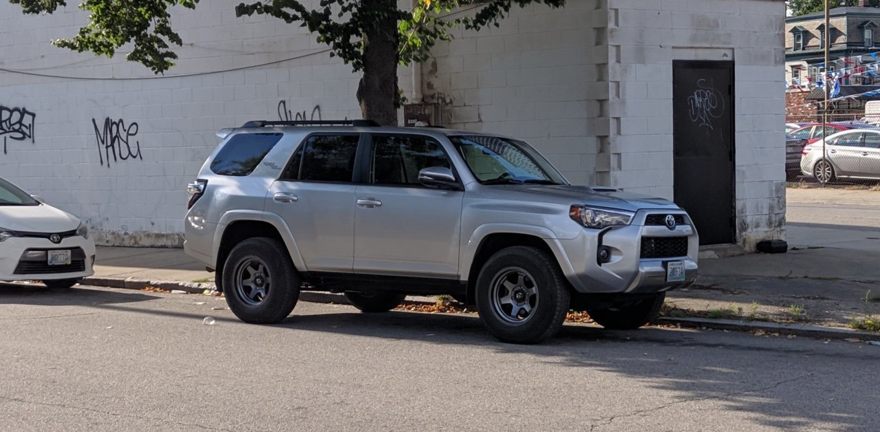

    This was when I tried 255/80R17. Looked ok from some angles, too skinny from other angles.

    It looks pretty good actually! The potentially squeezed in front is what bothers me, especially whilst executing turns.

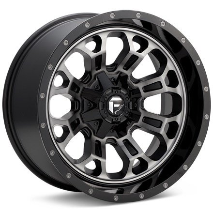

    I'm not close to pulling the trigger on anything yet, but these are the early favorites right now.
    while not really close to the same black as the Midnight Black of my truck, here is what they would theoretically look like
    17" x 9" (+01mm offset)
    Just need to decide on a tire now.
    ohcaltexscar[QUOTED] likes this.

    I just put on a set of Fuel wheels myself. I like them.

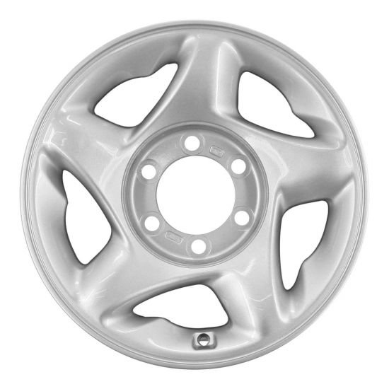

    What about gen 1 wheels?w69395s_3.jpglooks like 16x7 15mm off set

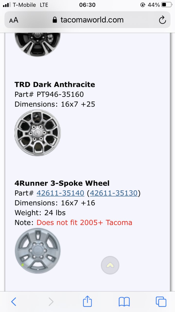

    Okay guys i need some help, i had the OG 3 spokes on my
    Gen 1 1995.5 tacomai upgraded to the anthracite wheels. This is frustrating; on the anthracite wheels i was originally running 265/75/16 with some minor slight frame rail rubbing from the driver side tire only.
    i swapped them out to 265/70/16 thanks to our vendor on here, discounts tire. Now i am getting less rub from the 75 series but now i am getting rub from both tires. Ive came to the conclusion that i need spacers, will a .75” work?
    Is That 9mm of offset difference, must be causing the rub? I thought for sure going down 75 too 70 will remedy it.

    Hey guys, I have a 2020 Tacoma sr5 and as you mentioned above, I want to confirm the offset is +25 and not +30? I have the SR5 alloy 3rd gen. I’m looking for winter rims so I want the same offset so I can use the same lug nuts. Any help would be appreciated thanks!

    It is 25mm offset
