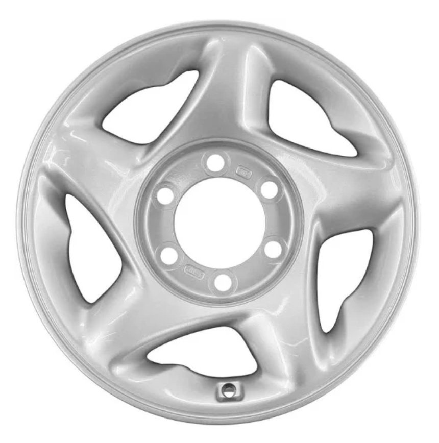

    Ok, so I spent a couple hours on here and other sites looking for specs for the 1st Gen OEM TRD "Star" 16x7 wheel. I wasn't ever able to locate the weight. I found anywhere from 24-27lbs. online from best guesses. So I emailed a few ebay folks and one person said about 25lbs. and another said 19lbs. UGH! Anyway i picked up a local used set mounted to half worn 265/70/16 General Grabber AT2. General lists these at 40.5lbs. On the scale without caps (they weigh next to nothing) scale reads 62lbs. With this info....right around 22lbs. I should save about 8lbs. vs. steelies.
    So what I'm getting is...
    16x7 (6 lug)
    +15mm offset
    21.5-22lbs.

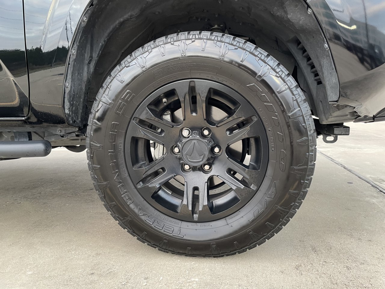

    C8C63E73-3CD9-45E6-B029-1BA1B3843B54.jpg These wheels are from my 2019 Tacoma SR with TSS package. The TSS package has dealer added accessories to make the truck look cooler but only in the gulf state region. I combed through this thread and didn’t see any info on these wheels. They are 17x8 but don’t know the offset and backspace. Curios to see if anyone had anymore info on these wheels.

    Not sure if this has changed in recent years but if you pull one of the wheels off and look in the back side the dimensions will be cast into the wheel, usually along one of the spokes.

    Cool. I’ll have to check and see if it’s there. Thanks.

    You can also input the specs in a google search if it’s just some weird code and you will find the translation. Hope it works for ya!

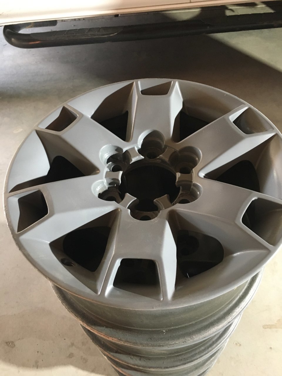

    Will wheels from a 2000 4runner fit a 2008 Tacoma TRD? I read through all 28 pages, and didn't find a specific answer. The picture on the first page says will not fit 2005+ Tacomas, yet on page 21, it says 4runner wheels will fit, just stick out maybe 3/4" more than my stock wheels. Any input?
    Link to page 21 reference- https://www.tacomaworld.com/threads/wheel-specs.30754/page-21#post-16016092

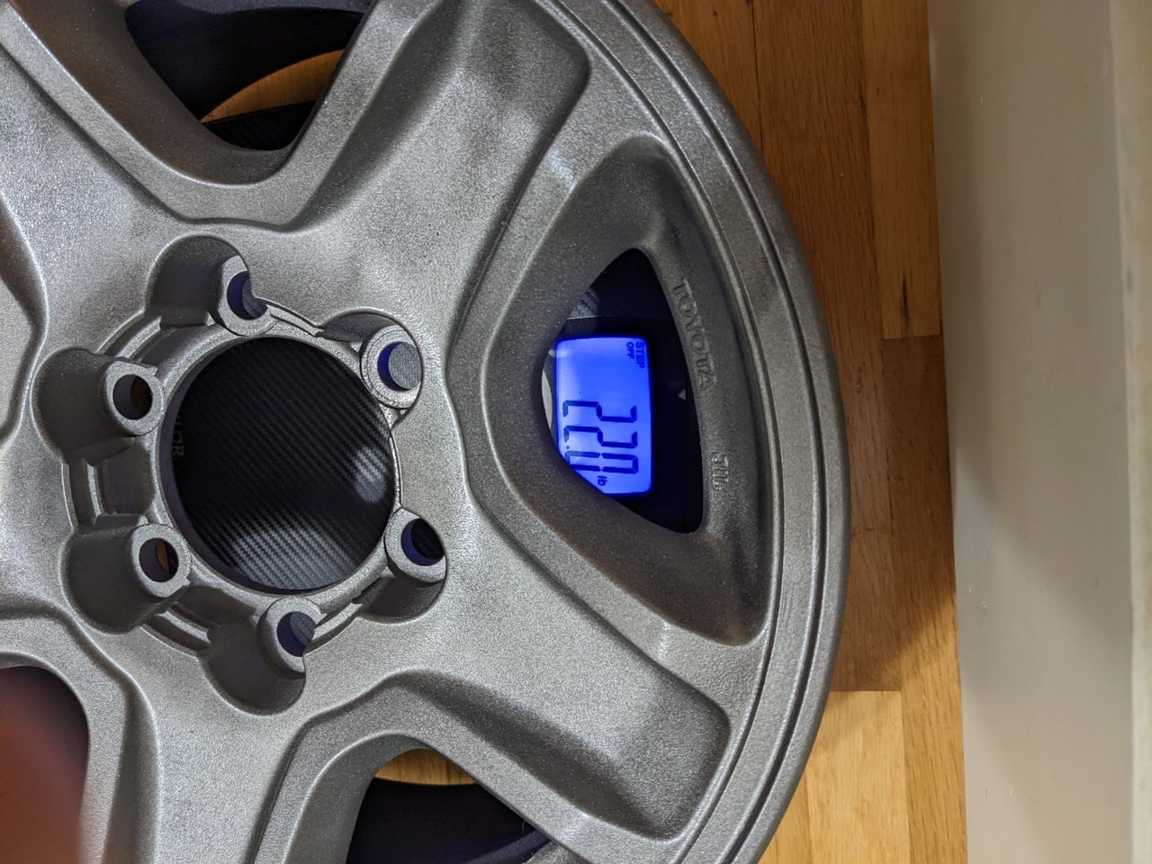

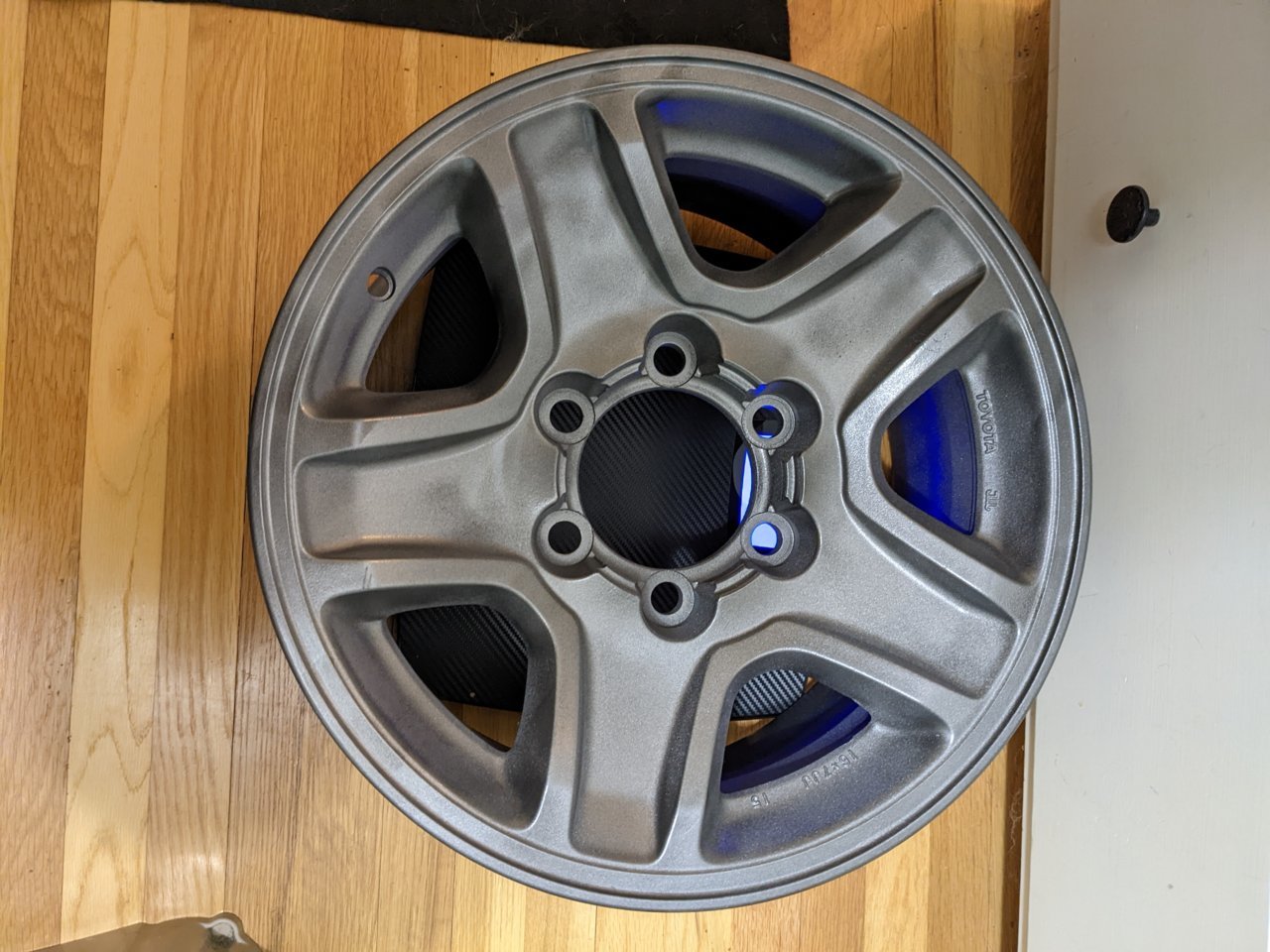

    I've seen these wheels around the forums, just restored some junkers and can confirm the weight
    3rd gen 4RUNNER - Limited
    16x7
    weight 22lbs
    Original color: silver
