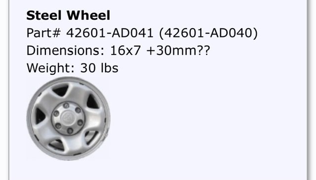

    I did a search and found TW, with a reference that stated 28 lbs. When I did a winter tire swap of 4 tires/8 wheels from the original steel wheels on the 2009 Gen2 (this PN) I weighed these at 28 lbs. The Gen3 TRD Offroad wheels weighed 1.4 lbs. less. both are 16x7J and I was wondering about the "25" cast on the inside of the alloy rims. That's the offset, and I will look on the inside of the steel wheels stacked in the garage for that marking.

    Found my old notes: the OEM steel wheels PN 42601-AD041 (42601-AD040) weighed an average of 28.4 lbs. (3 @ 28.4 lbs., 1 @ 28.6 lbs.) while the Gen3 TRD Offroad wheels weighed 27.0 lbs. (my takeoff set came with Toyota emblem hub centers).
    Weights were measured on a digital bathroom scale, after unboxing and before waxing the alloy wheels. Adhesive balance weights may have accounted for the 3.2 ounces difference on that heavier wheel.
    I looked this afternoon, and did not find any offset markings on the steel wheels, which I would have expected to find somewhere on the rim opposite the 16x7J 10 08 DOT stamping (2009 Tacoma so October 2008 sounds right).

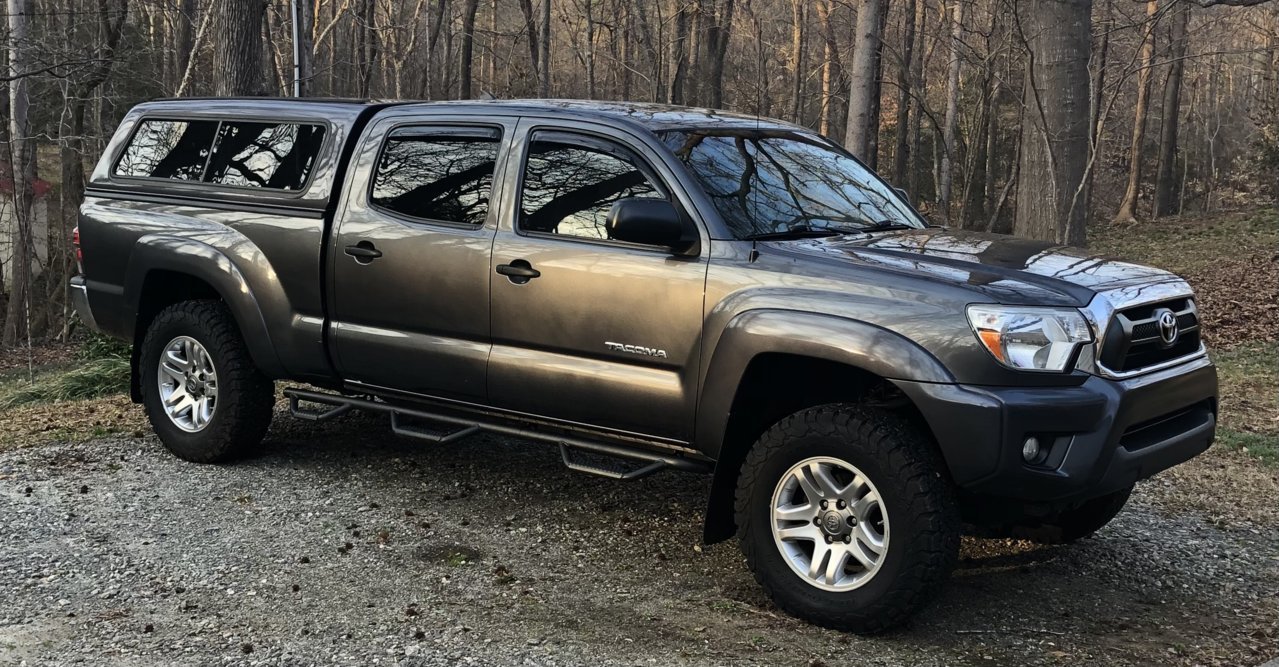

    Here's my Tacoma.
    315/70/16
    TE37X Progressive
    16x8 -20

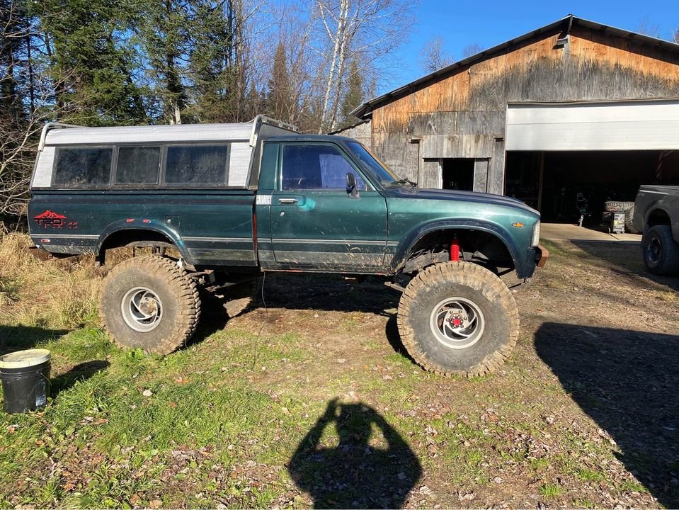

    I put 1st Gen Tundra 17" rims on mine.

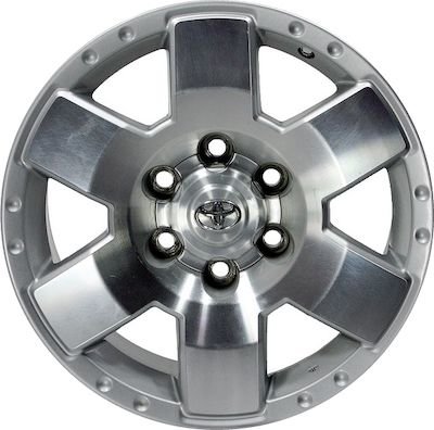

    It would be helpful for someone to update the first post with the FJ Cruiser OEM wheels that work nicely with our trucks.
    I am currently running this wheel with 245/75 R16 and they look great on factory suspension. Fits the wheel well perfectly in my opinion.
    16x7 Alloy TRD 15mm offset/ 4.59 backspacing
    I just picked up a set of the next wheels to give me more tire choices.
    17x7.5 Alloy 15mm offset/4.84 backspacing
    Hopefully this is helpful.

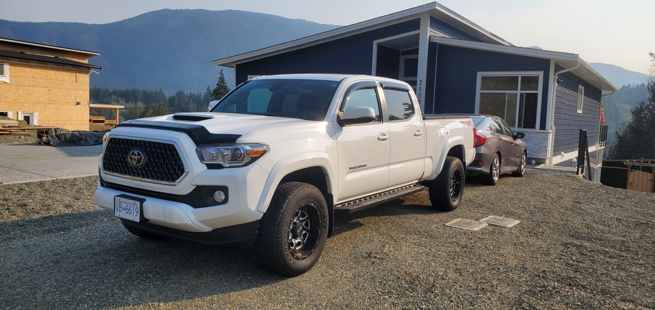

    I am driving a 2019 TRD sport Tacoma I came across some 04 4runner limited OEM 5 spokes 17" diameter 7.5"width ET30. I love the look of them I wanna use them for my winter set up { 265/65R17 Nokian Hawkapellitta 10} all the research iv done suggests that they are the same as the stock 3rd gen sport wheels. am i correct to assume that they will fit with no issues ... seems awfully close to the UCA.. currently runnin 265/65R17 Open Country AT on KMC wheels offset unknown. but they poke out passed my fender flares
  15. Sep 13, 2023 at 3:34 PM
    #575
    Discount Tire
    Discount Tire Tire & Wheel Specialists Vendor
    Sep 18, 2008
    #9321
    3,933
    Arizona, USA
    @Van_island your factory wheels should be a positive 25 so a +30 would be a solid fit. Your KMC's are probably a 0 to -12 offset if they poke.

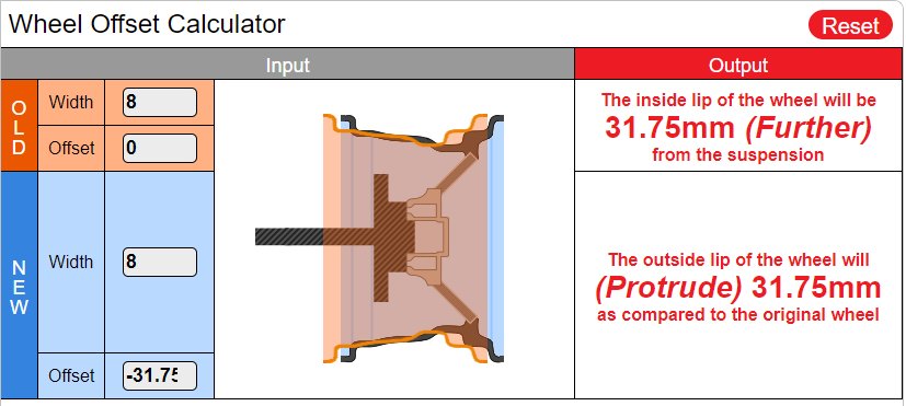

    Took them to a tire shop. They confirmed the 0 offset on my current wheels Love the look of them, if my math is right wich it probably is not. Running a 1.25" spacer should push a +30mm wheel out to a -5mm offset correct??

    @Van_island technically 1.25 inches equals 31.75mm. If zero is the starting offset, poke equals negative offset. So 31.75mm poke would be a -31.75 offset.

    A +30mm offset wheel. With a 1.25" spacer. Is not -30.75mm

    @Van_island I misunderstood. You are talking about the +30 wheel. I do apologize. A +30 with a 1.25inch spacer would make it technically -1.75 offset.
