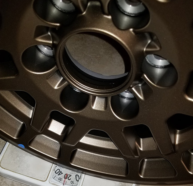

    Toyo Open Country 265 75 r16 tires FN Countersteer Type X, 16x8, 0 offset Front clip PPF, ceramic coated.
    In case anyone is interested, I weighed my spare OEM trail edition wheel, using my old crappy scale.
    Weight is roughly 23 to 24 lbs from what I can tell.

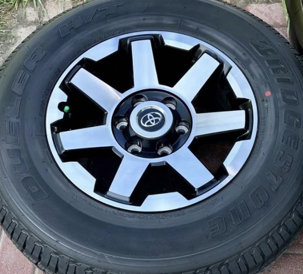

    I didn’t feel like searching 30 pages on my phone. These weren’t on here, I have the specs and wheels, just curious what their name is. I always search and have trouble.

    17" TOYOTA 4runner TRD offroad OEM FACTORY. Is this what you where looking for?

    Yes sir. Thank you.
    17"x7.5" 4.5" backspace +15mm offset

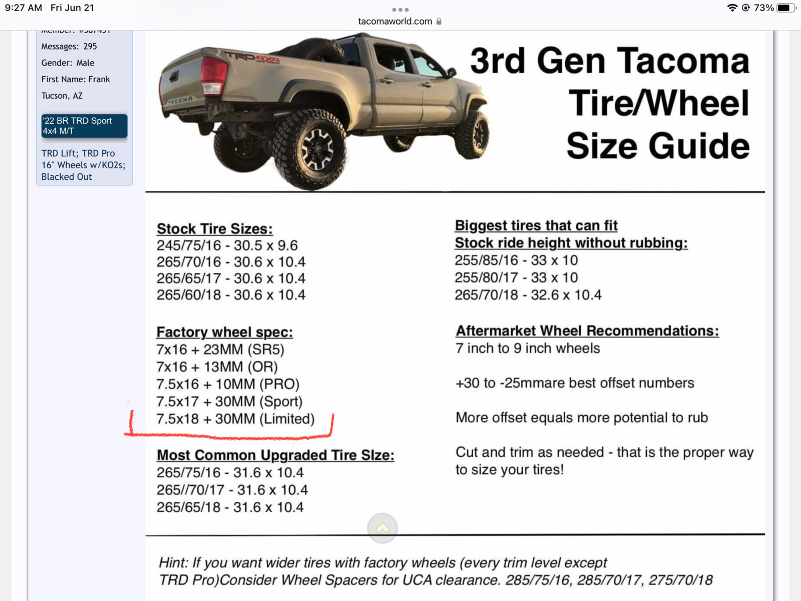

    Just want to point out some information on the 18 inch Limited wheels that seems to be incorrect.
    I read, and have been corrected multiple times, that the Limited wheel is a +30 offset. This is incorrect. I have a 2019 Limited 4x4 and the spokes on the back of the wheel are clearly cast with “ 18Jx7.5 25mm”
    This chart is wrong, at least for my 2019 Limited. I will gladly post up a picture of the casting of my wheels if anyone wants to see.

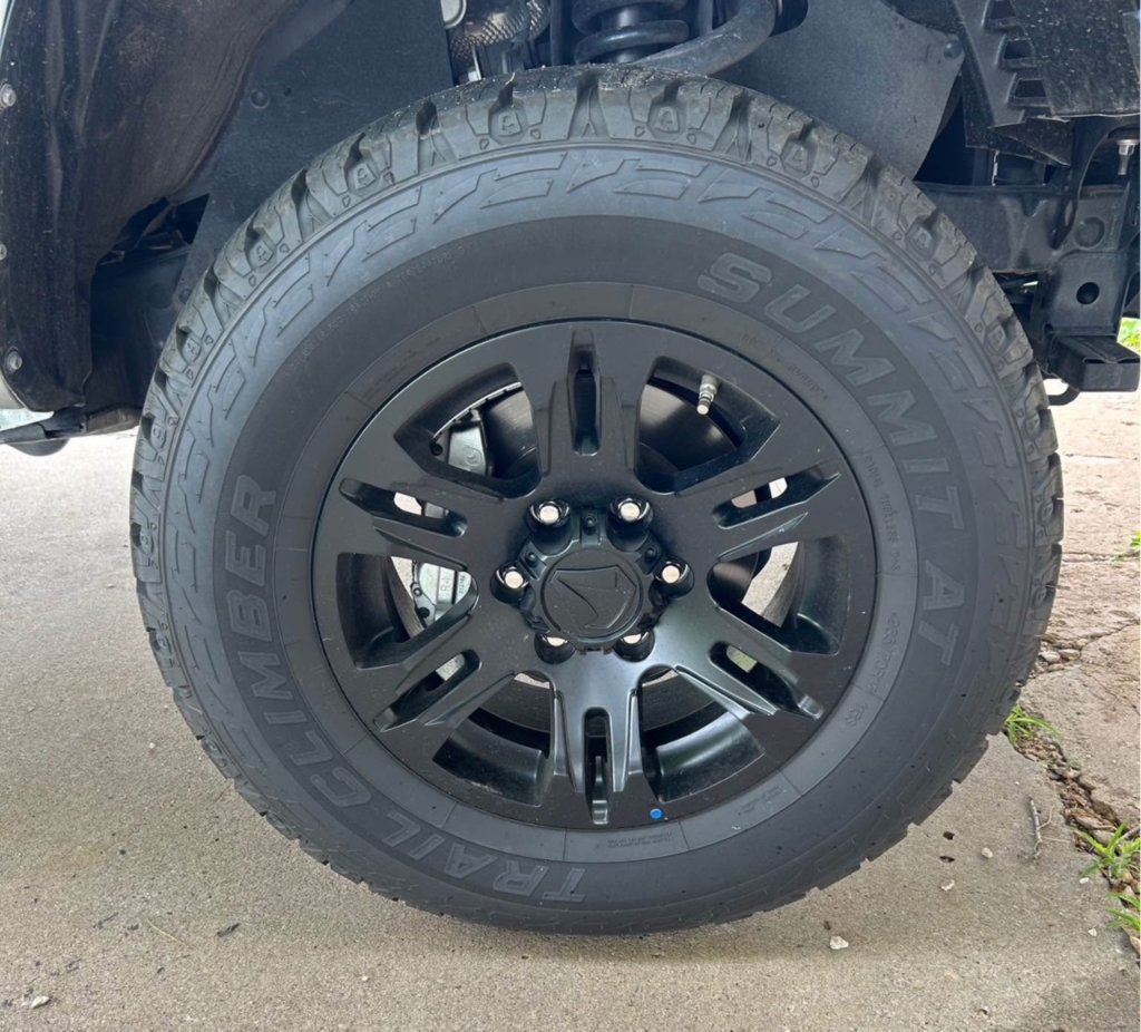

    This is a '23 SR with the TSS (dealer added accessories) package. I've never seen rims like this, but they added the T-Force hub caps (Just the snap in type...there was no allen bolt on the cap). I'm thinking of replacing the caps with the TRD caps or even generic caps and adding my own resin sticker to them, but not sure if the new caps will fit right or even look good if they do.
    Does anyone know if these caps will fit these rims? Any thoughts or suggestions?
