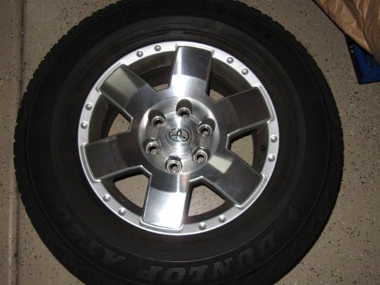

    #112
    kryten
    kryten Well-Known Member
    Jun 23, 2009
    #18813
    1,750
    Canada
    07 TRD Sport DCSB 6MT 4x4
    1" lift from 3rd gen suspension, 265/75/16 ATs
    Does anyone know backspacing, offset and weight on 17" FJ alloys. Considering buying a set for winter and would like to know how would they compare to 17" TRD Sport wheels. Will they stick out more etc?
    Also can I use the same TPMS sensors from my old 17" TRD Sport wheels and put them into these FJ wheels?
    These are the ones I mean. Thanks.
    34587d1266736362-fj-cruiser-17-alloy-whe_811c161833401339fb0454bd72923dc801e25e32.jpg
  13. Oct 10, 2012 at 11:43 AM
    #113
    TexasTacoma37
    TexasTacoma37 Well-Known Member
    Sep 3, 2009
    #22227
    31,174
    According to my google research, the FJ wheels are 17x7.5 with +15 offset, which equates to approx 4.75" BS.
    That would mean they would stick out 3/4" more than your trd sport alloys, which are 17x7.5 with 5.5" backspacing.
    The tpms sensors will switch over with no problems.
    SR-71A likes this.
