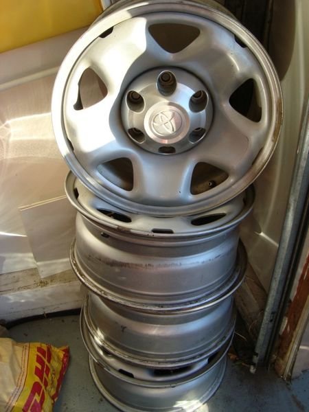

    Are these 15" or 16" wheels? I thought this style of steel wheel was 16". They are listed as 15", but I also thought 6 lug Tacomas come only with 16", 17" or 18" wheels and not 15". Thanks.

    16x7

    Perfect, thanks.
