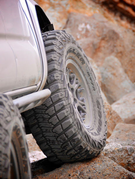

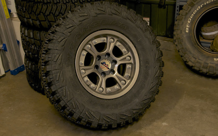

    See build page
    Hutchinson Rock Monster
    Hutchinson P/N WA-0567
    Size: 17 x 8.5"
    Bolt pattern: 6H - 139.7 mm BCD
    Lug style: M12 shank nut (hub piloted)
    Hub bore diameter: 4.18" (106.2 mm)
    SAE rated load: 2,750 lbs. - 60 psi
    Backspacing: 4.51" (114.3 mm)
    Construction: Cast aluminum alloy
    Weight: A lot
