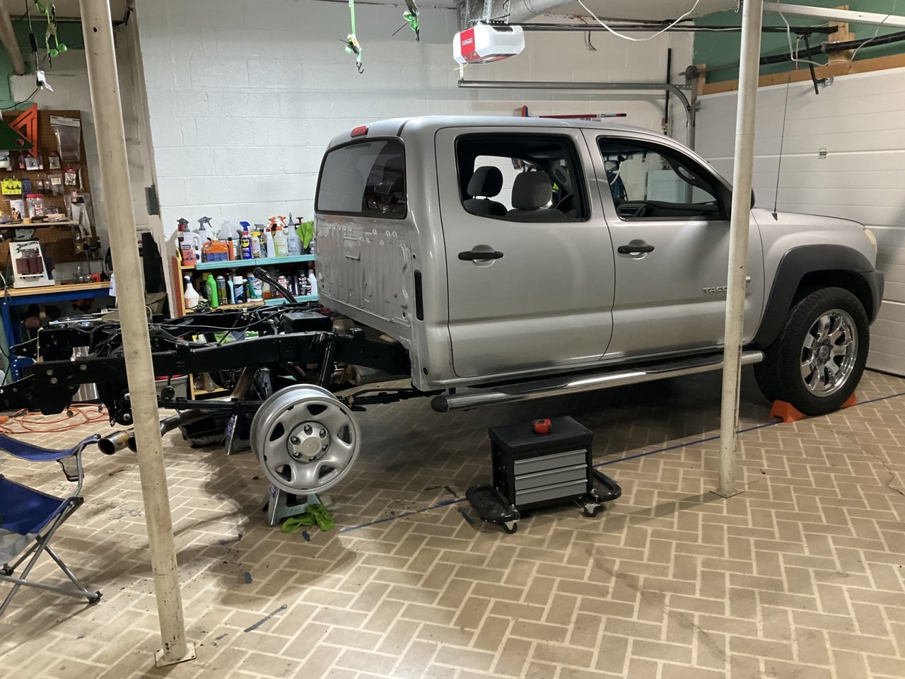

    Just became a member of this club.
    I had other plans today.

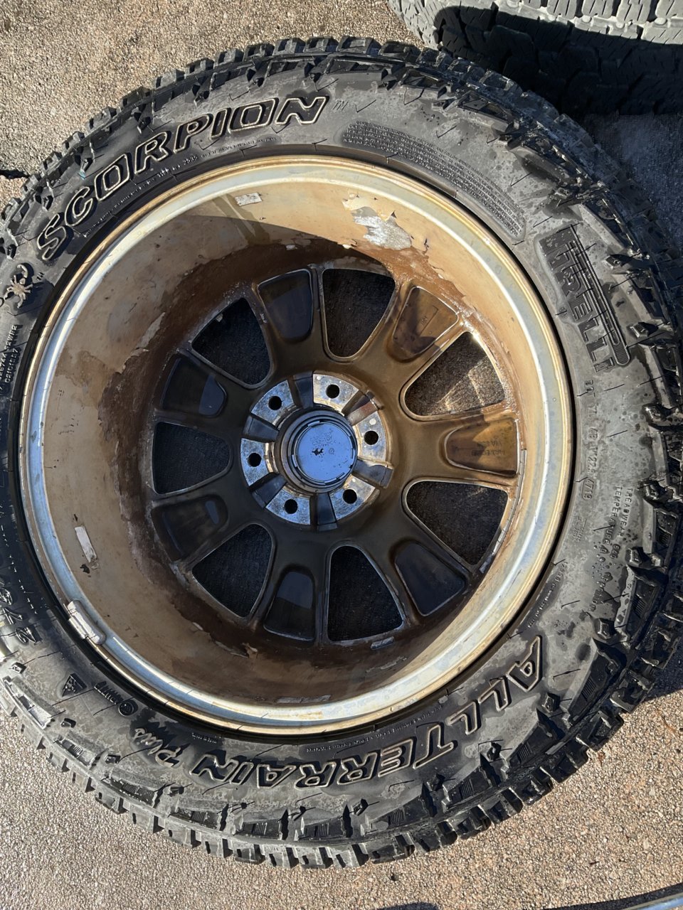

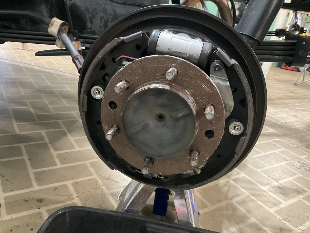

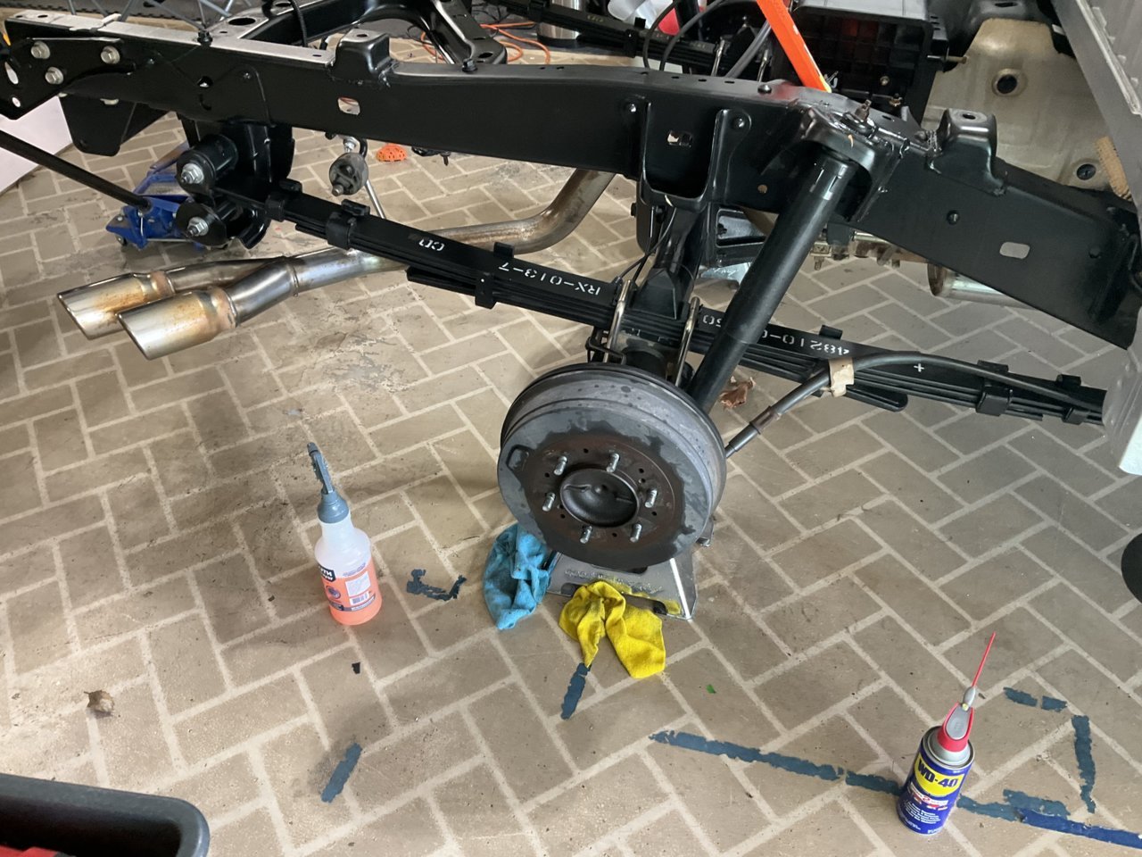

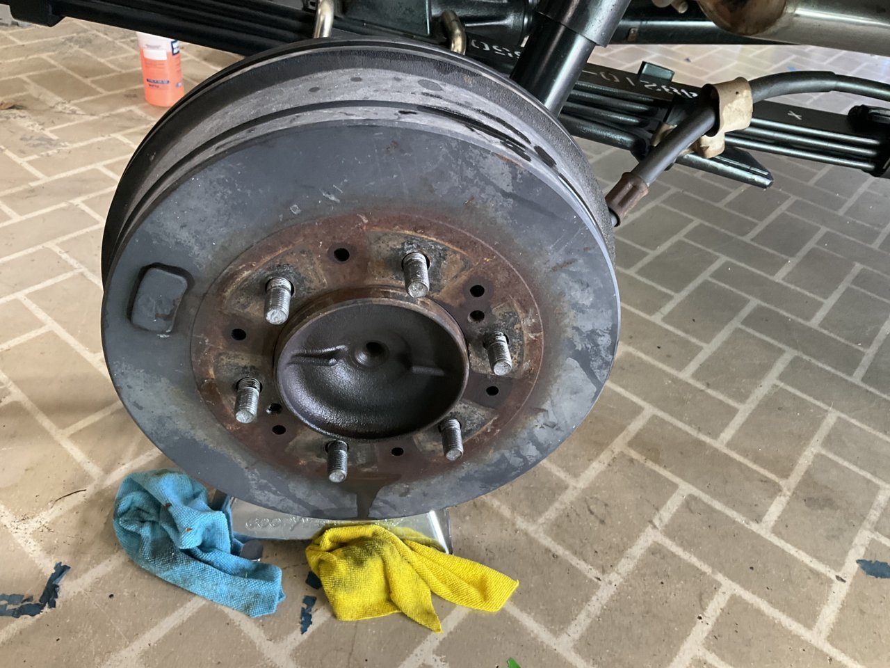

    5 hours later the wd40 and PB blaster take affect.
    not a fan of these wheels. They are rusting on the inside…metal layer is peeling off.

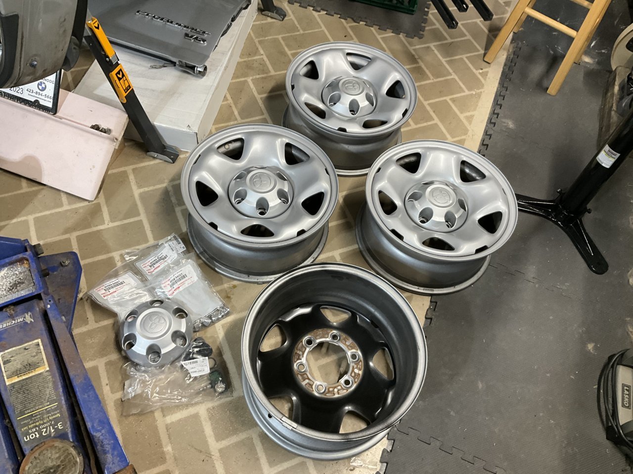

    112

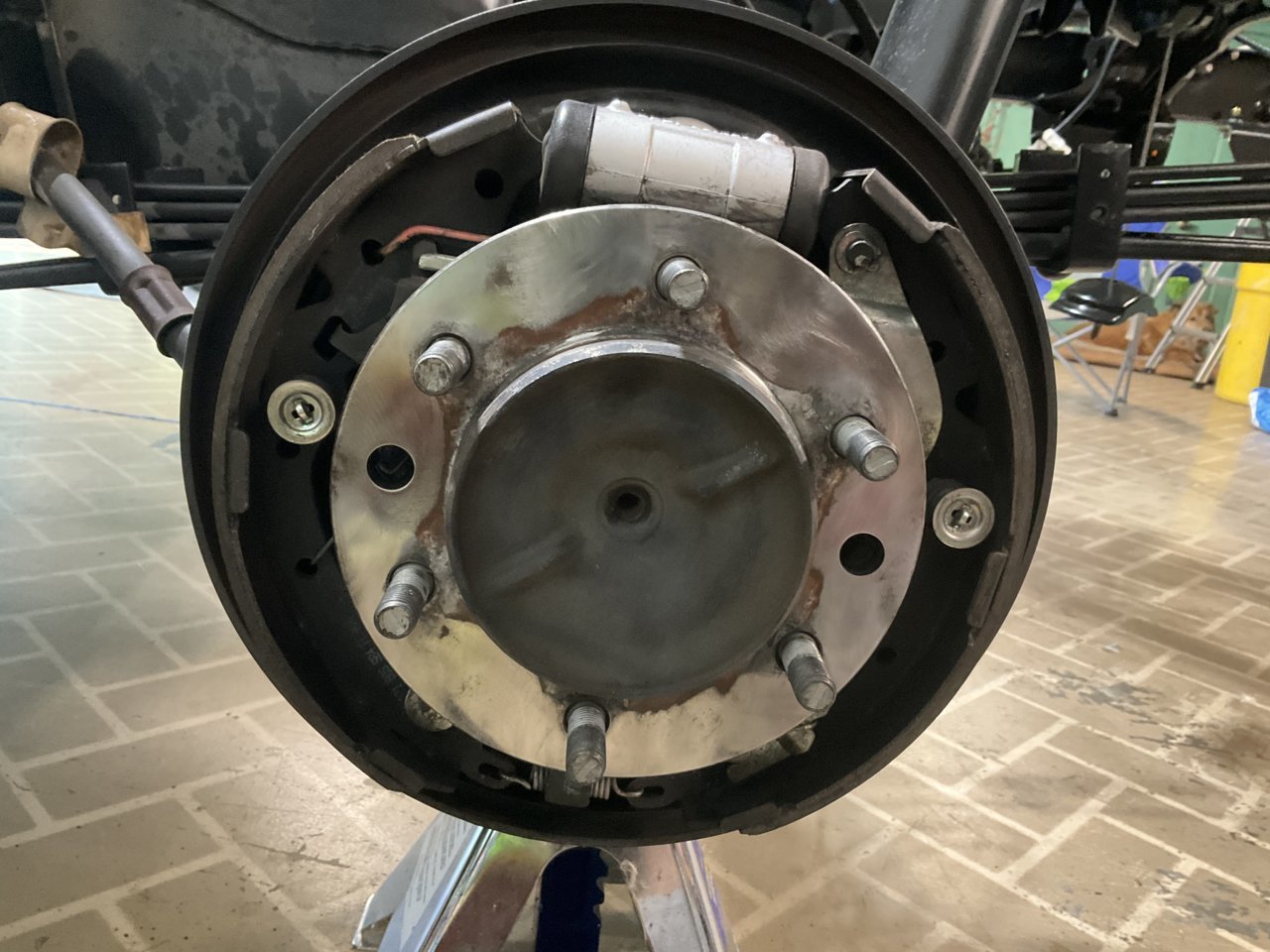

    cleaned up the drum..had it resurfaced. Those 20” wheels are not going back on.
    Scored some new 16” take off wheels with new lug nuts and sensors for $200.
