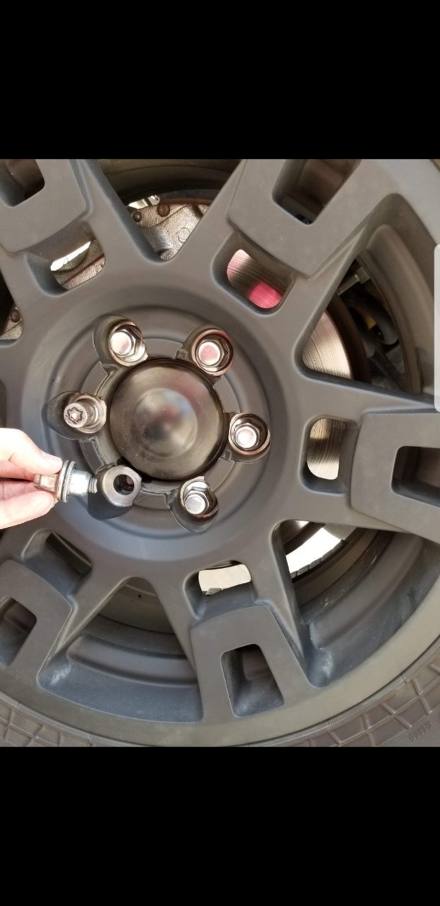

    Yep, same thing happened to me a little over a year ago. I've always rotated on my own, torque wrench every time, dozens of cars now. But on this day the "click" at the preset 85 ft lbs never came. Never having experienced this before I kept turning it expecting it to tighten, then I felt the metal go soft and it popped right off.
    Originally I replaced just that one. Several months later felt another one turning too far without clicking. Replaced them all after that. Haven't had an issue since then.

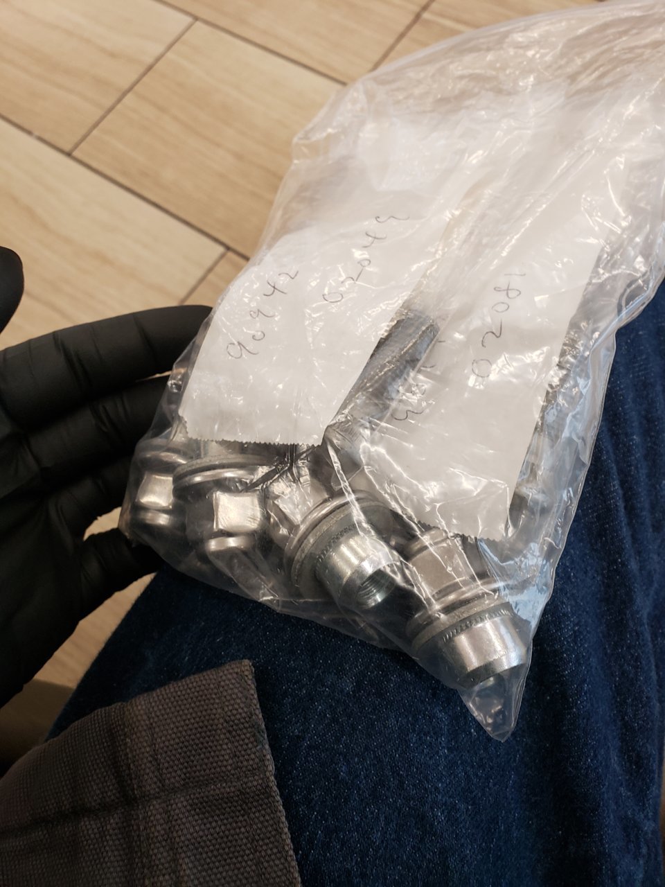

    So im at Toyota came here and got denyed because of pyshical damage.... Then go down the road to only be called back that they can fix it..... theres a reason why I bought beaters all my life I fucking hate stealerships. Bought these thinking I then had to do it my self guess I'll keep em in emergency.

    Are those OEM?
    I’d want super deluxe on all four corners.

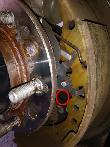

    If the 3rd gen drum brake is similar to 2nd gen, then there should be 1-2 spots with enough room to fit a wheel stud without much disassembly:

    The studs are soft for sure. I had one break off on the rear on mine around 30k miles. I just replaced them all since it is stupid easy to do on the rear.
    I forget if it's a 6 or 8mm bolt needed to get the drum off, but pop off the drum, rotate wheel bolts until hole is lined up and whack them out. Re-installation is even easier.
