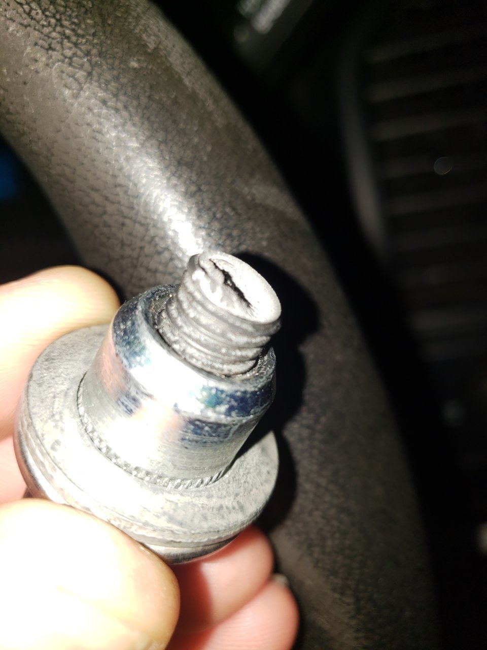

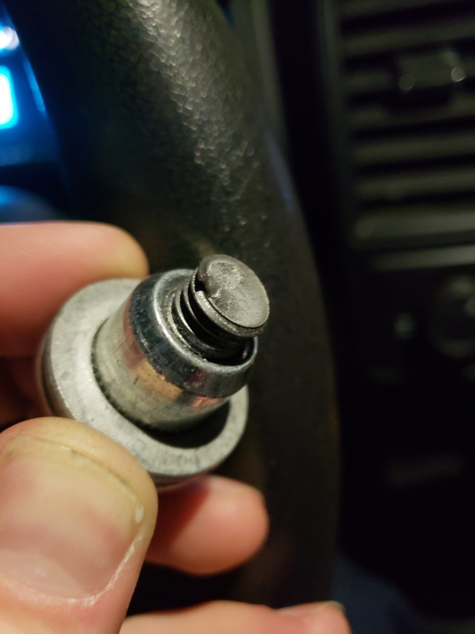

    It is hard to tell, but I don't see any necking. I dont see any obvious fatigue features (they could be there, but I dont see them). Some cup and cone features are there, but not totally apparent.
    Most of what I see looks like tension failure, not much indicative of torsion failure (brittle or ductile).
    Based purely on what i can see in the pictures, I am going with single tension overload of a moderately ductile metal. (Surely not pure brittle, but must be pretty hard material). Definitely a (hard) heat-treated or hardened material.
    I am going to say either excessive torque, or reasonable torque with unexpectedly reduced friction (lubed threads). Not ruling out a metallurgy issue, but I bet not.
    My 2 cents, worth exactly nothing...

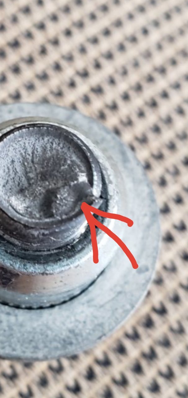

    The dark corner on the left looks like is where there was an imperfection (crack). It was there for a bit and the brighter bit on the right happened at the end. No shinny, shinny stuff, so it didn't rub.
    As far as torqueing, I won't argue that torqueing to a specific spec is better, but it's definitely not a super precise measurement that it has to be. In reality, it's a range that you don't want to over torque past. The Toyota spec isn't going to be right at the edge. Otherwise, they'd have to get you a tool to change your tire with. Besides that torque wrenches aren't all that precise anyway. They are just a tool to get "close" to the amount of bolt stretch needed for a mechanical joint. If not using an impact, I'm probably under the spec as I never use a torque wrench and I don't hammer down on the tightness of the bolt. I go maybe a half a turn past snug. If it tightens up really fast, I stop.
    I only say that because I kind of get the impression that many place too much emphasis on torqueing to an exact number or it'll fail. There is a point you don't want to torque past, but it isn't going to be the 83 ft-lbs or whatever the spec is.
    For the OP, probably the use of a breaker bar and just over torqueing the bolt caused this. You really don't have to put your ass into it when tightening bolts (unless you have a 2 1/4 bolt or bigger and no hydraulic wrench). It probably started awhile back and just now failed.

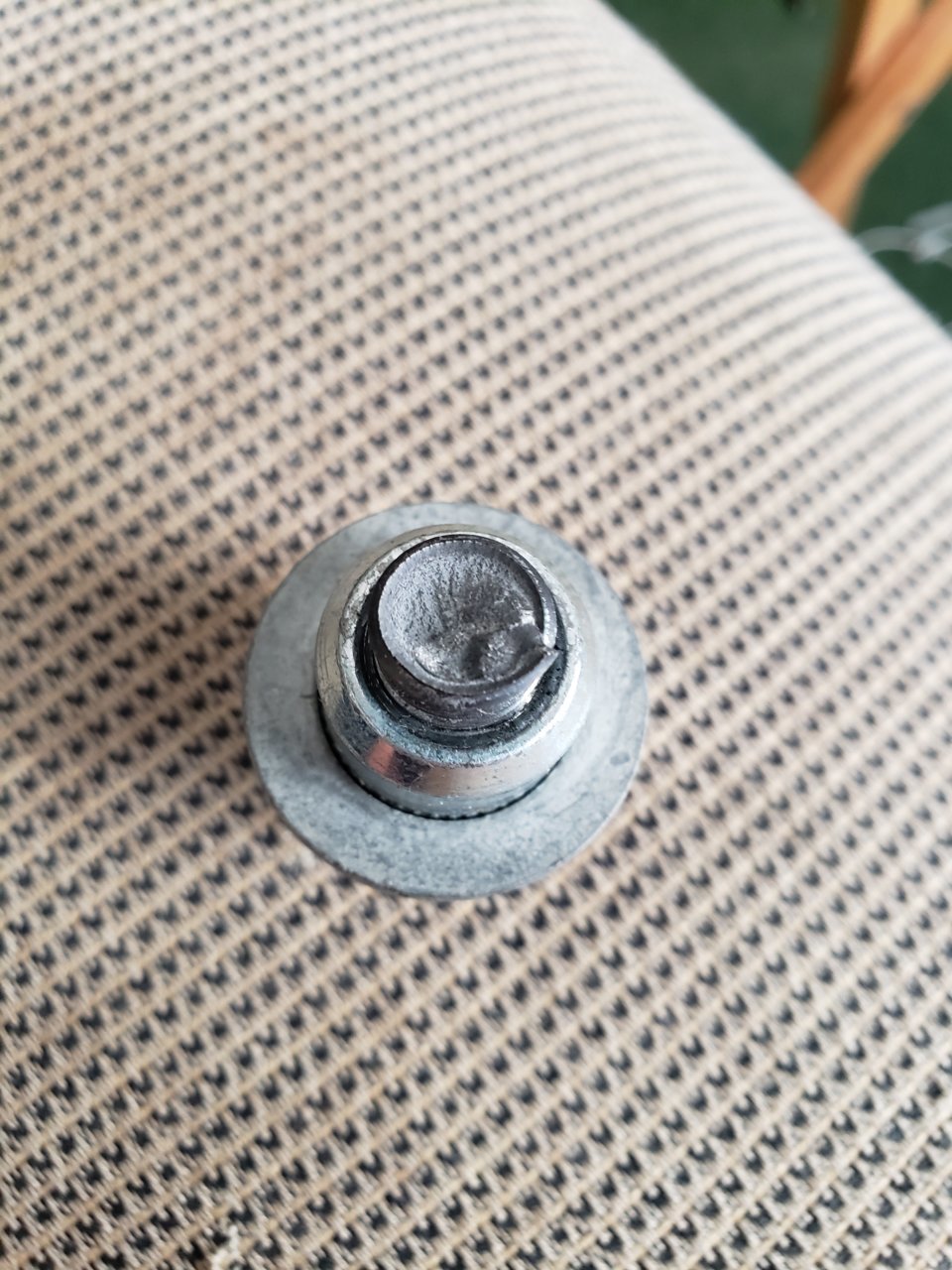

    I saw it, but just not convinced on the corner you mentioned, but hard to say without a bunch of pictures or seeing it in person.

    See that dark little curved line in the lower right of this picture? It kind of spreads out with the thickness. It's a bit darker than the rest. That's probably where the crack started.

    Possibly, I havent seen enough bolts broke thru the actual thread to know what that will do visually. (I am used to tension failure at the thread run-out, adjacent to full shank).
    One thing can see for sure is a very 'pretty' shear cone on the perimeter.
    I do feel comfortable saying there was a large tension load on the bolt when it ruptured, and i dont think there was much plastic deformation before it broke.
    Looks like that thing was heat treated or work hardened during manufacture towards the upper end of strength capability of the steel. Don't know what steel it was (and if it was wrong), but I would say it didnt accidentally miss heat-treat or anything like that...

    You probably know this stuff better than me, but that little dark line right at the threads makes me think it started there. If you look close, it kind of feathers towards the center. Since threads are where stress was applied to make the thread, that would be a stress point anyways more so if it was a cut thread.
