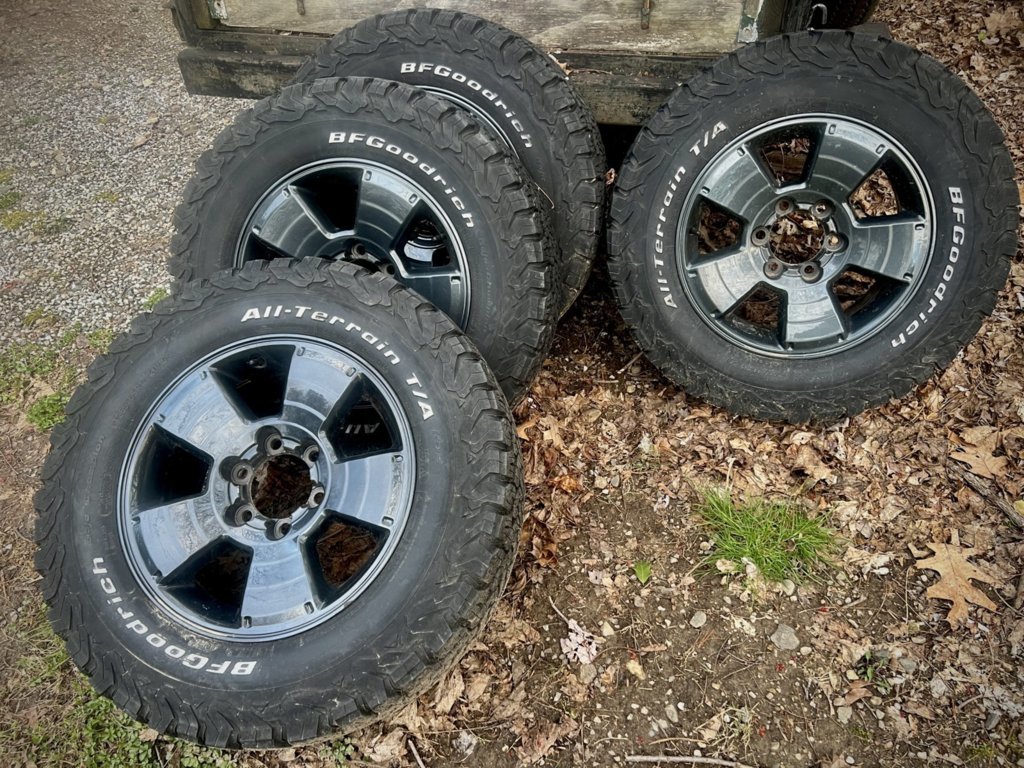

    Here is a pic of the new wheels for reference. I believe they are the stock TRD 2nd Gen Sport Wheel (or maybe a 4th Gen 4Runner wheel). I have the stock TRD 2nd Gen Off-Road Wheel (Part# 42611-AD031). It is my understanding that these wheels have the same offset and should be basically interchangeable.

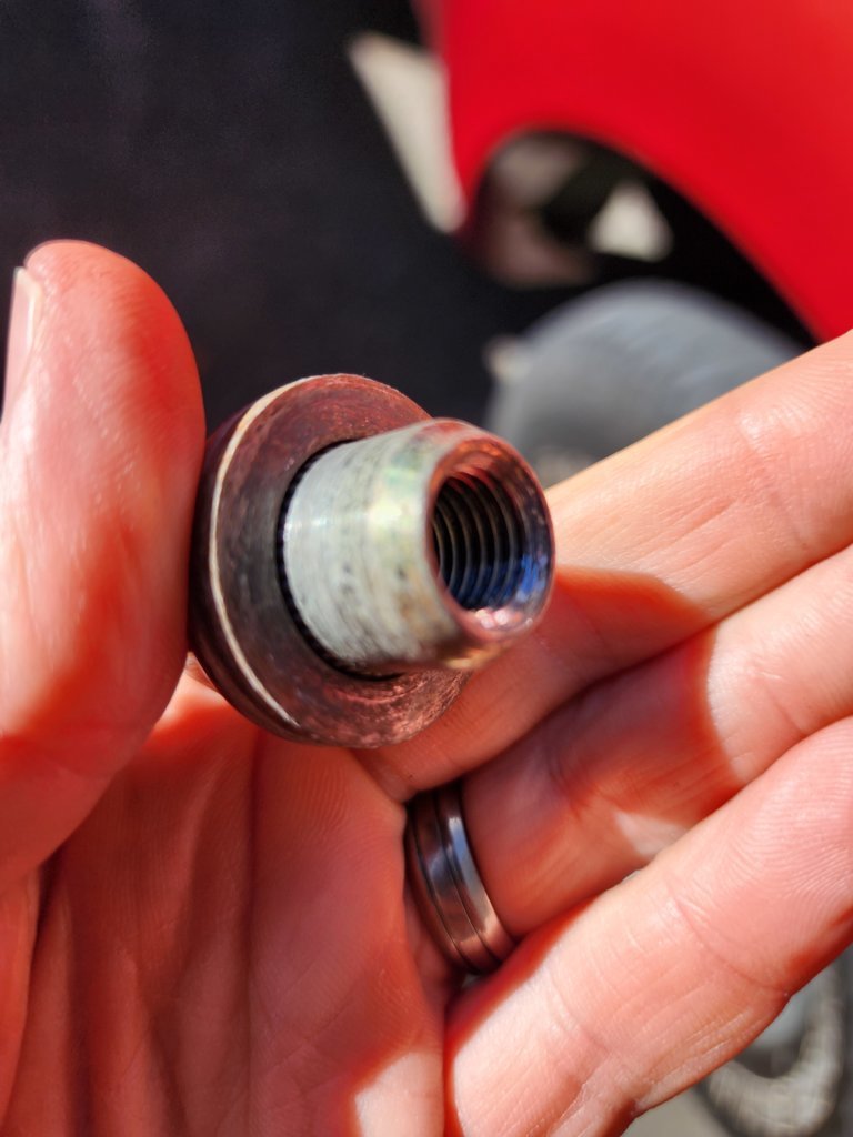

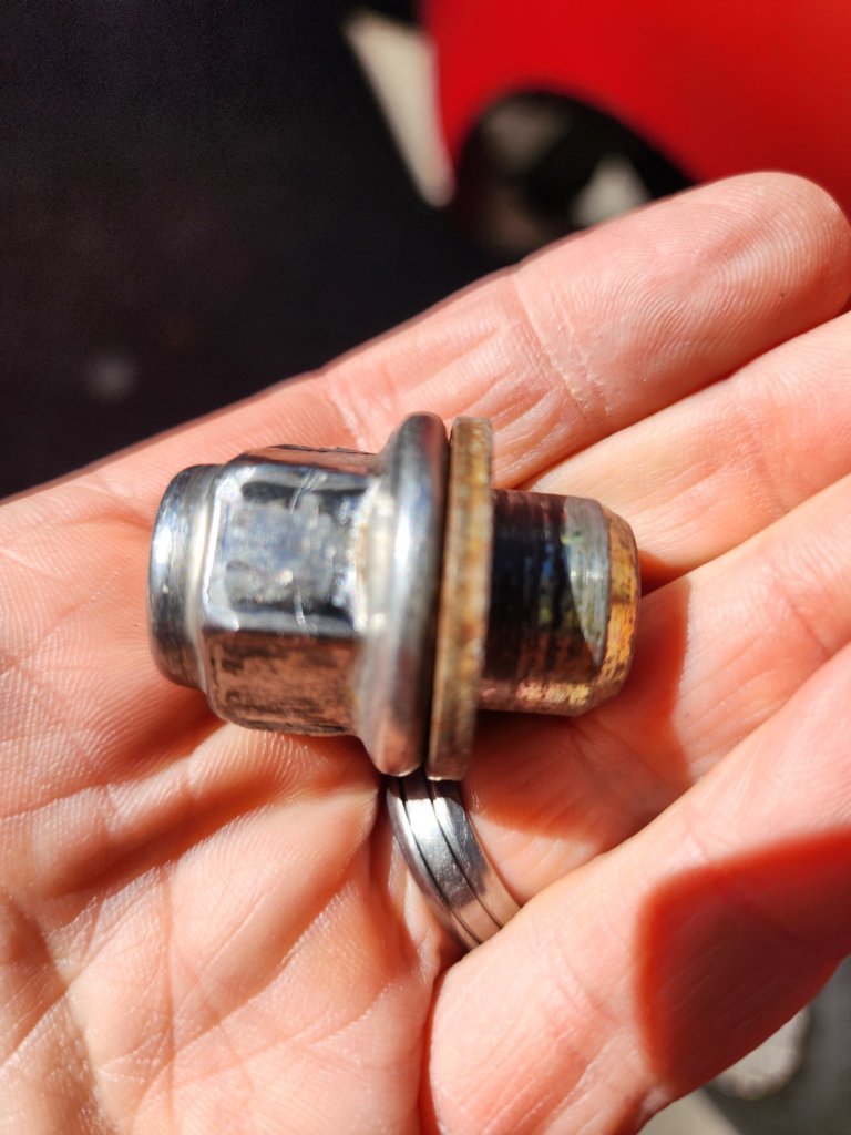

    Pulled the lug nuts off my current OR wheels - see pics below. They look like the right ones. The shank from these also fits into the new wheels. Took a good 10-15 turns to get them off my wheels, so they are seated right. Not sure what the problem could be:annoyed:

    Since these are an M12x1.5 stud 10 turns means you're grabbing 15mm of stud and which in my book is OK. If you're really going 15 turns then you're more than good.

    Yep. They are super good on my current wheels. No idea why the other Sport Wheels won't fit with enough stud length. The new wheels are stamped 17x7.5JJ.

    Should be a perfect fit then with the new wheels. Don't know what the tire shops deal was, especially since they're second gen wheels anyway lol.
    If you have a jack, test fit one yourself to see if there are any possible issues.

    If you're still not comfortable with it maybe just measure the thickness of the current wheel where the lug goes through it and the thickness of the new one in the same area. I feel like this is something being made of nothing.

    1:1 is the rule so 12mm (8 turns) on an M12x1.50 stud is good to go.
