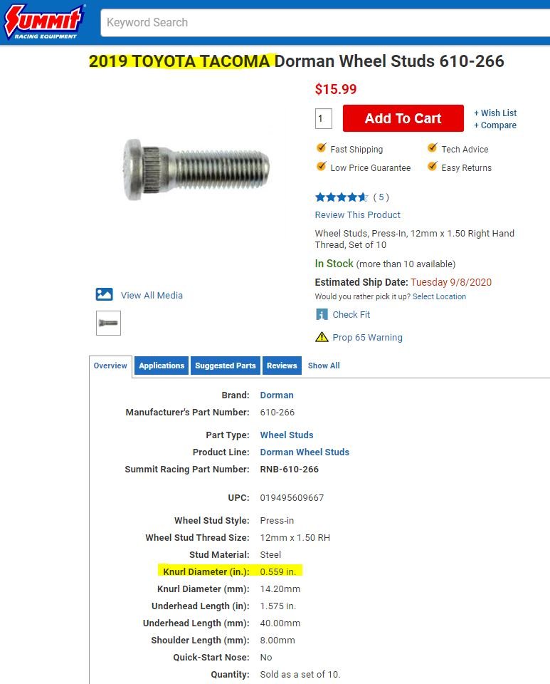

    I need longer studs on my 2020, anyone know the knurled dia. of the stock studs? Summit Racing has some longer ones that fit a Lexus with a knurled dia. of .558” I haven’t tore into mine yet as it’s the daily driver. Anybody know this weird spec?

    i believe they are .561 knurled dia.

    no i don't think so as those have a .559 knurled dia.
