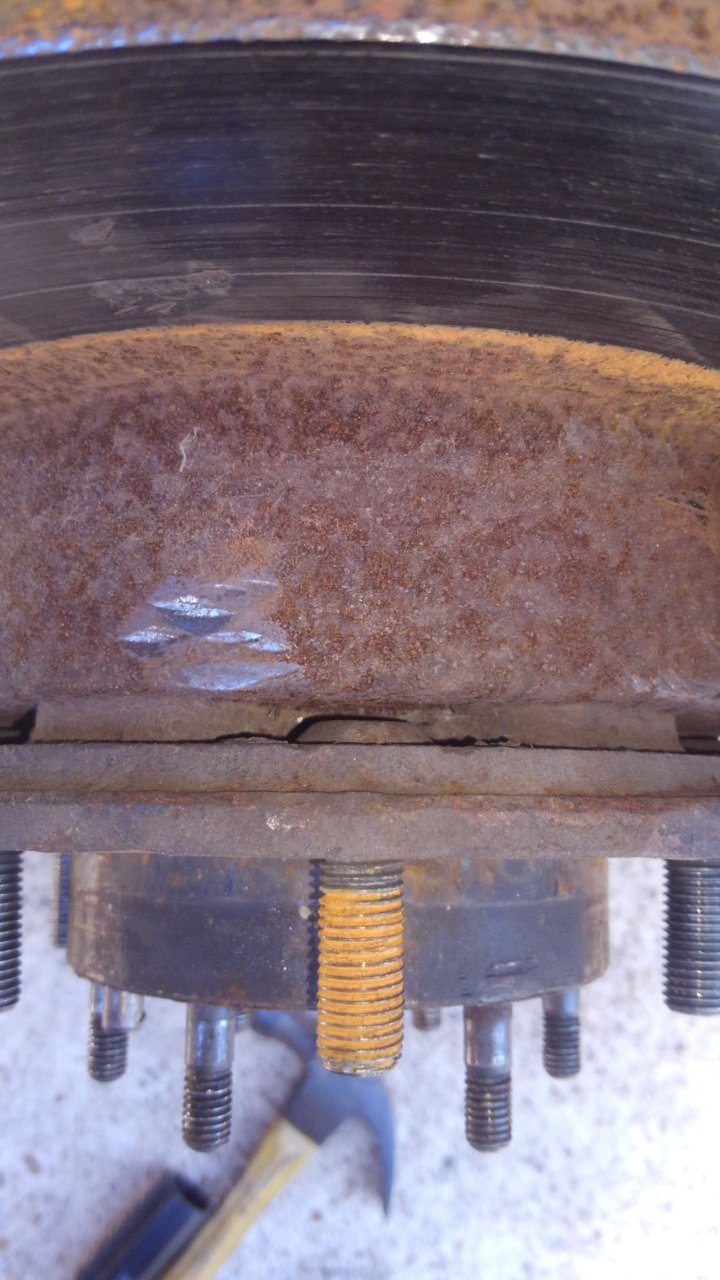

    '97 T100 4wd, stripped a wheel stud on driver's side, how the heck do you remove the stud when ther is something behind it???? Looks like a whole piece! Is this serviceable??? Any suggestions???

    Figured it out, pull caliper off, pull out hub with rotor that's bolted from back end :anonymous: banged out hub cause it was rusted to rotor, used a wire wheel to clean off hub that with light rust that way hub slides easy to rotor, any ways hammered out stud n put new one on, everything back in order, thanks for replying
