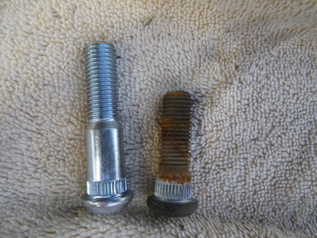

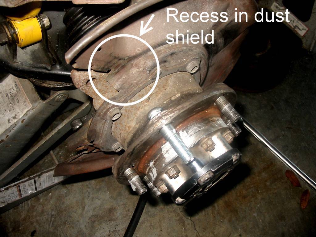

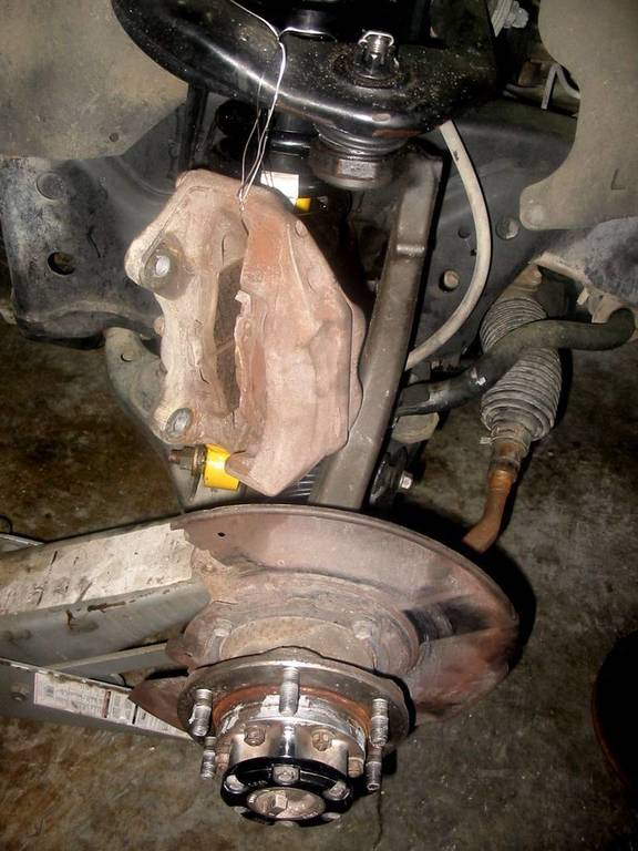

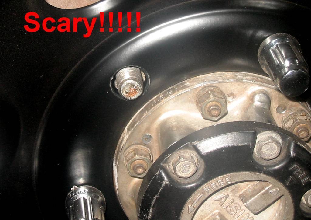

    Okay, my studs came in yesterday and I knocked this out this morning. Here's how it went:
    Here's what I started with. I'm running Procomp Series 97 15x8 wheels with 3.75" BS. I had to get .25" wheel spacers from Wheeler's for these wheels to clear the brake caliper. In retrospect, I should have gotten the wheels from Wheeler's as well, but I wanted 3.75" BS and Wheeler's only had 4" BS in 15x8s. These probably would have been fine, but I wanted to run 33x13.50 R15 Super Swamper LTBs and I thought I would need the extra BS to clear the UCA. Anyway, on with the mod...

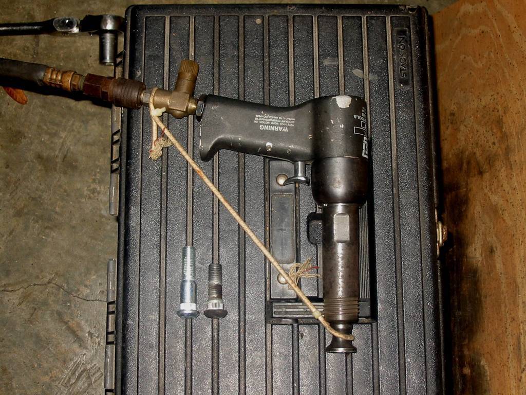

    So after removing the tire, I removed the brake caliper and hung it from the UCA with a piece of .032 safety wire. Then I removed the brake rotor.
    To get the old wheel studs out, I used a rivet gun/air hammer with a flush set milled flat. Here you see the difference in length. It's actually more than the .5" everyone has been saying. The new stud is 15mm longer. That's a little bit over 9/16", roughly 19/32". This length is in the shank area, so if you aren't running wheel spacers or thick wheels, be careful that you can tighten the lug nuts down all the way, especially if your spare isn't on the same type of wheel as your regular tires are. On mine, the shank stuck through the wheel spacer, but the wheel was thick enough for this not to be a problem.

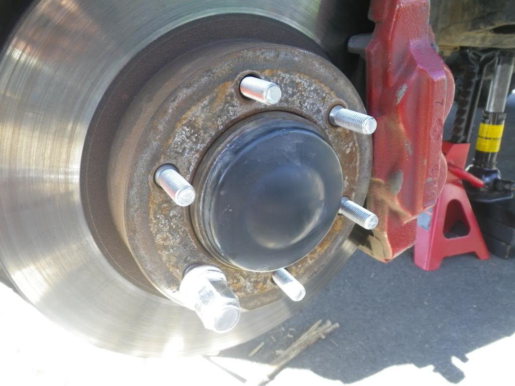

    Because of their length, the new wheel studs require a lot more room to install. Luckily, Toyota was kind enough to provide a spot to accommodate this on my 1st Gen. There is a dimple in about the 11 o'clock (driver's side. 1 o'clock on the passenger) position in the dust shield that allows ample clearance to slip the longer stud through. Not certain if it's there on a 2nd Gen.
    To press the stud in, a previous poster suggested using a ball joint press. This is probably healthier for the stud, I guess, but for me, it seemed like there was a bigger PITA getting all that junk aligned. I just used a couple of old nuts that were big enough to slip over the stud and an old lug nut. I tightened it down with my impact until the head of the stud pulled down against the hub flange. My impact was only rated at 75 or 80 ft-lbs @ 90psi when it was new. It's been badly abused so it's doubtful that it would even produce that these days. Anyway, factory torque calls out for 83 ft-lbs on the lug nuts, so I'm fairly confident the studs can take the stress of using the lug nuts to pull them in.

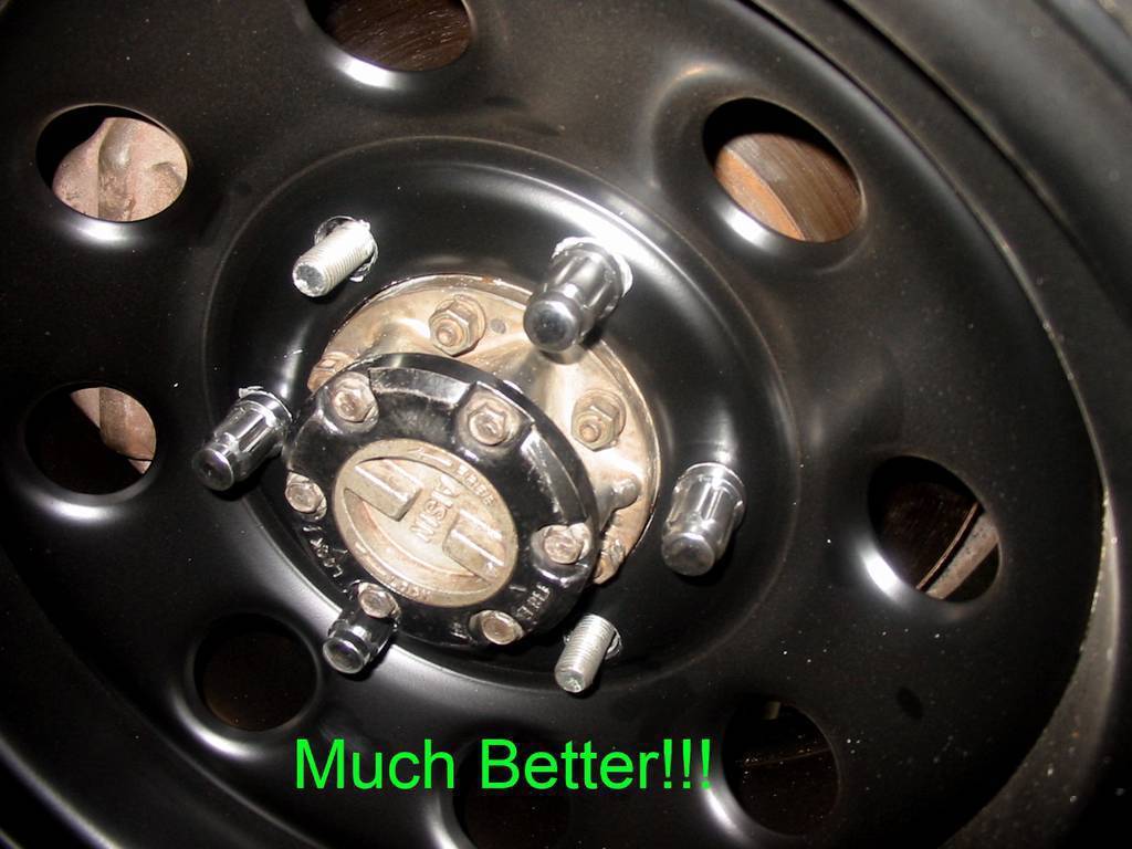

    And that's the finished product. Much safer. Be careful that your lug nuts don't bottom out before tightening the wheel down though. Mine are close, but I hand tightened one down on a new stud and it only had about 2 threads exposed when it bottomed out so they should be okay.
    Thanks again to the OP for providing us with this important fix!

    ++ on making sure your lugs don't bottom out on the stud before giving enough clamping pressure. Check your wheel lug wholes for signs of being rounded out or the stud from being grooved by the wheel. I lost a wheel @ 35mph because my wheel was shifting enough to wear grooves in the studs until they broke. Not on a Taco!
