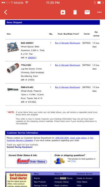

    Here's the order list I had with Summit. Hope the picture comes through. The wheel stud number is 610-463 from Summit. I think the guy who posted the first writeup was saying he got 641-4208 from Napa because they were cheaper, but no one even Napa by me had that number. You'll have to check around, but I can tell you the 610-463 worked perfectly and we're exactly the correct length for the 1/2" spacers, and both Summit and Orileys near me had them.

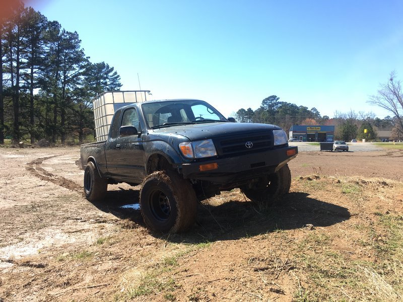

    01 tacoma 2.7 auto 2wd
    Does anyone know which part number if i need extended stud for 96.5 tacoma front wheels? I tried celica and corolla and none works
    Current set up 1" spacer but tires way too stick out i want just put 1/4" just to clear calipersIMG_0930.jpg

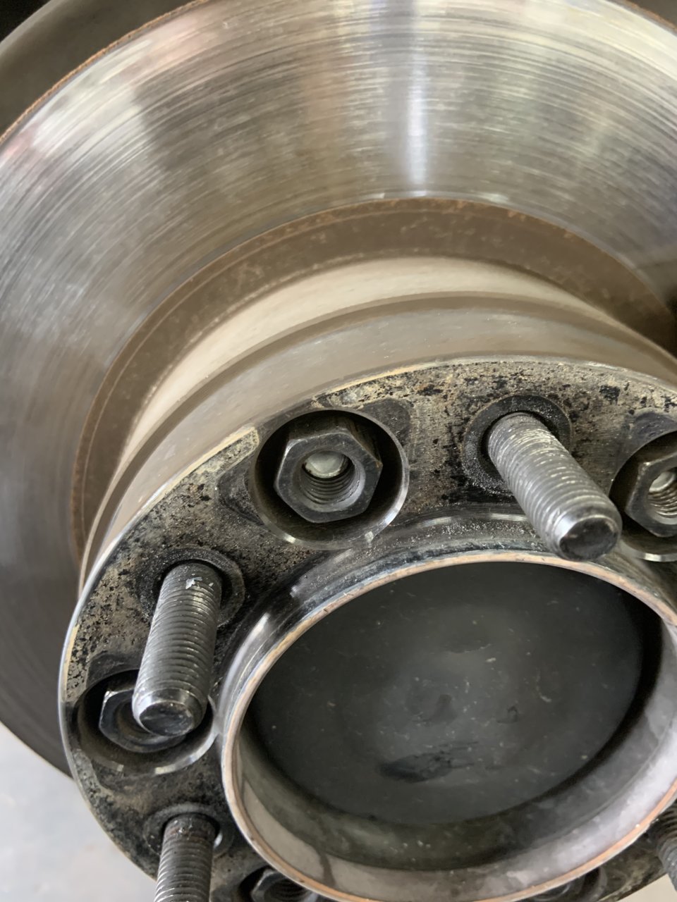

    Sorry to resurrect an old thread, My mechanic buddy is fixing my wife’s 02 4runner and sent me this pic and said he won’t touch the hubs because of the spacers. He said they both look barely threaded but I have been driving with these for 3 years with no issues. Should I be concerned? I bought the truck with them installed.

    You should 100% be very concerned. The nuts for the spacers are barely threaded onto the lugs. That is a disaster waiting to happen

    You need to check if they’re extended thread lug nuts. If they are they probably have threaded at least 6-8 turns. That’s about the same or more than the regular lug nuts. The threads still show like that.
    Like these -> SET Group USA 24pc 12x1.5... https://www.amazon.com/dp/B07NJ9D22Q?ref=ppx_pop_mob_ap_share
