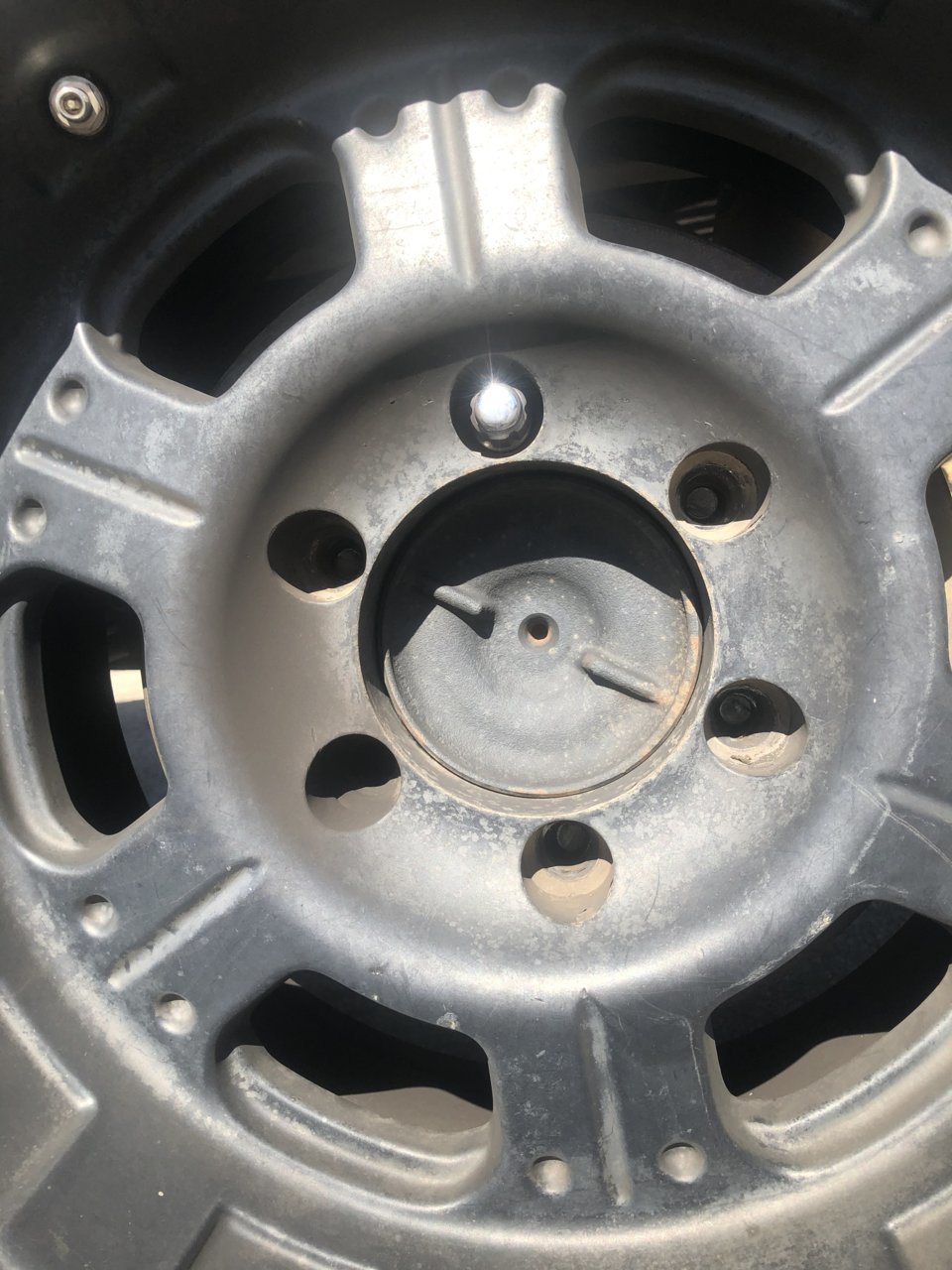

    so this happened. Today I am thankful for this one single lugnut and stud

    How does this happen?????

    Impact Wrench.

    Would be wise to visually check the studs on the other 3 wheels for cracks...
    Could also be tightened with hand tools to the wrong torque setting. I say that because the spline drive socket is often a thin-walled chrome socket, which in most shops indicate it isn't impact-rated.

    So did they break off while driving?

    At 70mph

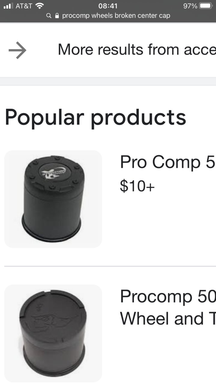

    When I got the truck I did find a smashed up one of these in the bed, none of the wheels have these center caps on them, could that be the problem?

    Are/were you using correct lug nuts?

    Center cap has no function other than decorative. Not the cause of the broken stud.

    The small procomp ones that are made for the wheels
