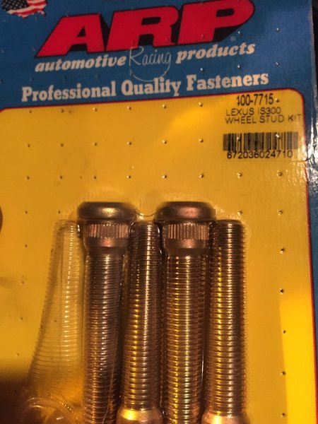

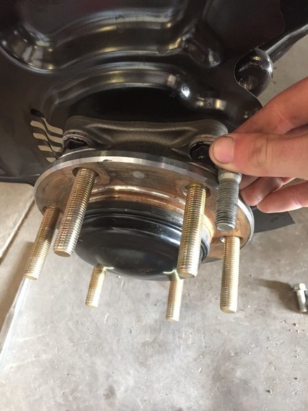

    I searched the 3rd gen forum and didn't see anyone talking about aftermarket wheel studs. I figured I'd share the information in case anyone finds it useful. I had to get longer studs to safely run a 1/4" spacer up front so my rims could clear my calipers. Or maybe you just want stronger wheel studs and in this case you can't get much stronger than ARP. The part number I used is 100-7715 it says it's for a Lexus IS300. Easiest way to install them in the front is to drill a 3/4" hole in the dust cover and slip them through that. For the rear you'll have to disassemble the entire brake system, pull the axle shaft, knock out the 4 studs holding on the dust cover and throw them in from there. Front took me 45 minutes and the back took me 2 hours. Hope this was helpful to at least one person!
