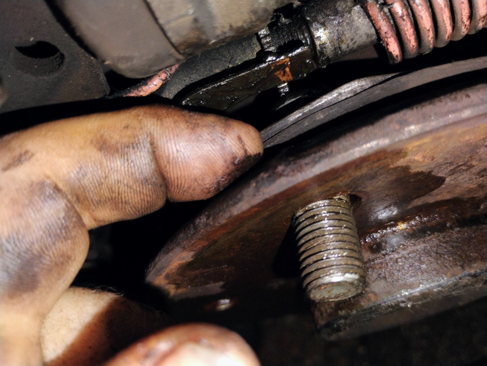

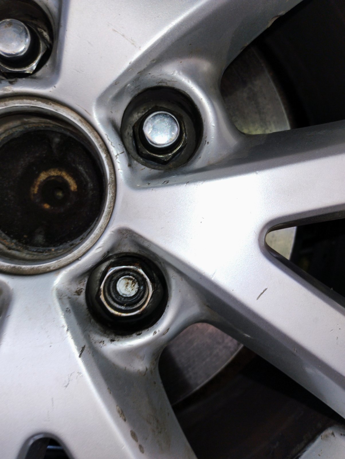

    Here is a pic of a open nut -very tight but not extreme .Im not too confident by it. I got about
    6 an a half turns..12 mm 1.5

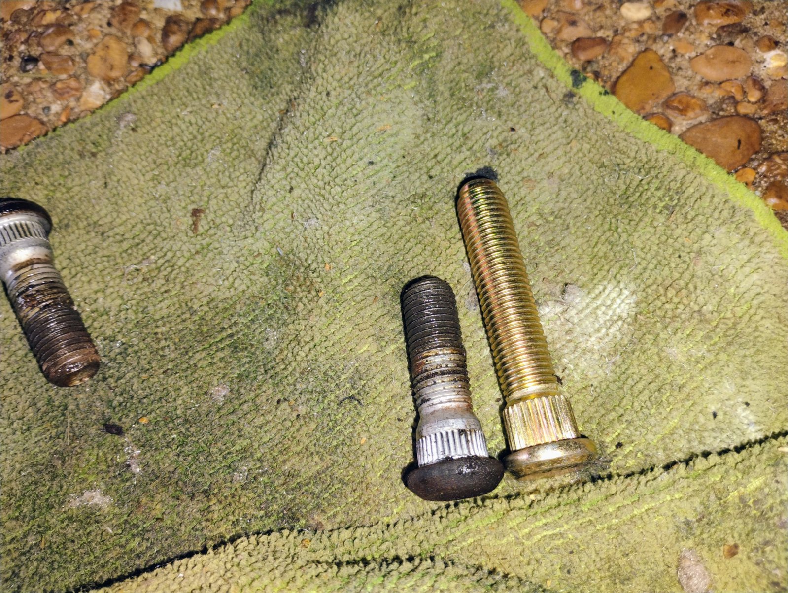

    I ordered some 50 mm
    Toyota Tacoma 50 mm Long Extended Wheel Lug Wheel Studs Wheel Bolts m 12 x 1.5 x 50 mm Year 1995-2023 1 Set (Pack of 10)
    Will the process be simple as to removal or will the dust shield be in the way

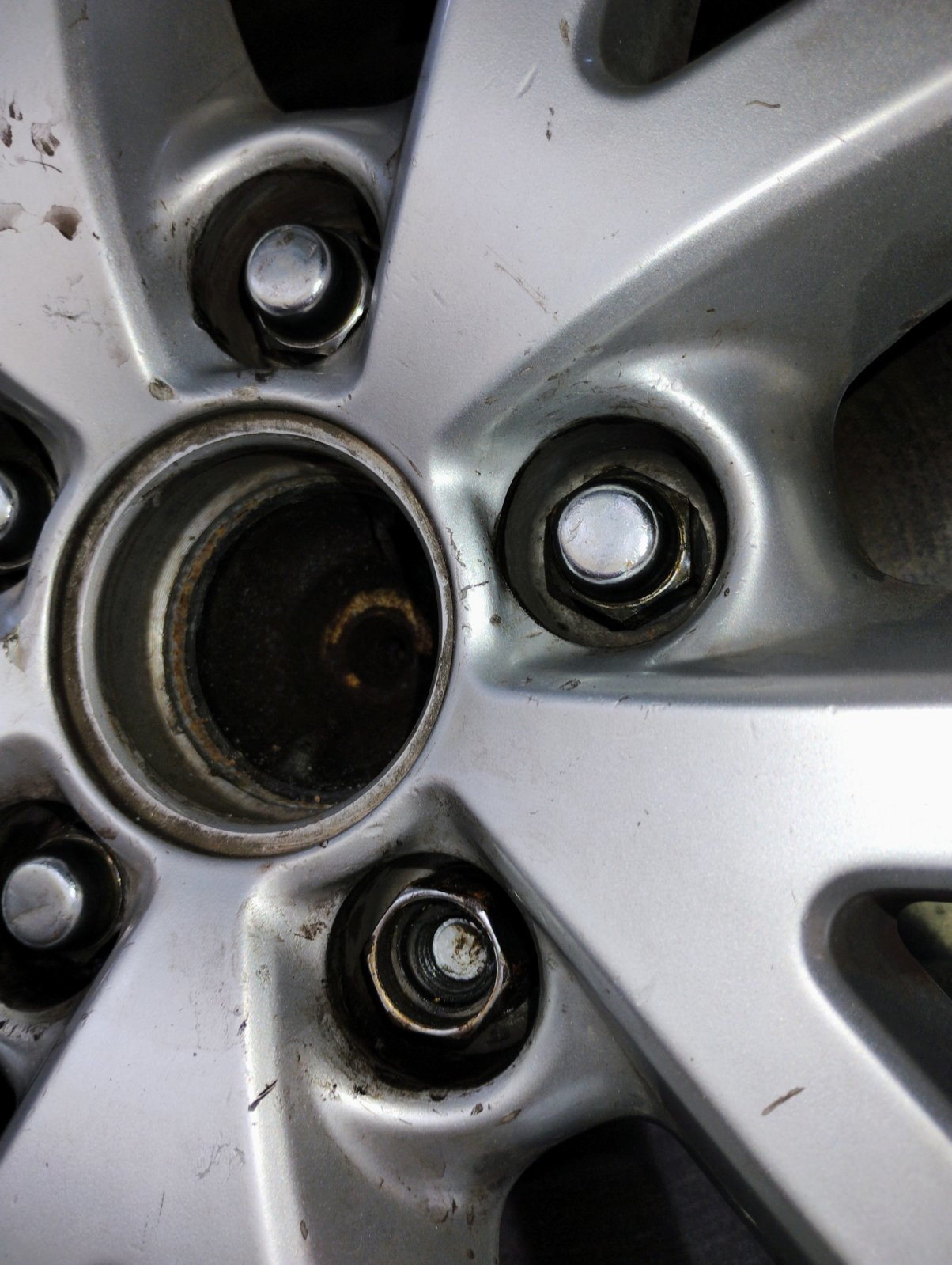

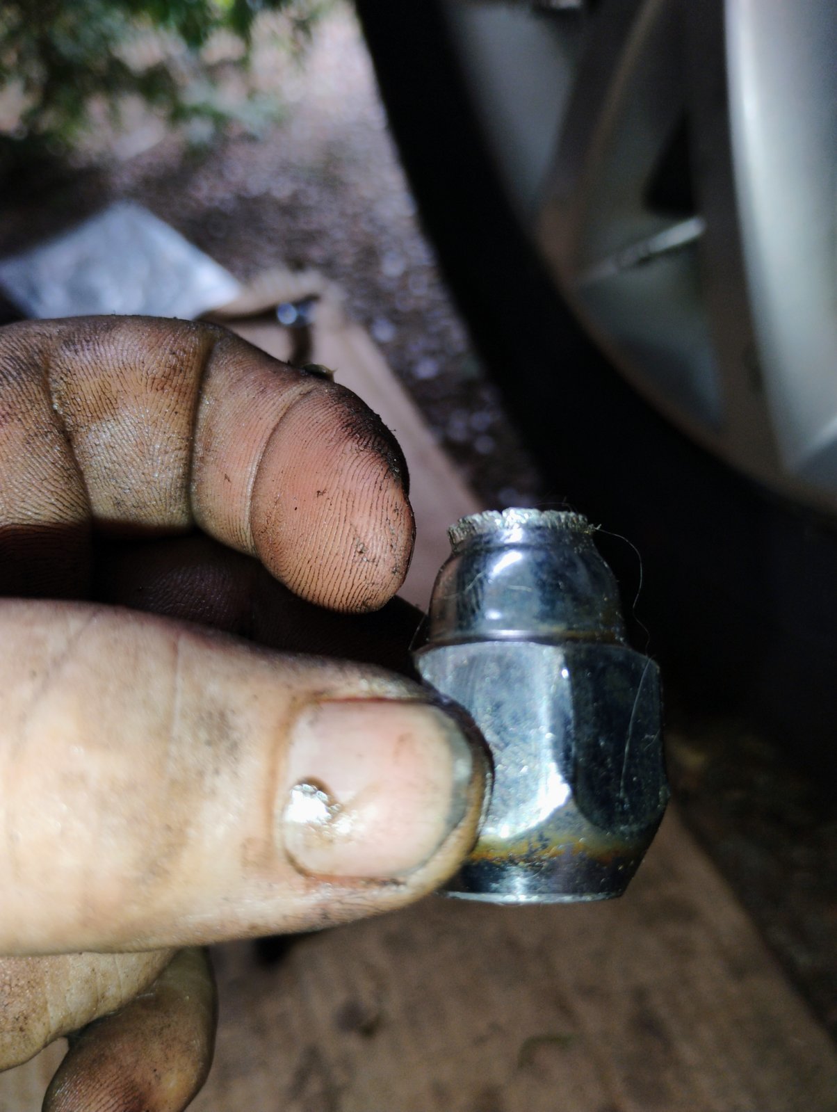

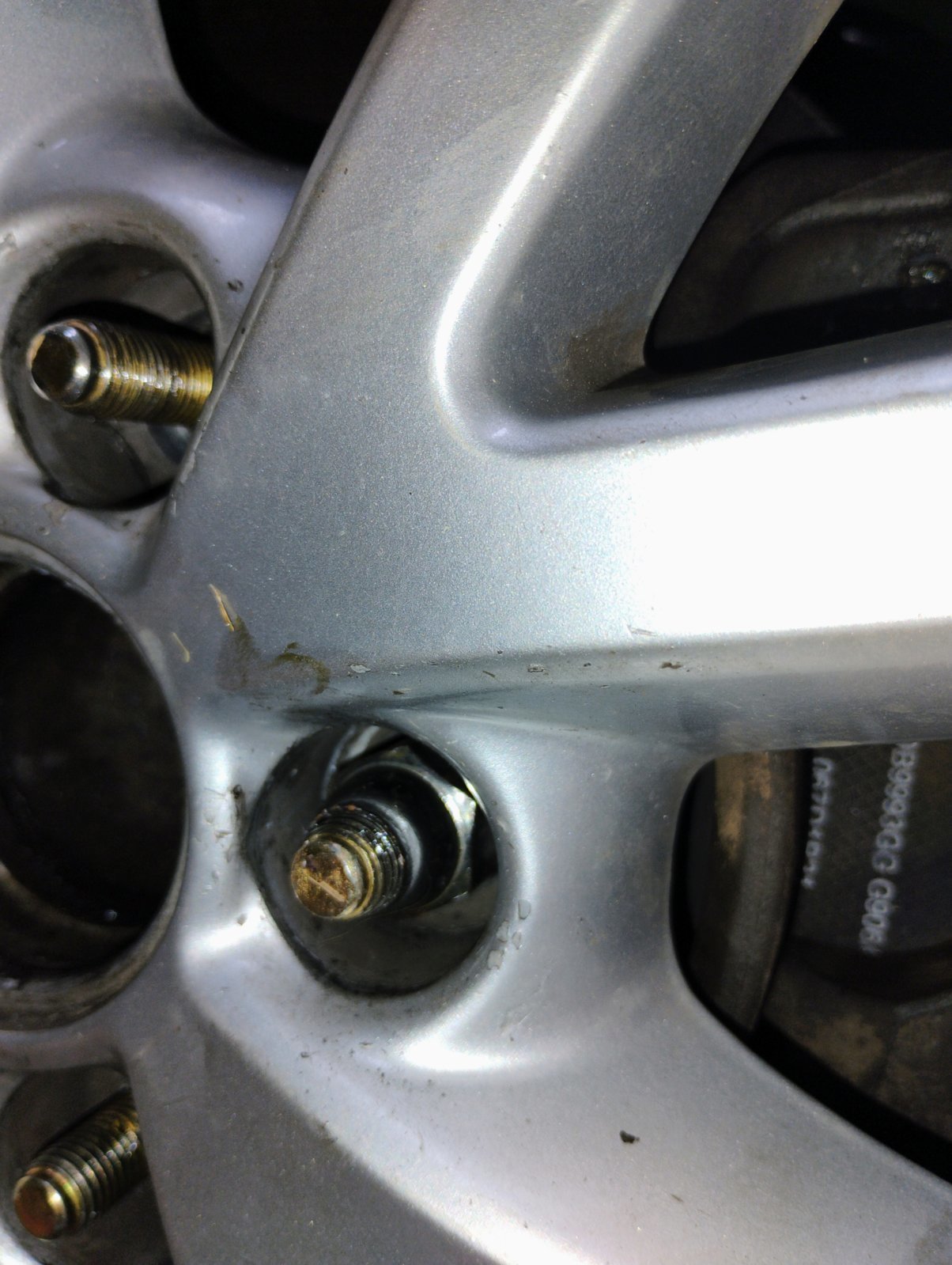

    Looks like they are a tad long..Can I continue using them even though they go past the end of acorn nut..,see pic .? Later I will get some different lug nuts..

    3 full turns is a good way to strip the threads. At a minimum, the thread engagement should be the diameter of the stud.
    When I was in quality and rejecting internal threads for the oversized minor diameter, the engineers would allow heli-coils as rework. The engineers allowed heli-coils in steel a minimum of the diameter of the bolt/screw, preferably 1.5 times the diameter. In aluminum, it was at a minimum of two times the diameter of the bolt/screw, preferably 2.5 times the diameter. In my day I caused a lot of rework for this.

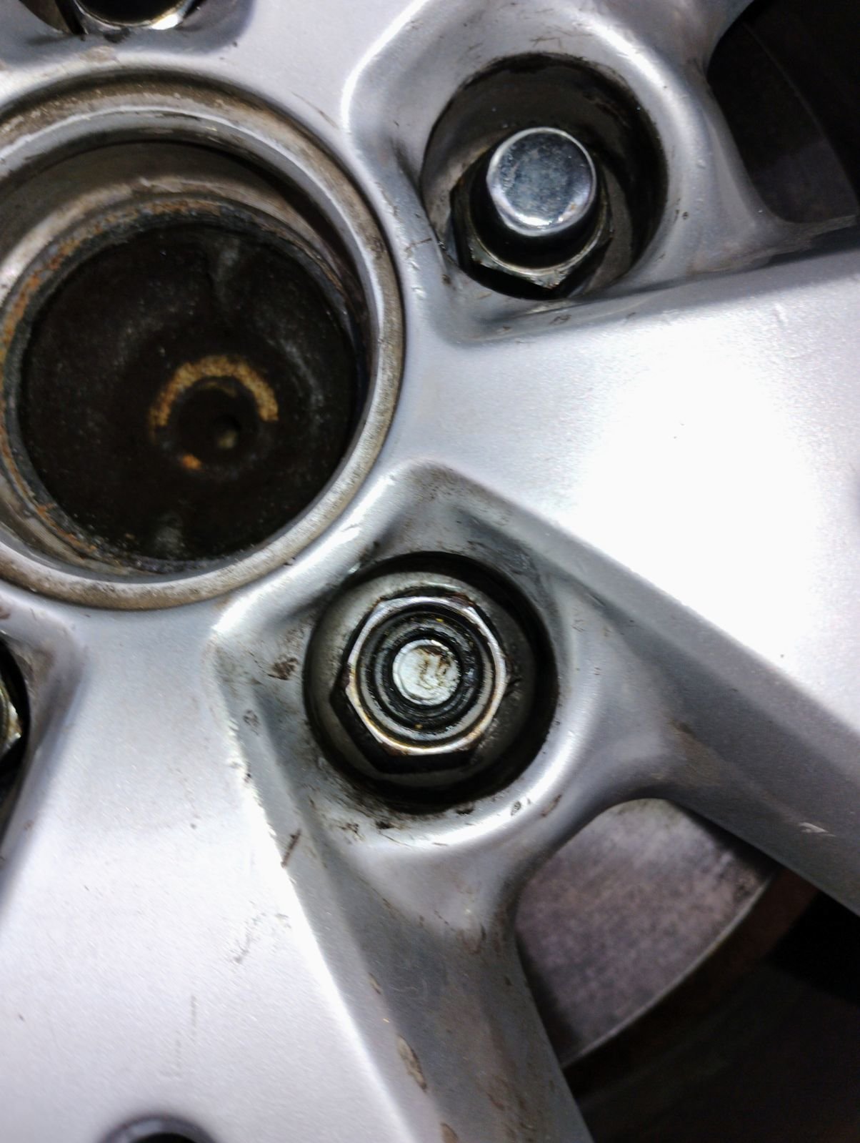

    Again..I'll assume it's safe to drive on the acorn nuts with end off, it's just a flat small thin piece on outside
    I think there are longer ones I may buy later though .

    What in the world is happening here... You bought studs so long they punched through the top of the nut!? Is that what Im seeing?
    Seems like a terrible idea to me. Those new threads formed in the top of the nut will almost certainly take a great deal of force. IE the same torque applied to this situation will yield a much much lower clamping force from the wheel to the hub. Bad idea.

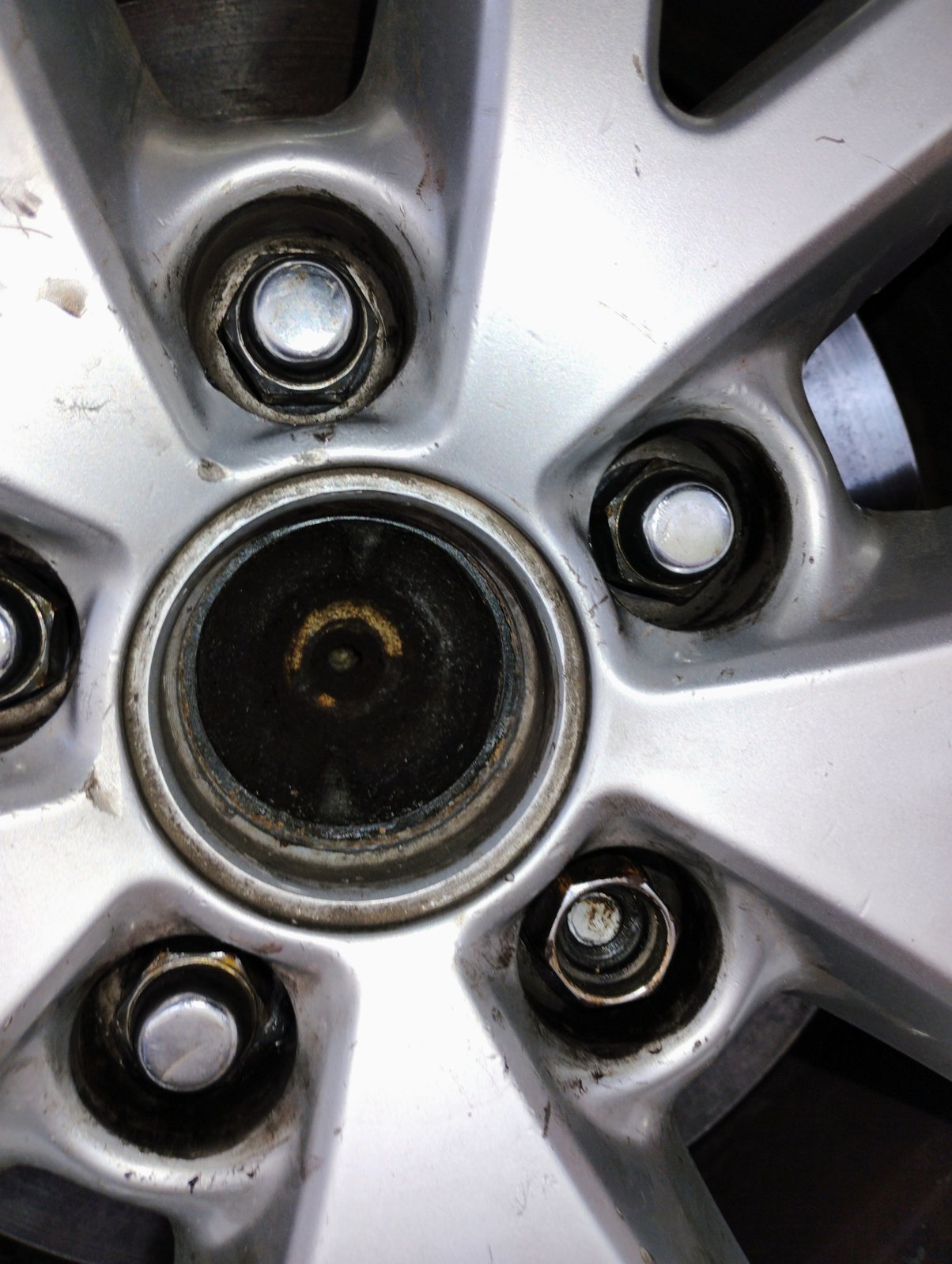

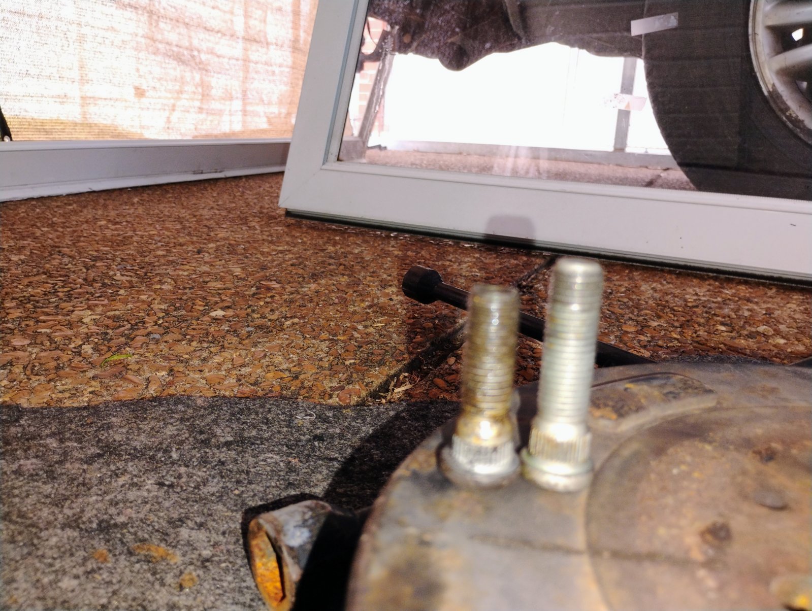

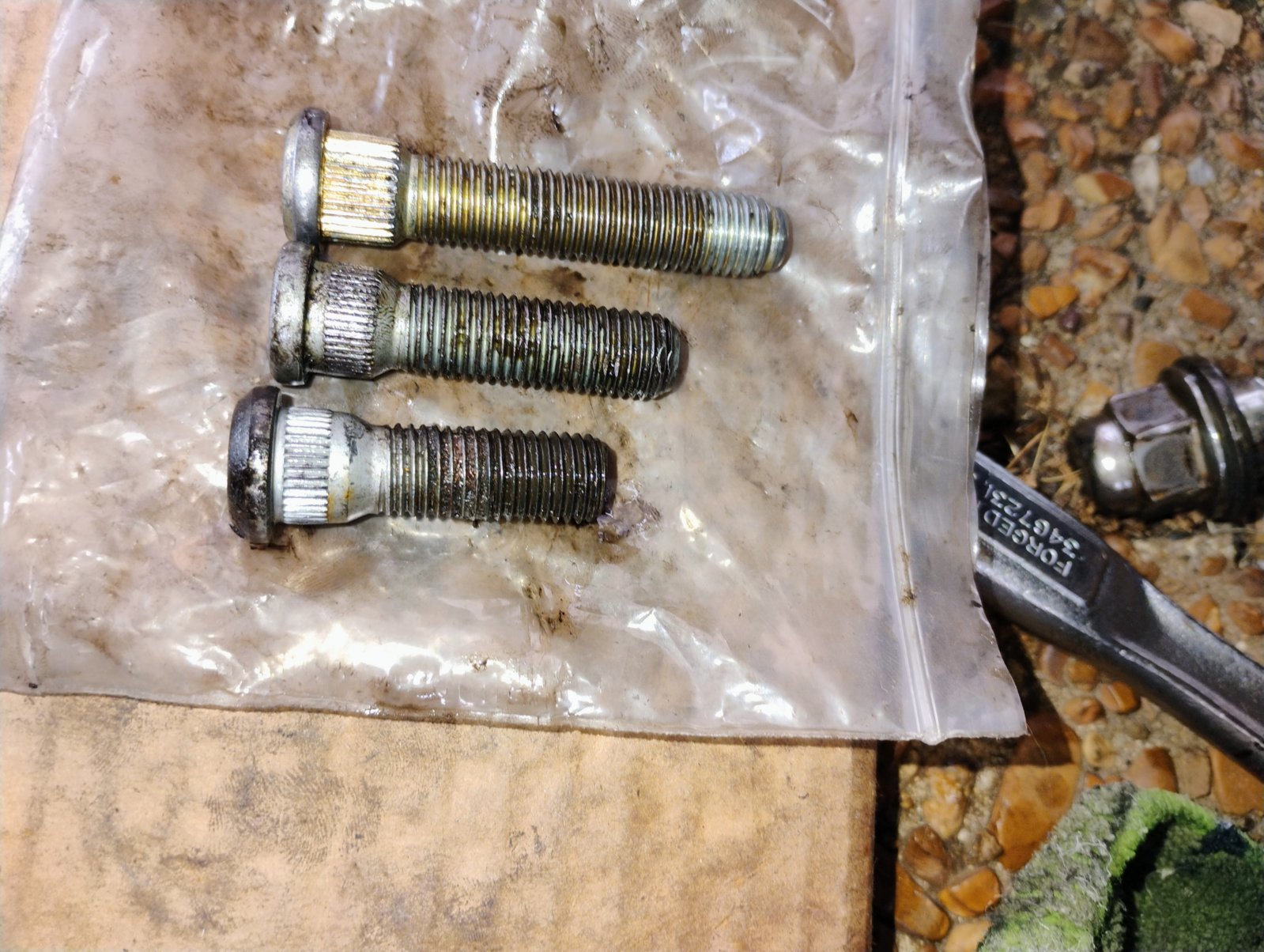

    I actually just located the IDEAL studs off a DodgeJOURNEY.
    They are longer than the Tacoma an shorter than the 50mm.
    THIS CAN BE HELPFUL TO OTHERS IN THE FUTURE
    In pic of 3 the OEM is shortest the Dodge is next(IDEAL) an the 50mm long one is last.
    .Original Lugs fit great an you get about 13 turns! Very Solid in the hub too.

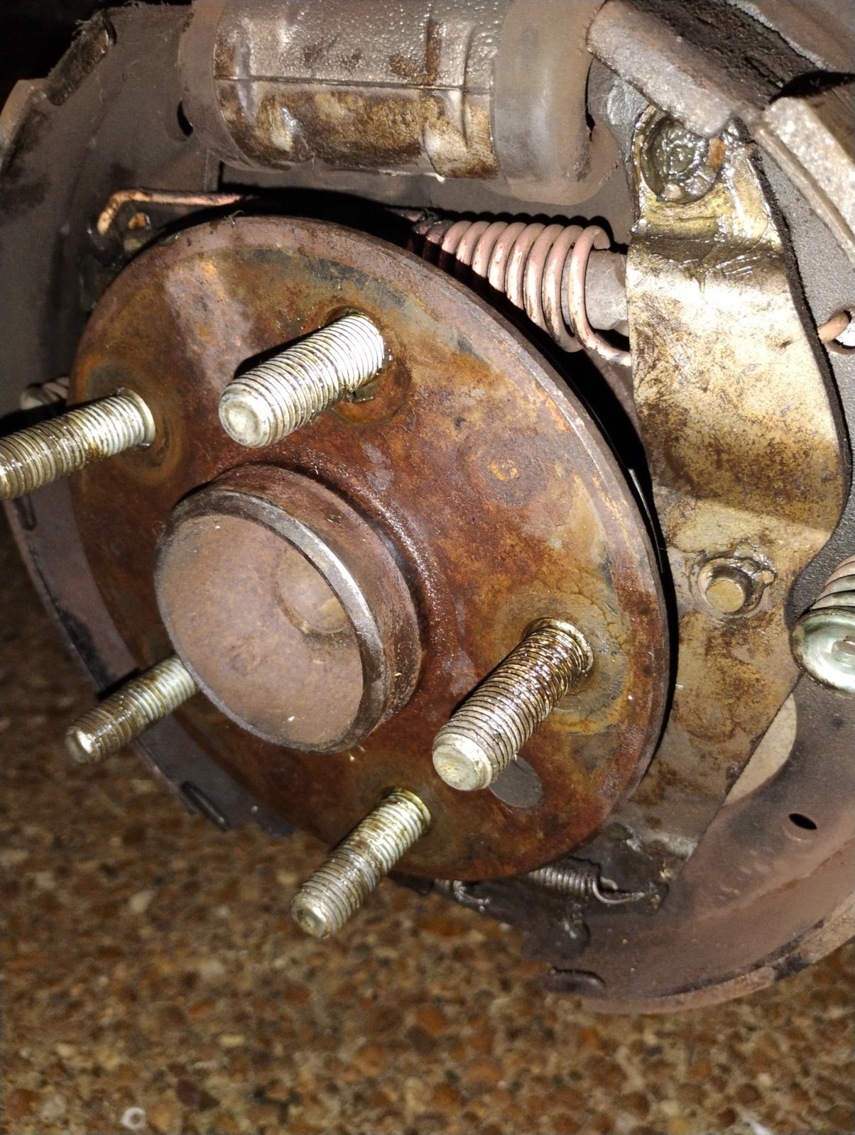

    What's that back plate used for in BK of the hub where stud goes in?

    84
    This is that plate I asked on
