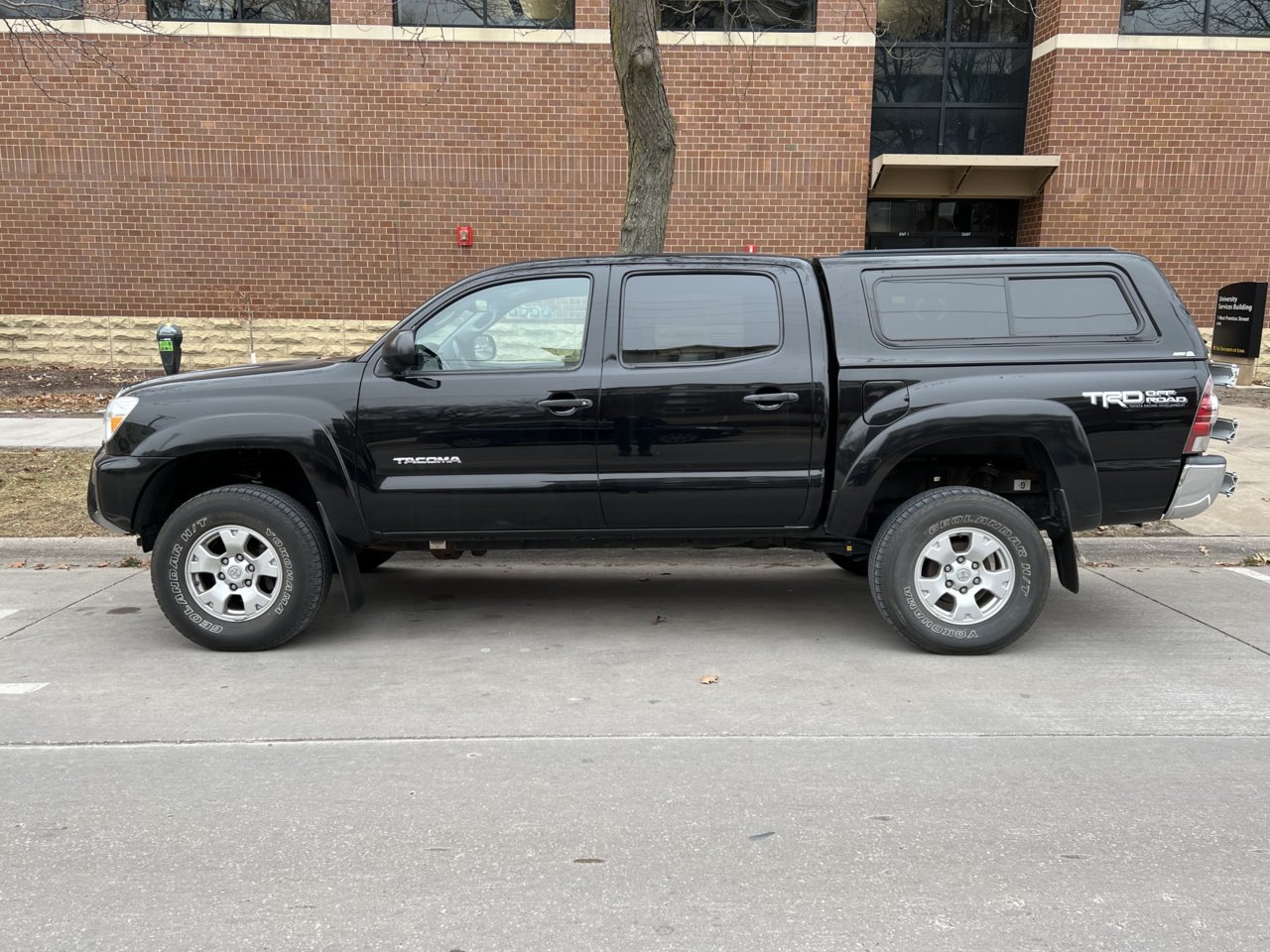

    Hello (Tacoma)World! First time poster (long time lurker) here. I am looking for suggestions on wheels for my 2nd Gen. I have about a 2 1/2 to 3" lift in the front and what seems to be about 4" in the rear. Hub center to fender measurements are:
    front: 23"
    rear: 25"
    Anyway, my goals for the truck are to have something functional for getting to remote trailheads/campsites while loaded with camping gear, mountain bikes and potentially a rooftop tent that I would mount on a cover/bedrack in place of the topper I'm running now. As it stands, my topper and bikerack weigh probably 300lbs.
    For tire size, I'm thinking I'll probably stick to 265/75/16, 265/70/17, 275/70/17 or 255/75/17. I'd love a 255/85/16, but I don't want a mud tire. And the only other option I see are the 58lb ST Maxx. That's a little heavier than I'd prefer. A 255/80/17 would be great too, but I don't want to deal with a CMC.
    As for specific tire models, I'm leaning toward Toyo AT3 load E in 16". In 17", I'm looking at either the Toyo (E), a BFG KO2 load C or maybe a Mickey Thompson Baja Boss in XL.
    At the moment, I'm running the stock 16x7 TRD OR wheels, which are about 22.5lbs with a +30 offset. I actually like the look of the wheels with the black truck and chrome bumper/grille. I think a black rim wouldn't look as nice with this particular truck, but I'm open to ideas. My main issue with these rims is the +30 offset. Given the amount of lift I have, the extreme positive offset makes the tires look disproportional to me. I know I could get spacers, but I'd really prefer a wheel with a better offset. Also, by going to a 17" wheel, I would have additional (lighter) tire options and sizes, such as the load C BFG and the 255/75 tires.

    I really like the SCS wheels 17x8.5 and a offset of -10, I ran them with 265s and then when I went to 285s they worked great. The Method 701s are nice as well as Black Rhino. If you can stick with an offset of around 0 or -10 on a 8 inch wide wheel that helps fitting tires. My 285 70 17 load C tires only weigh 51lbs, lighter than lots of 255s if you are trying to save weight. I get around 20 mpg avg on the hwy with 60 mph speed limits.

    Random question but what size tires did you have on the wheels in the photo?

    Those Geolandars are 265/70/16. They look pretty silly with the lift.
