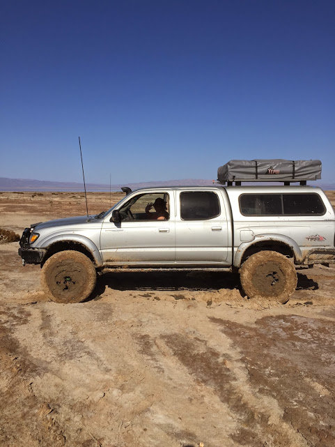

    They should, I just put a new set of wheels at a shop that installed the same set as mine on an FJ a few hours earlier.

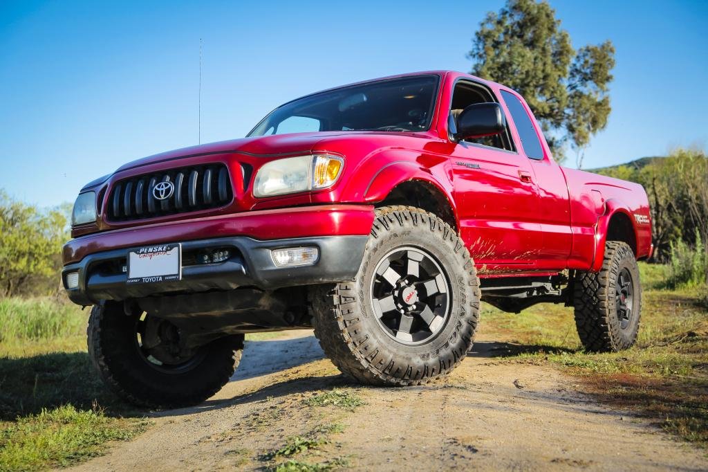

  9. Mar 19, 2015 at 11:27 AM
    Saucy
    Saucy [OP] Well-Known Member
    Mar 17, 2015
    #151171
    57
    Nor-Cal
    1997 taco & 2019 tacoma TRD Off-Road
    Too many to list
    Thanks for the pics----MY FINAL QUESTION IS----Will my truck need spacers because of wheel rub??? The tires I am gonna put on are either gonna be 265/75/R16 or 265/70/R16

    Im running them no issues. I run 1.25" spacers just to minimize frame rub with 285/75's. Youll get a little frame rub without the spacers at full lock with the wheel compressed. and still a little bit with the spacers. Not bad though.
    Youll be fine with 265/75/R16 or 265/70/R16's.
    The looks are worth it if you go for 285/75s!
    Also mind the ebay wheels are replicas and also come with plain white hub caps. They dont have the TRD logo on them.

    The size is
    17 inch x 7.0 inch x 4 mm offset
    The tires are BF Goodrich All Terrain T/A KO2 P275/70R17
    FYI I have a 3'' OME lift
