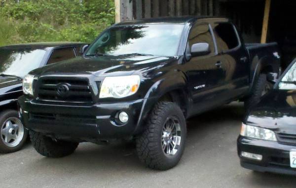

    You'll have no issues at all in the rear with this setup. The front is another story, you'll definitely have some rubbing that will require a bit of trimming. I ran almost this exact setup, with the only difference being my wheels were a +0mm offset and I was running 5100's at 1.75".
    The only time I rubbed was in reverse, on the inside of the bumper. With a -12mm wheel, you'll probably rub the bumper a little more than I did but it's easily solved with some easy trimming. You shouldn't have to worry about rubbing the cab mount either, so I wouldn't hesitate to run this combo on your setup. Here's a picture of mine:

    Thanks for the info and pics guys!!!
    Bretbetterson do you have the Eibach and 5100s @ 1.75 up front or just the 5100 @ 1.75?
    Also is the trimming you both speak of just the black plastic behind the front bumper?

    I don't have Eibach's, I have stock coils on the 5100's at 1.75". Sorry, I can see how that was confusing.
    Like brian said, the trimming is just the black plastic liner behind the front bumper, specifically the cup that hangs down. The only thing I would disagree with brian about is the cab mount chop. There's no reason to do that mod unless you're rubbing on it, and I don't ever rub on it so I don't see any reason to do it.

    Thanks for the info. That is a good looking Tacoma! Mine is silver as well and I have the same steps, but with the 3" tube. What antenna is that you have on there? Does it get good reception? Same as stock?
