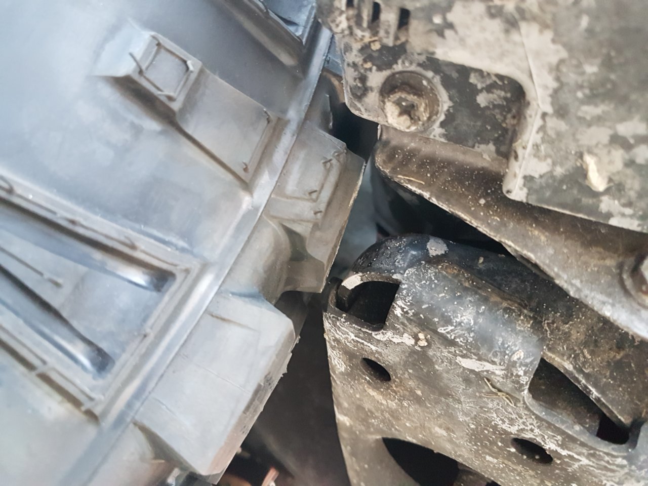

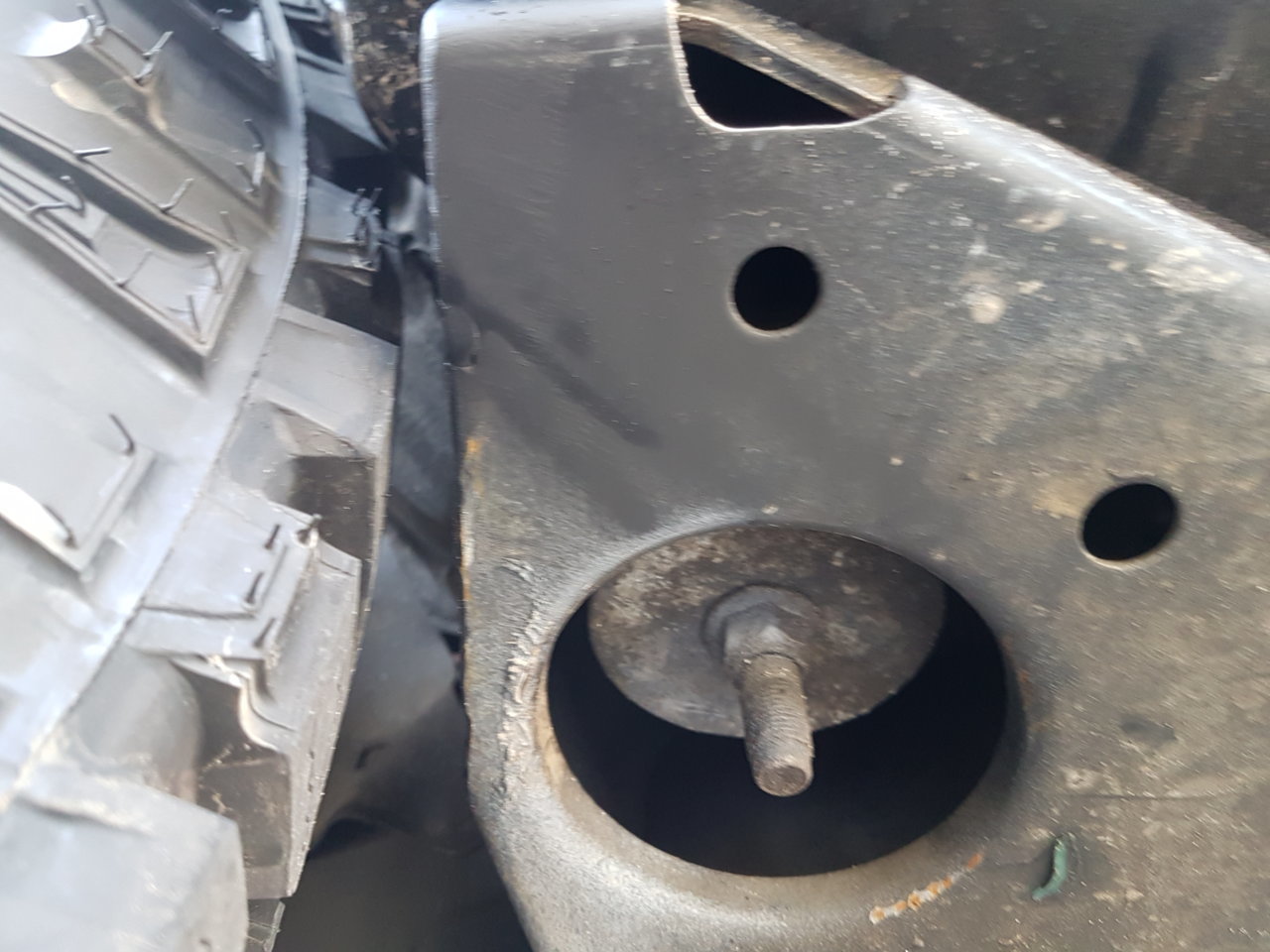

    there is no consistency with these trucks. some will run that very tire and have no issues others will.
    the problem is width and you're moving further out. when turning you're likely to rub on body mount.
    Those telling you they are running with larger than that with no modifications are either only driving in a straight line or ignoring the fact they are rubbing.
    Put the tires on and see .You might need to just trim plastic or cut body mount.
    My 265 70 17 rubbed plastic.
    My 285 70 17 rubbed a whole lot more.
    This was 3.7 degrees of caster and 2" lift with 285 with 1/4 turn
    This is now after cutting body mount and a shit load of plastic with 2.5" lift I still rub with flex
    I know it's 285 but width wise it's only 5mm difference
    I also had to hammer pinch weld flat but this is a 33" tire
    width is a killer for tires on these trucks.
    if you dont want to risk needing to cut dont get anything wider/taller than a 265 70 17 or 265 75 16.
    Unless you run a 255 85 16 on stock Off road wheels and suspension. Otherwise you may rub body mount.
