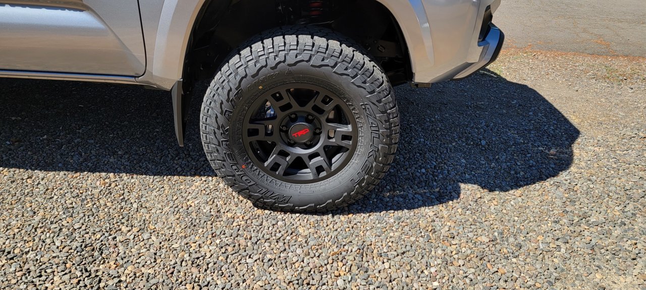

    Most toyota wheels have diff offsets. Below is a post listing out sizes and offsets for each oem wheel
    https://www.tacomaworld.com/threads/wheel-specs.30754/
    My SR5 came with 16x7 black alloy wheels with 25mm offset. I recently upgraded to 17x7 4 runner TRD Pro wheels

    I am selling my oem wheels and tires. Located in Oregon. Less than 500 miles on them

    Thanks, that helps. It appears that the stock offset measurements wont affect the stance much if at all.
    I found this helpful as well;
