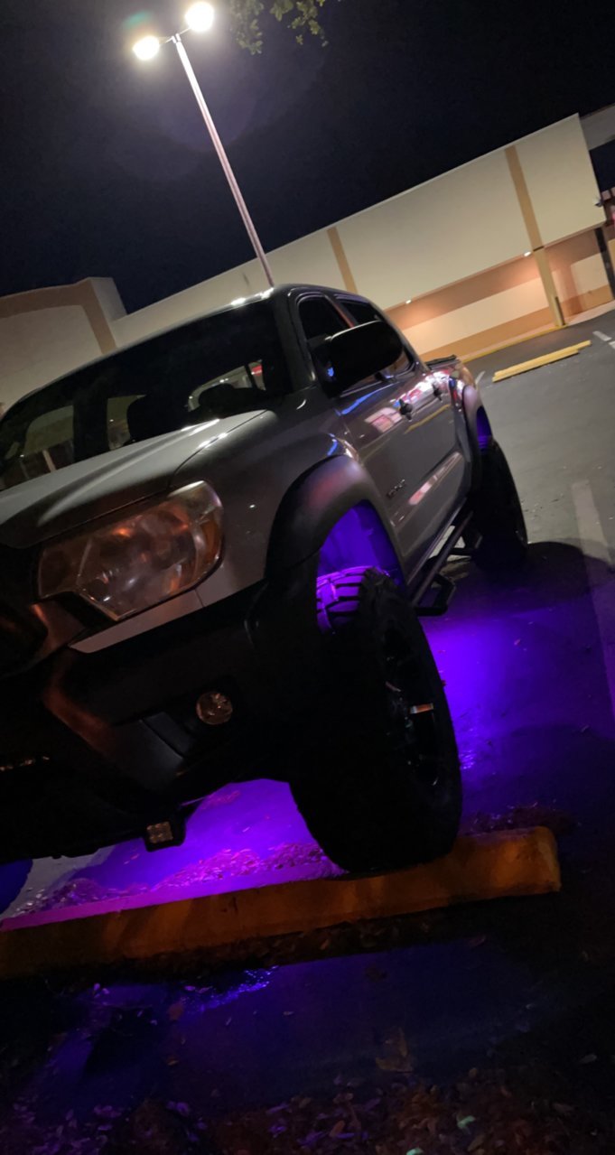

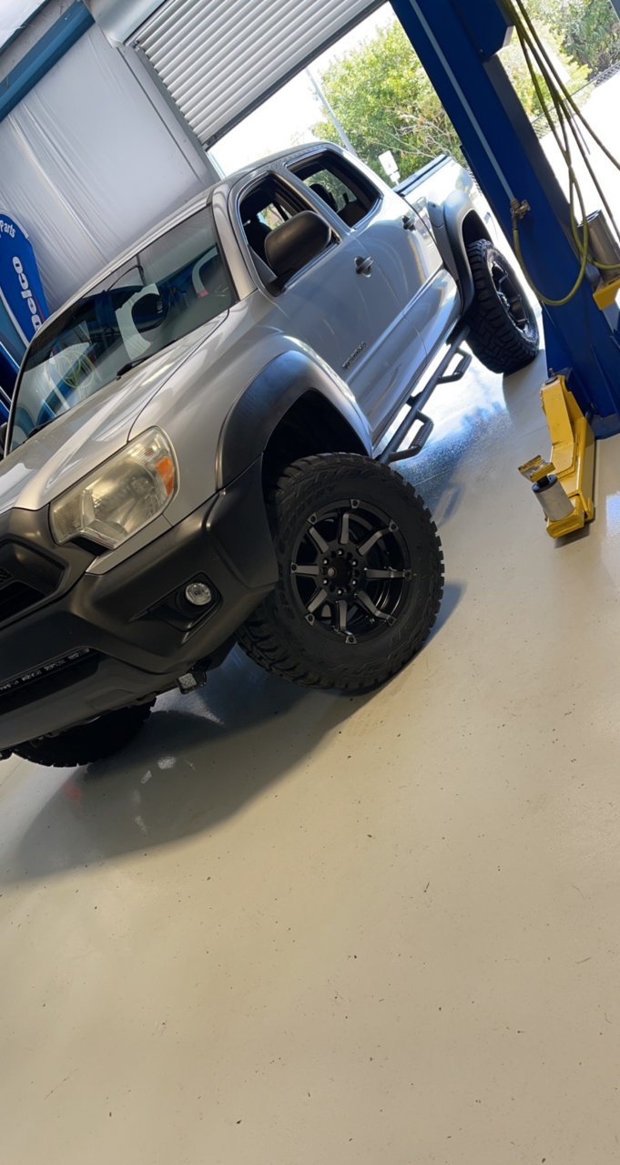

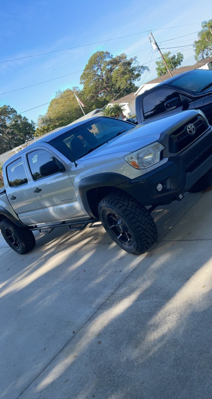

    Backspacing is your friend when it comes to wheels and tires, I have 33x12.50 on a set of fuel couplers 18x9, +1mm offset can’t remember the backspacing off the top of my head. I only had to do minor trimming to the fender flares down in the wheel well at the bottom, and cut like and 1/8th of inch off the front wheel well liner on a 2 inch leveling kit from rough country4F8D52A5-4CD7-42D1-A6FB-B0A4C37623B6.jpgE943CC1E-799A-4B31-AA9C-07AB04AB11A9.jpg3C8A38E2-C1A7-4C5C-AC03-7720D2EFC446.jpg
