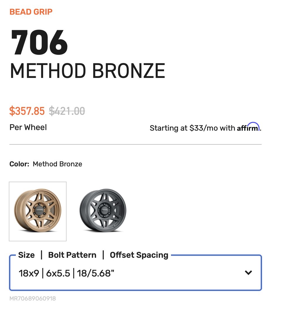

    I have a 2020 Tacoma TRD Off Road Double Cab Long Bed, and I am looking to add new wheels and tires to it. It is currently at stock height, and a lift will happen hopefully later down the road. I don’t know much about offset and backspacing, and whether it will effect the suspension/steering components or not.
    From what I have found, I believe my stock set up is 16x7 with 25mm offset. I do not know what the backspacing is.
    The wheels I am interested in are the Method 706. Also, I do not want to use wheel spacers.
    The tire sizes I am interested in for the 17” wheel are:
    255/80R17 (33.1” / 10”) “pizza cutters”
    265/70R17 (31.6” / 10.4”)
    From reading on the TacomaWorld forums, I believe these tire sizes will work without rubbing.
    I am somewhat interested in an 18” wheel, as I have come to understand the new 22+ Tundra has the same lug/wheel pattern as the Tacoma now, and there’s a slight chance I might upgrade to a Tundra later on and want to bring the wheels over to the Tundra. If I plan on upgrading the brakes on the Tundra to a powerbrake system or something similar, from what I’ve heard 18” wheels are the minimum size that will work with the Tundra (please let me know if that is correct or not).
    The tire sizes I am interested in for the 18” wheel are:
    255/70R18 (32.1” / 10”)
    265/65R18 (31.6” / 10.4”) This is the one I've seem listed as the largest on stock height.
    265/70R18 (32.6” / 10.4”) Why would this not work? its stock width, but a taller tire.
    If you could please answers for these questions for me:
    1) I need to know if the wheels themselves will fit on the truck without interference of any of the suspension/steering components without the need for wheel spacers.
    2) If the tire setup will be ok on the truck with the wheels selected.
    Thank you for your time and your help.

    On the 18” wheel the 5.68” Backspace may be too much. I know on the Tacoma 5.5 is about as much you can go before you run into clearance issue.

    Thank you for letting me know that. Looks like the 18” is just out of the question for the Tacoma. 17” it is!
