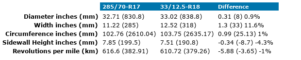

  5. Aug 28, 2009 at 3:27 PM
    98tacoma27
    98tacoma27 is going full "Ben" Moderator
    Dec 18, 2008
    #11714
    54,958
    Ben
    Beech Creek
    05 Tundra SR5 (+265k AND COUNTING), 88 SR5 PU (SOLD), 98 TRD OR (CRUSHED)
    5100's all on fours
    Those are 285/70 R17 on a stock truck. They are a little smaller (height wise) than what you plan on doing but not much as you can see in the tire calculator.
    You will have some issue with the width though.

    You should be ok with the 3". The offset should be -12mm and the backspacing 4.5".
