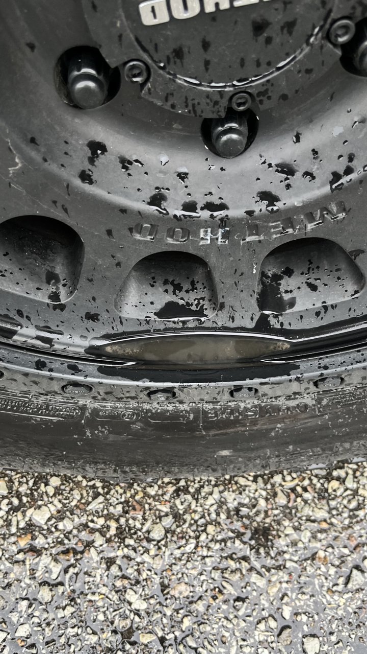

    Looking for some insight. I just got a set of Method 305s put on with a set of Baja Boss AT tires just the standard SLs. I’ve had these on since last Wednesday the 26th. Wednesday and Thursday were both dry and everything seemed fine, but every day since it’s been raining and I noticed a vibration seeming like it was coming from the rear wheels. I also had noticed one of the wheels didn’t have any weights on it. Trying to be on top of it i went back to Discount Tire yesterday to get them rebalanced. They rebalanced them and told me one of the rear wheels were indeed out of balance. Nice, should be good now (I thought). Went to work this morning and the vibration was even worse. I’d previously noticed that these Method 305s seem to like to hold some water on the outer lip, could this be the cause of my vibration/ roughness or am i just getting a bad balancing? One of the wheels still has no weights on it, but now instead of it being in the rear, they moved it to the front. Is it common for a wheel to balance perfectly? I’ll obviously wait till it’s dry to see if it’s any different but it’s suppose to keep raining here in PGH. Appreciate any thoughts or insight.

    That water pools after the vehicle sits, it doesn't stay in place like a solid would with centrifugal force.

    Yea i guess once it’s moving and the water kinda spreads out there’s no way it’d be enough to throw it off. Was just kinda thinking since the water just stuck in there maybe it could.
