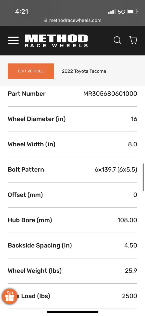

    Here’s the specs
  8. May 5, 2023 at 1:22 PM
    #28
    Halloween
    Halloween Well-Known Member
    Nov 8, 2022
    #410220
    522
    Steve
    Toyotas a plenty
    Got it I just looked at you post. Standby. I’ll find the ones I bought. Fit perfect. Standby

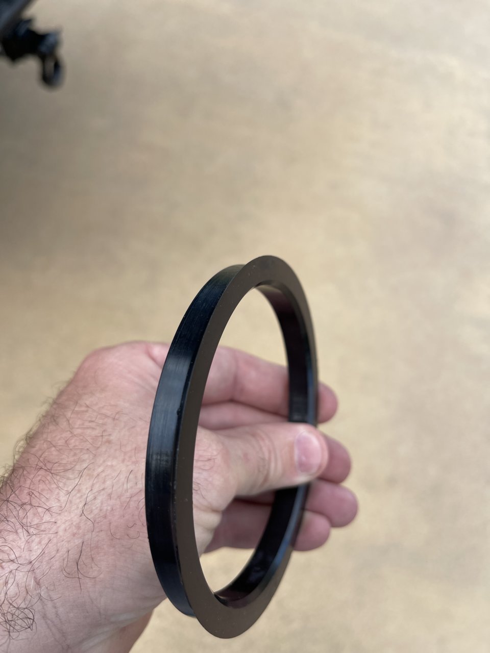

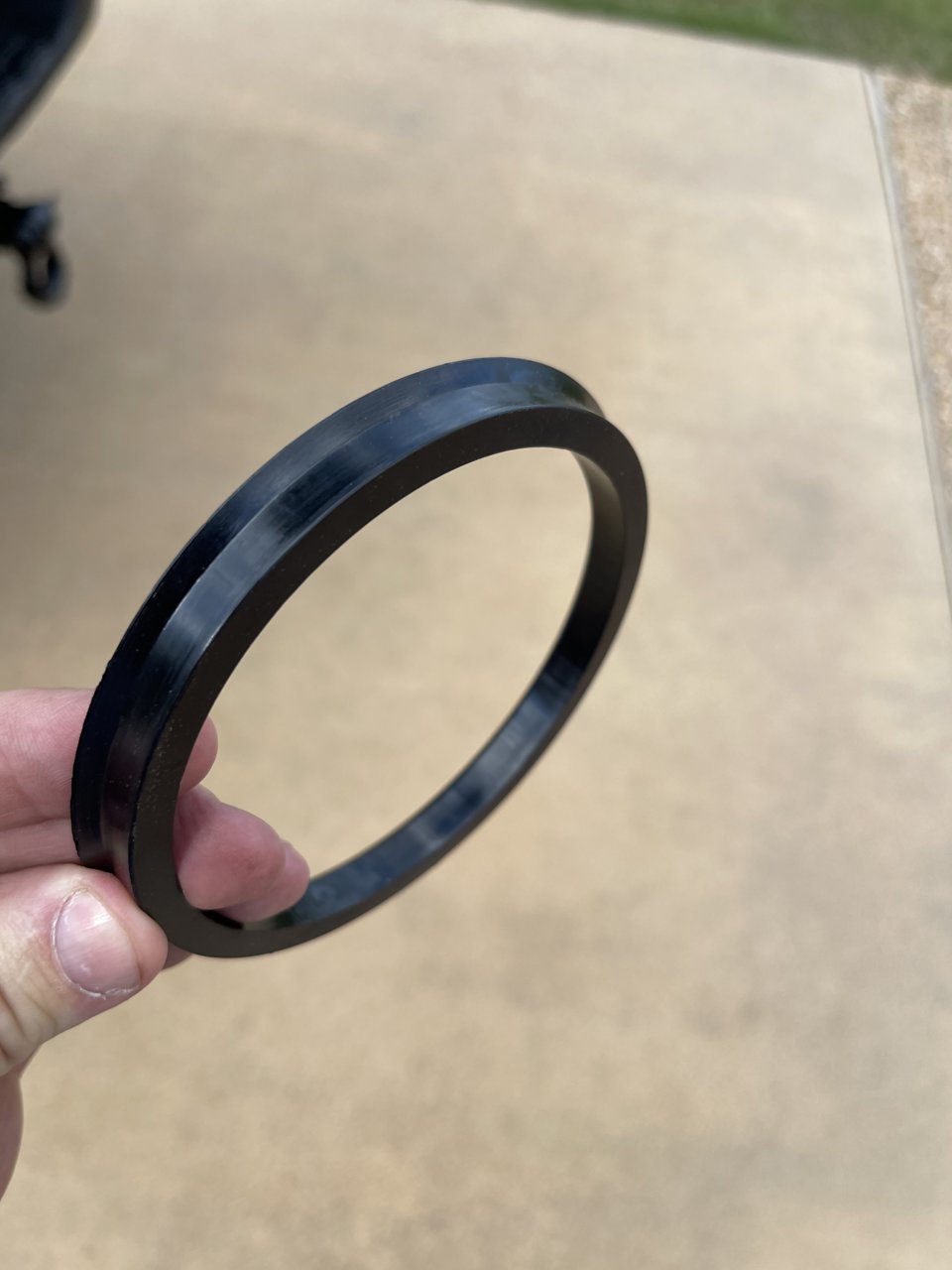

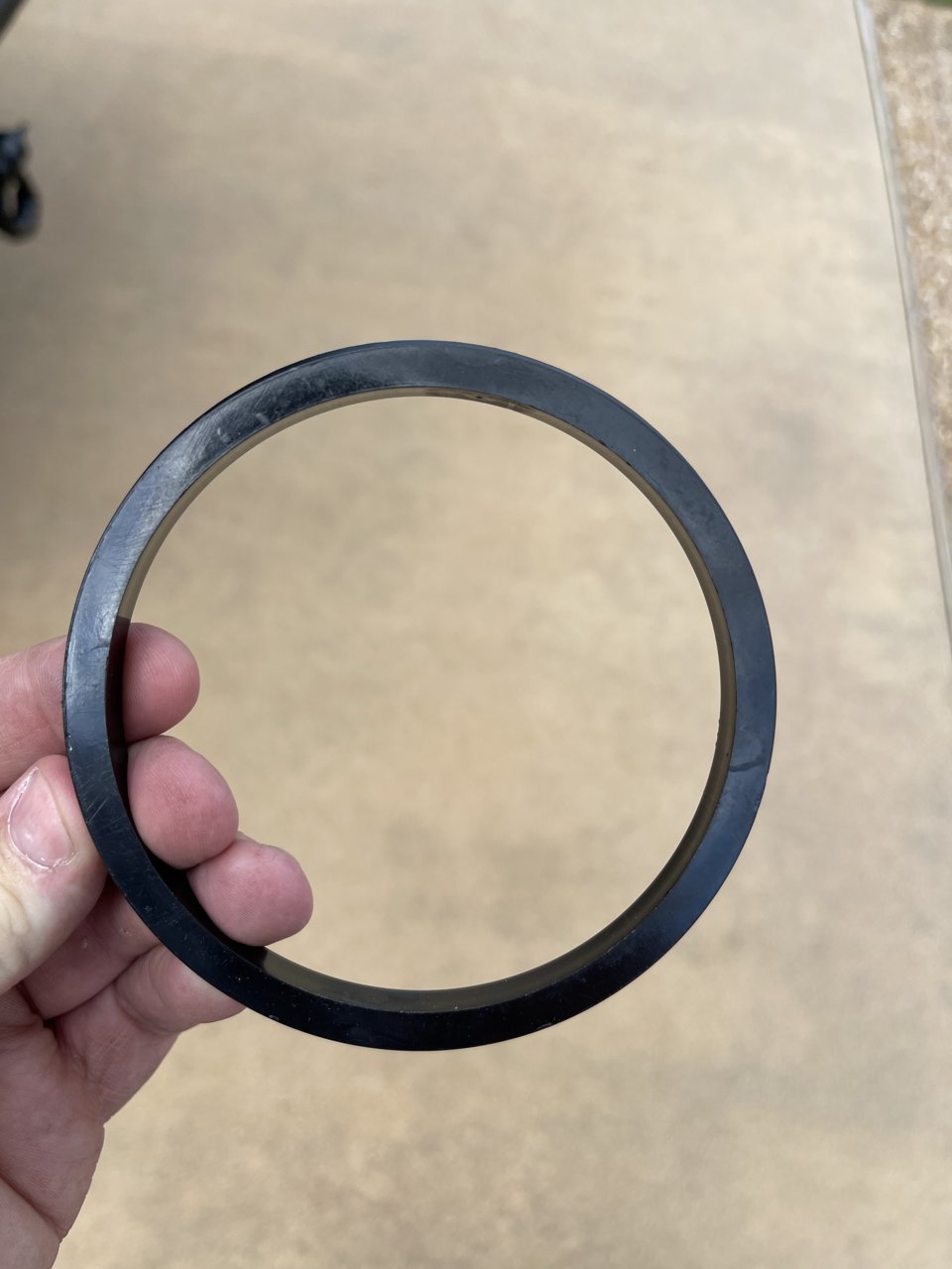

    Here’s what they look like some are made of plastic and some are made of metal. Custom offsets almost always sends me the appropriate rings when I order from them.
