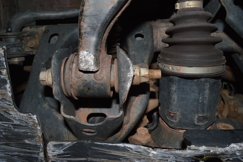

    Thanks dude. Yeah, I am in the process of replacing my lower control arms at the moment. The bushings are toast and the area that impacts the bump stops look like a musical steel drum! :eek: Are there aftermarket bump stops, can you point me to a couple?

    Thanks. I also bent the frame mount. My best detective work suspects a rock got the best of it.

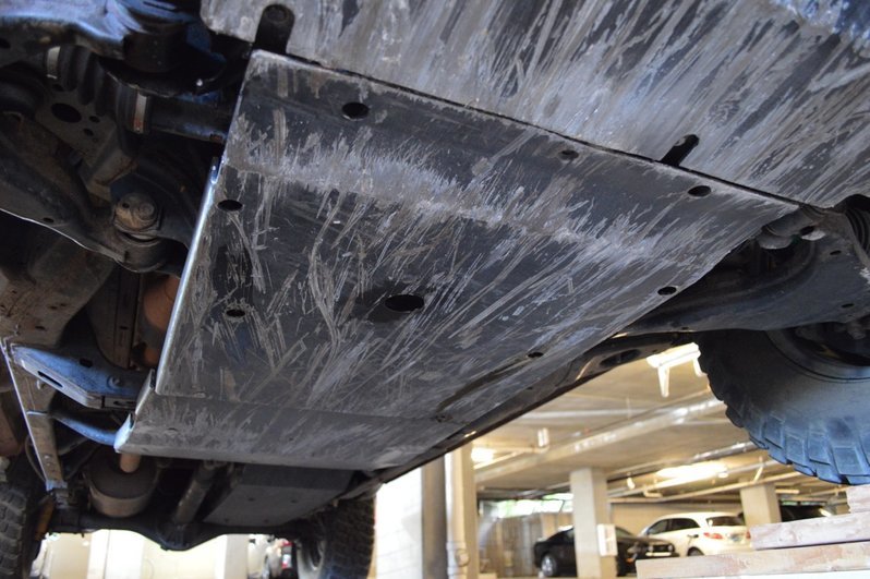

    Yeah, I have considered removing the sway bar. The truck doesn't see many non-wheeling miles anymore since I work from home.
    My plan is to heat that mount up good and hot using a torch. Then try to reshape it to match the other side as best I can.
    Also - skid plates on my truck have lived up to their name...
    I'm not trying to hit stuff, contrary to how it looks, but sometimes you just need to clear an obstacle that requires a little bit of skidding. Other times something sneaks up on you. "yeah, I clear that...crunch!...nope!"
