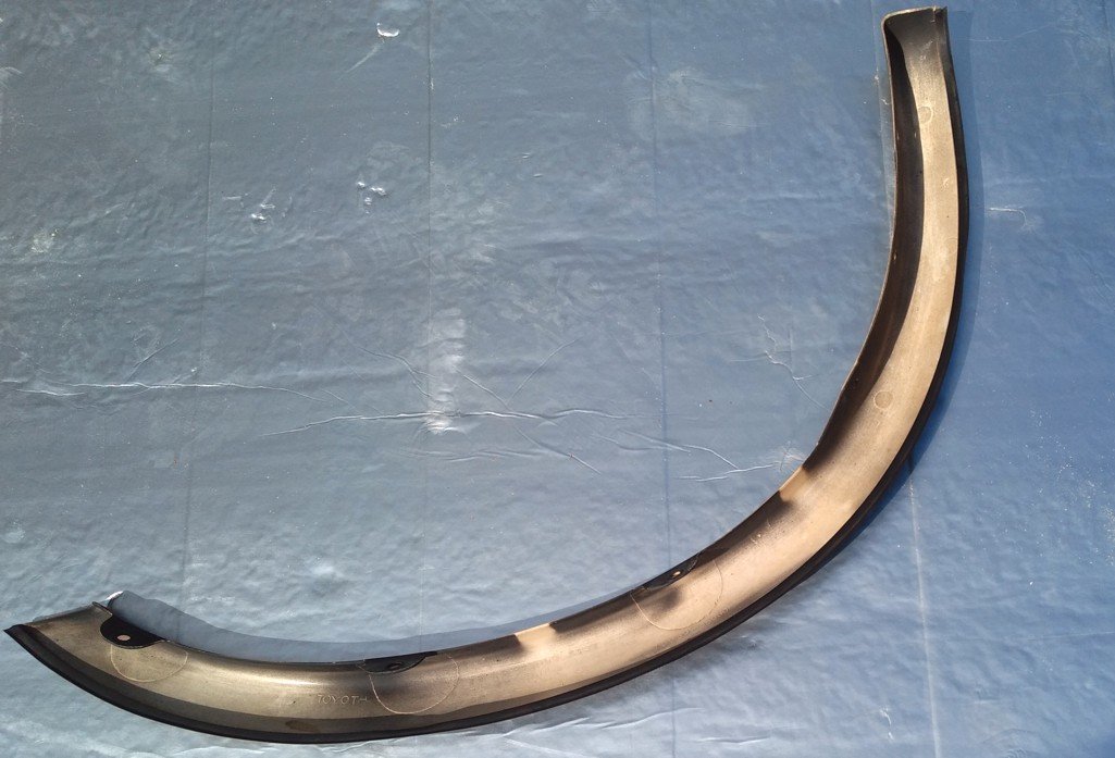

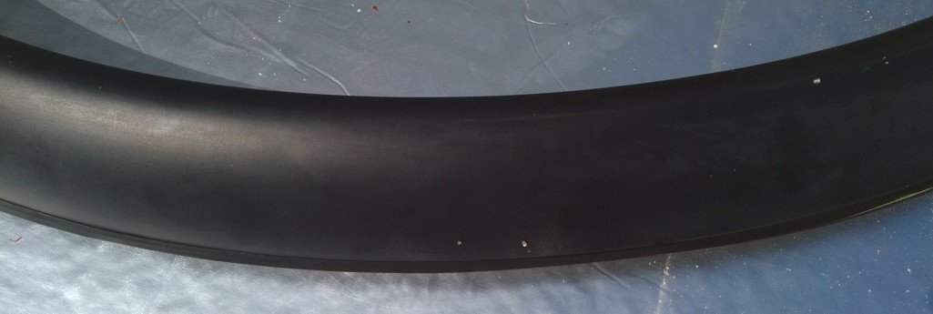

    My 99 model wheel trim has suffered for years without proper treatment. I find no evidence of a product like 303 being used to prolong the life and look. Also, the wheels have some amount of gravel chips that left the ivory colored base showing.
    So this afternoon between rain clouds, I decided to make my first move on refurbishing the wheel trim using Krylon Fusion for Plastic Paint. I've used this paint for refurbishing automotive plastic in the past with success.
    Here's the before and after pictures with some tips on how I used Krylon Fusion for Plastic Black Satin finish.
    PRODUCT NOTE: Krylon Fusion has been updated to become Krylon All-In-One for plastic and metal.
    Thank you @jnossoff for providing the product update in the post below.

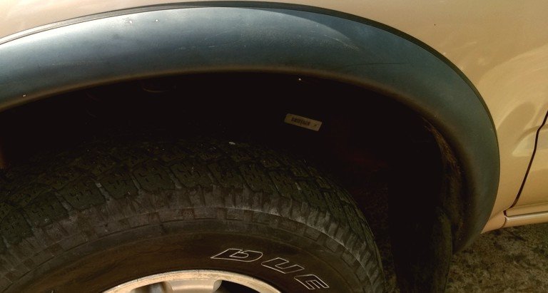

    Before Picture 1
    Before Picture 2
    The wheel trim is made from an ivory colored plastic material. The coloring is from plastic paint that was applied after the trim piece was molded. Here's a picture of the plastic material from the back side.
    Clean with a detergent like DAWN to remove road grime and dirt.

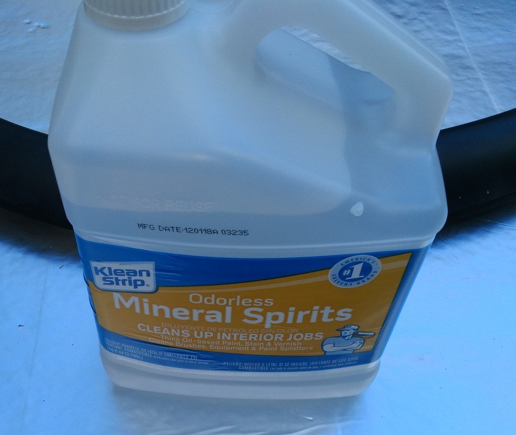

    After washing, use mineral spirits to clean the trim pieces before repainting. This cleaning process will remove some of the original paint. No sanding or priming is required.

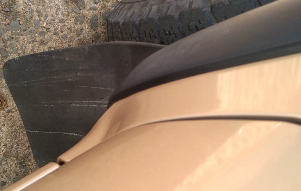

    Here's a picture of the gravel chip marks on the plastic wheel trim before being repainted.
    The Krylon Fusion (old formula) for Plastic or Krylon ALL-IN-ONE (new formula) in Black Satin is available at stores like Ace Hardware and Walmart.
    The Old Formula
    CONTINUED ON THE NEXT PAGE

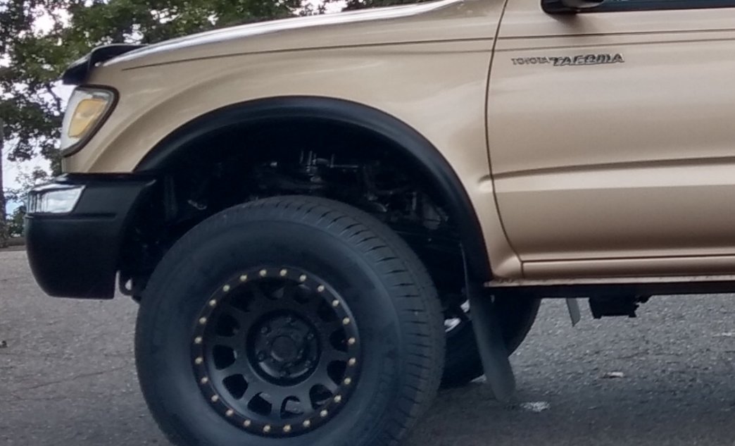

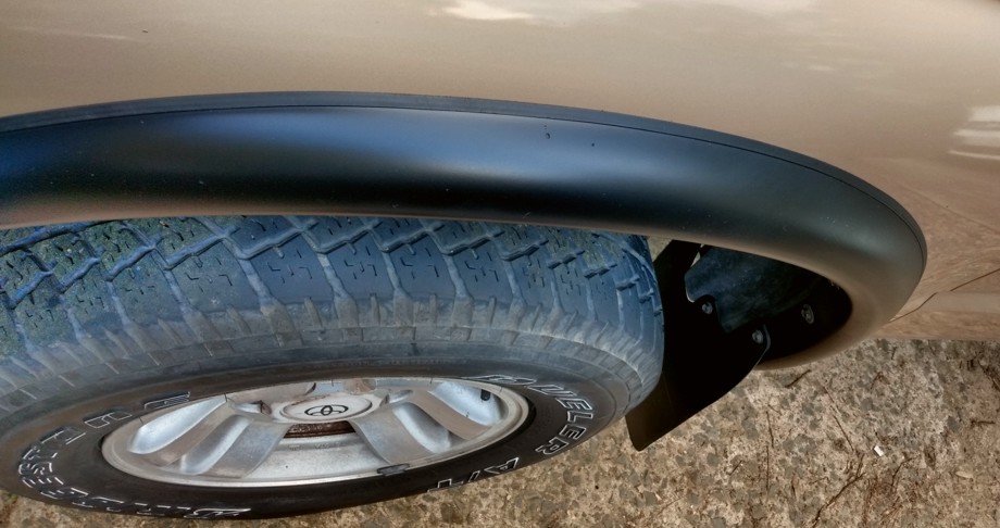

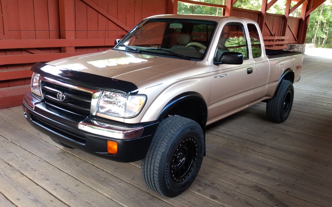

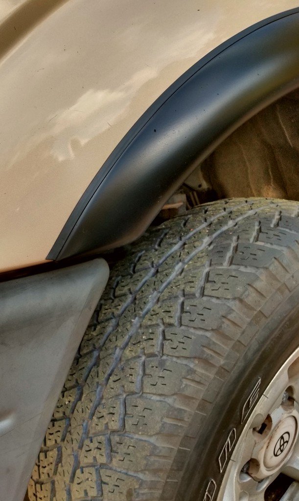

    After repainting with Krylon Fusion. After 7 days when the paint is fully cured, I will be using 303 to keep the new look for many years.

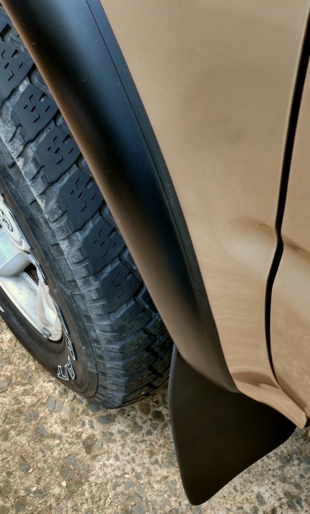

    Another after picture. Note that you can spray the rubber gasket material along with the plastic trim piece. Fusion bonds to either material. As soon as I see clear weather for a day, I will tackle the refurbishing the front bumper.
    The final after picture. Note that pollen is so thick in the air today that has already covered the newly painted trim. Fusion dries to the touch in 15 minutes and can be handled for reinstallation in an hour. After 7 days the new finish becomes completely cured chip resistant. I drove the truck this afternoon around town without a problem. It drives fast.

    Looks good! Did you replace any of the rubber insulator gasket?

    Nope. Since they seem to be well bonded to the trim, I didn't want to touch them. Since Fusion sticks to rubber, I just painted over them.

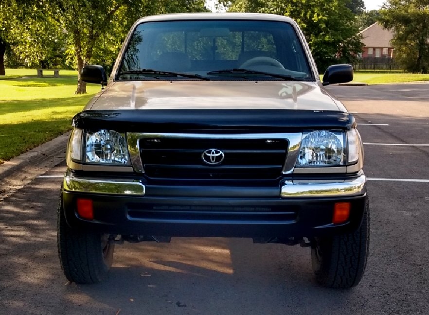

    Its holding up well for the wheel trim and bumper.
    It was the only product that would not peel off when exposed to heat for the black plastic part of valve covers on this engine.
    The picture is from around this time of the year in 2010.

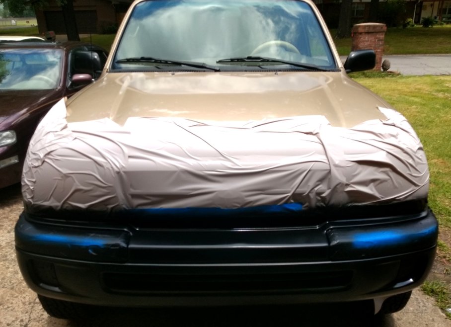

    Front Bumper Pictures - Masked the front with "adhesive backed" kitchen drawer liner from Walmart and blue painters tape. The mild adhesive allows the liner wrap it to cling to the paint like painters tape. It just peels off when you are done.

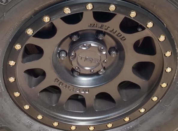

    Krylon Fusion ALL-IN-ONE worked well to paint over the plastic TRD hub cap while covering the bare metal socket head cap screws and the metal cap body.
