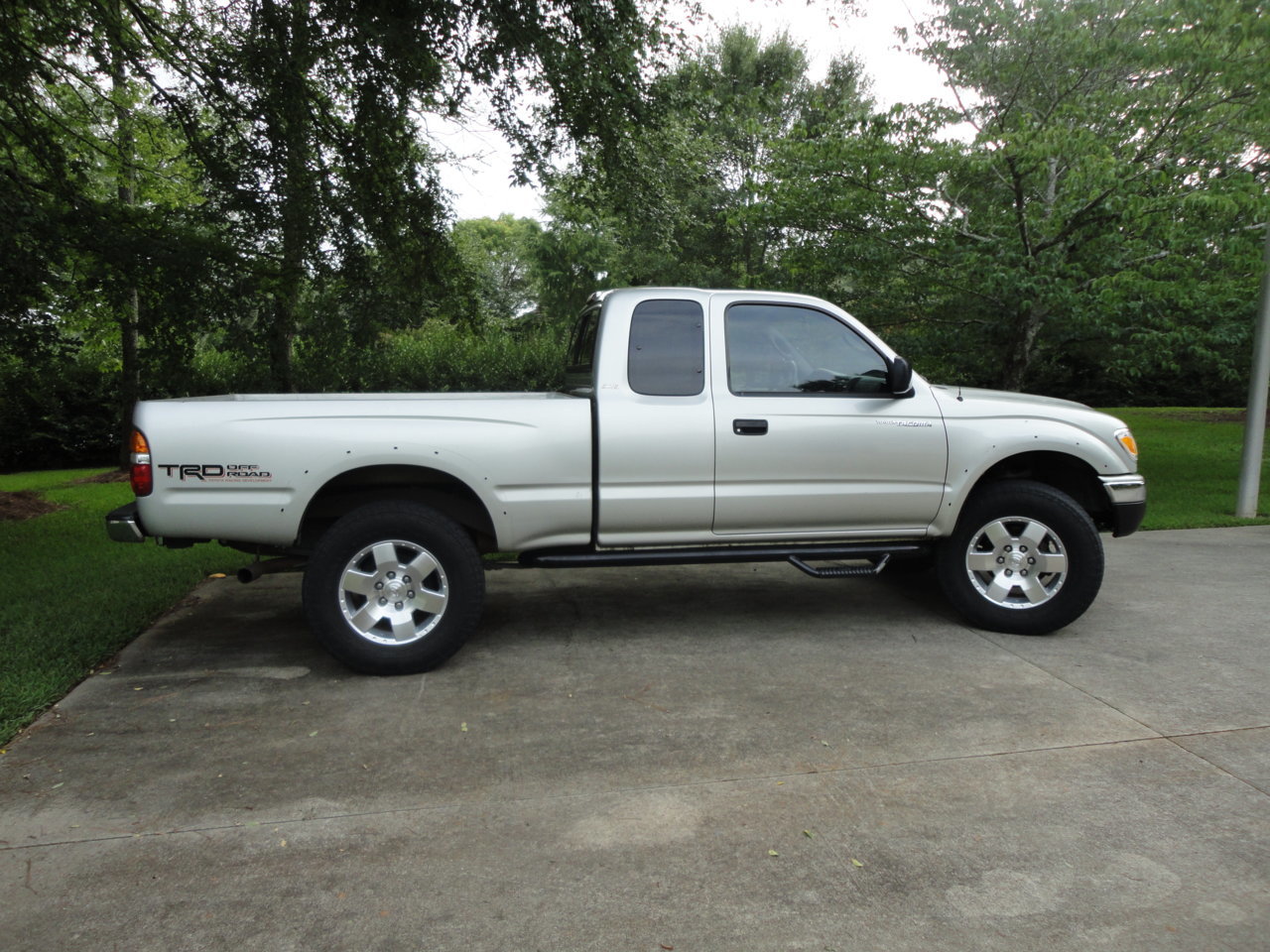

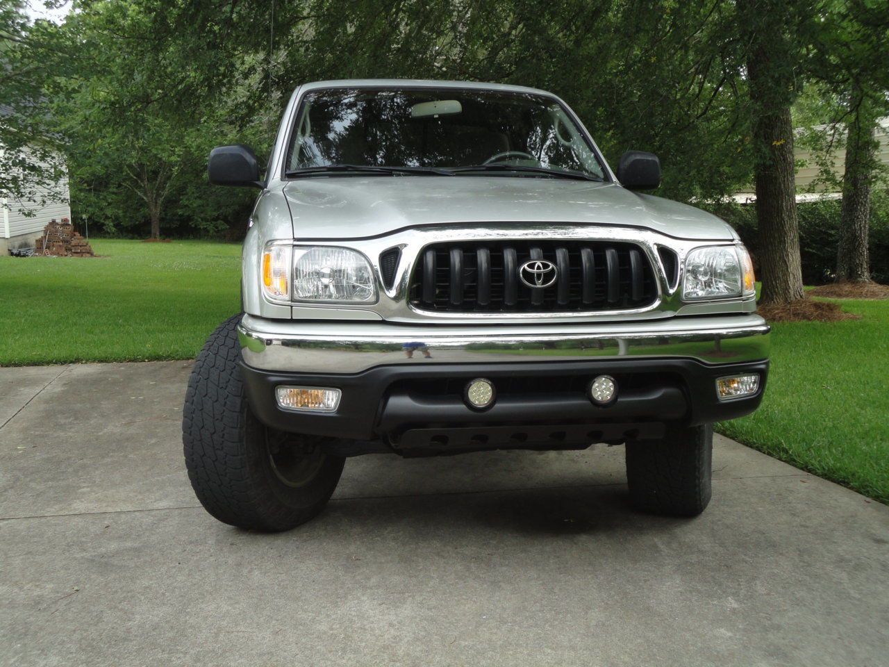

    Here's some before and after pictures of the work thus far. The truck will be sans fender flares until delivery Sunday or Monday. They are painted and look good. I hope this paint lasts for a while.

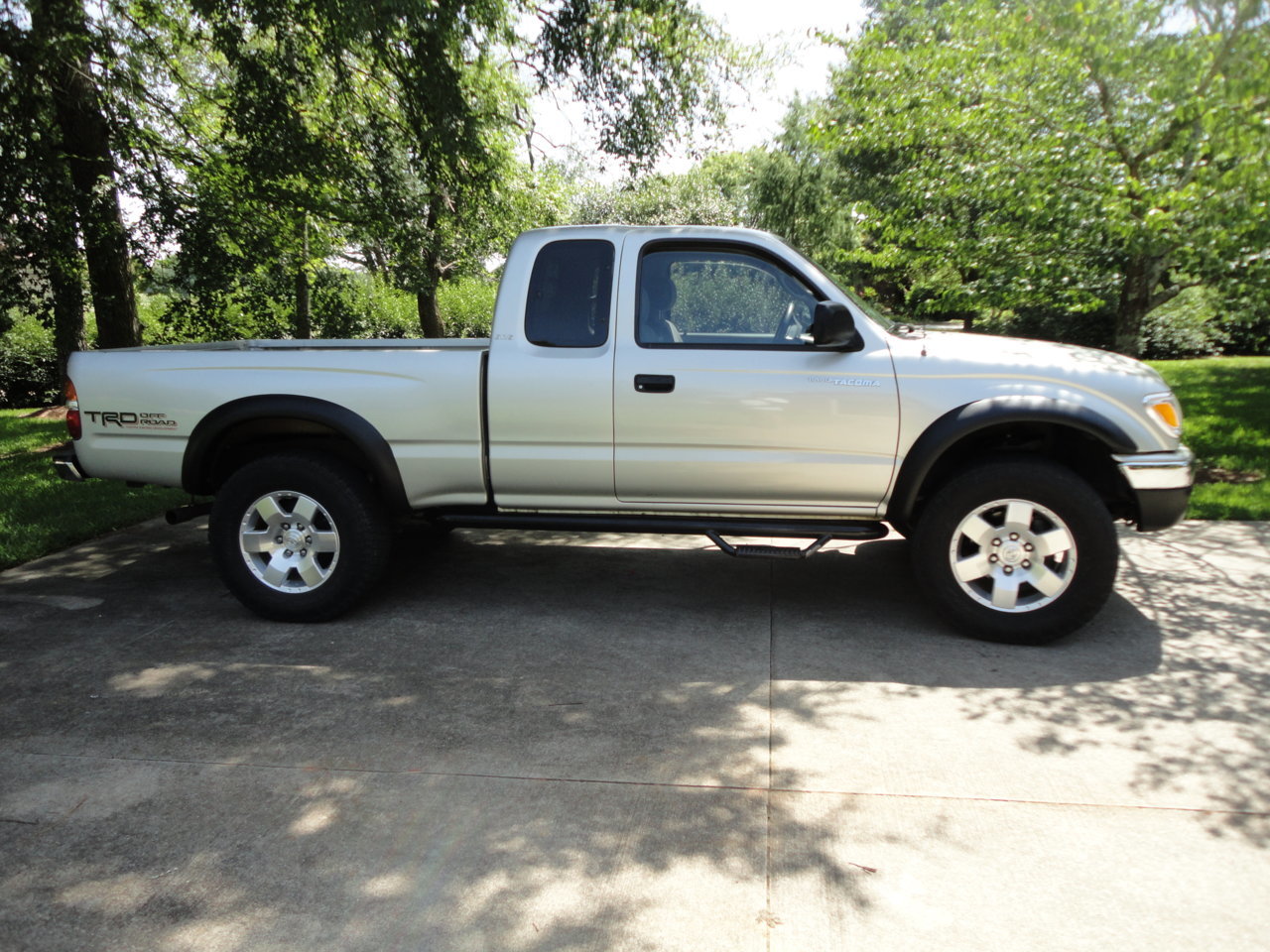

    For anyone interested here is a side photo with the freshly painted fender flares installed. It turned out nice I think. Now let's see how long they stay this color.

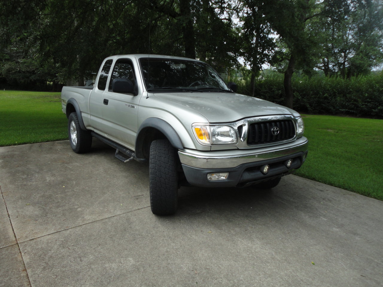

    There are three coats on the front under-bumper piece and the four fender flares. The instructions say to apply several light coats. This stuff goes on more like a stain than a coating. It dries fast but says it takes 48 hours to harden. We'll see how long it lasts; I hope it lasts for a long time.
    I'll report later if it scratches and/or if it fades.
    Here's a picture from this morning that shows the results in bright sunlight and in the shade.

    Here we are three months later and the black fender flares and under bumper piece remain black as the photos above. I'm pleased with the product and the results. Now I need new tires and will start a new thread for that.

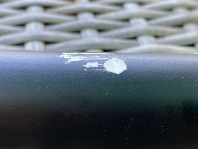

    I got a can of the SEM Bumper Coater you used and tried it on a piece of PVC pipe. What surprised me is how well it sticks to the dirty pipe that I only wiped with a rag. It seems to almost soak into the plastic and dye it, as it doesn't really have any thickness to it and where I cut some off with a sharp knife the hardness of the black coating seems similar to the plastic. Even where I cut some off I can't make it look any different by picking with a fingernail. The coating seems just as good and solid as the plastic itself.
    I expected to get be some sort of rubbery coating but it is the oppposite, which does seem perfect for flares and just about anything else made of plastic.
    This is the Honda Black color, which seems like a perfect color match to the faded stock mud flaps and slightly darker than the faded stock fender flares.

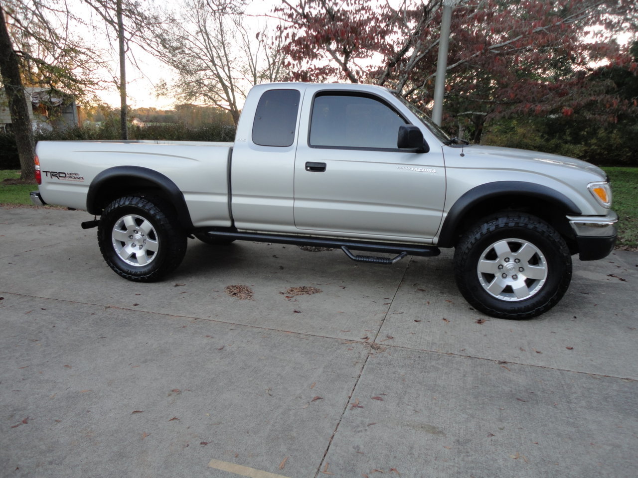

    The painted wheel flares are holding up pretty good. I polished my headlights a few weeks ago and some of the compound slung onto the front wheel flares. The spots remain but were mostly removed with some washing and some 303 Protectant applied.
    I put the 303 Protectant on the new tires too. It looks pretty good for a 17.5 year old truck.
    Rocketball and six5crèéd like this.
