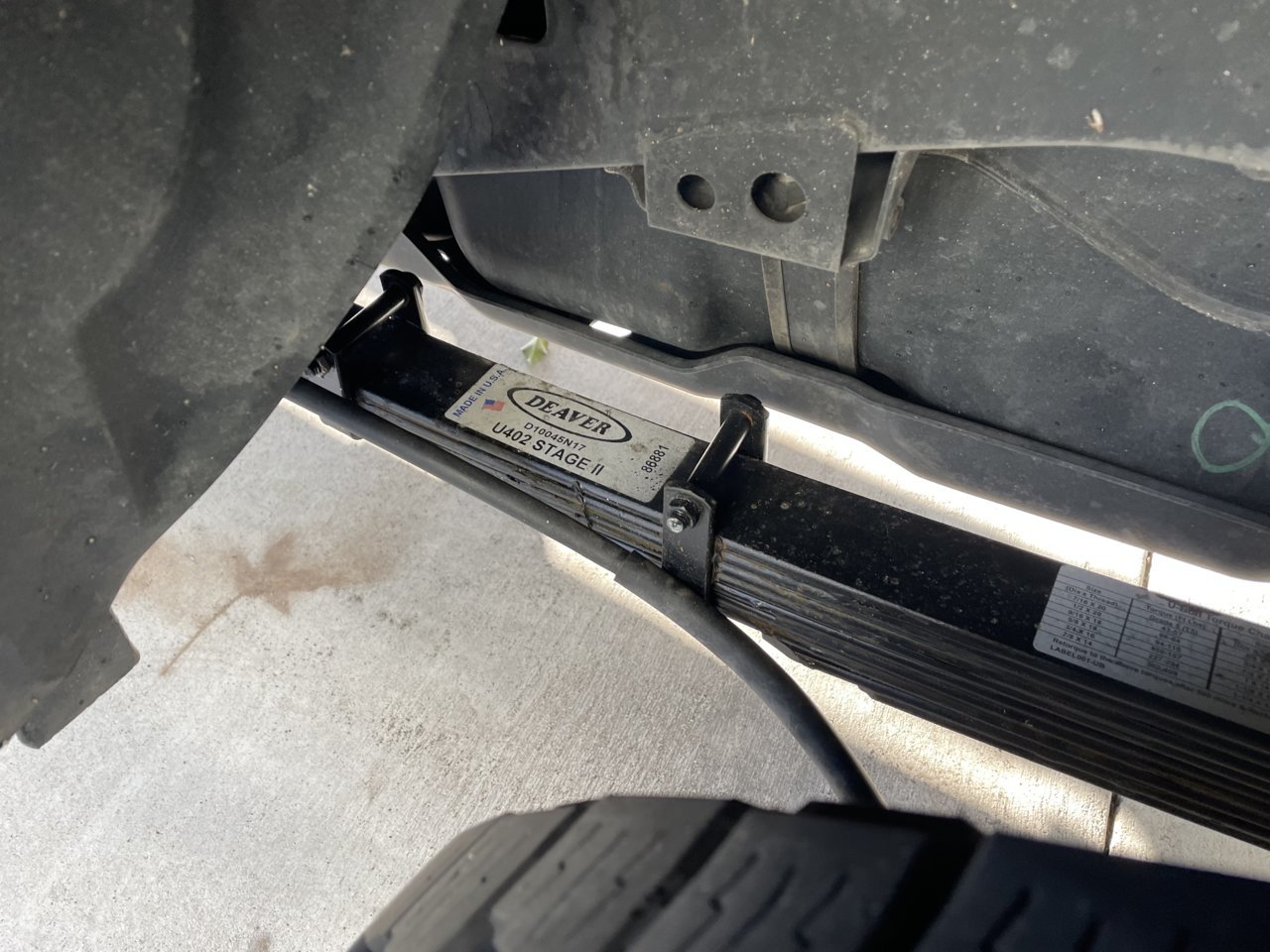

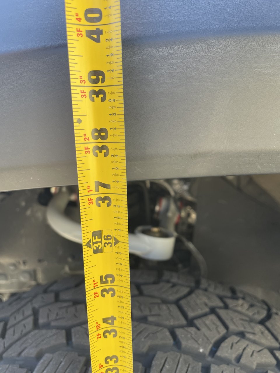

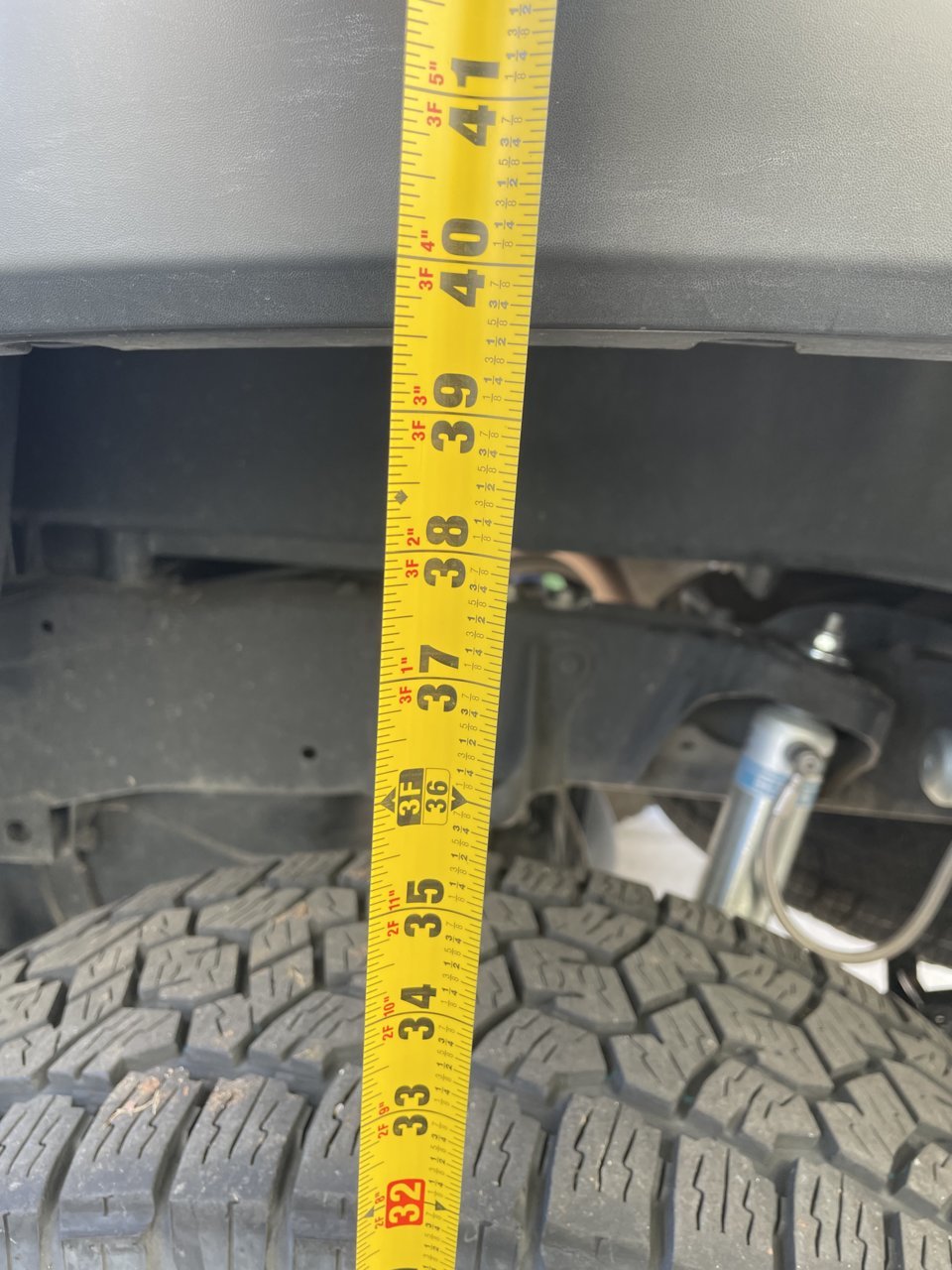

    So when I did my lift 6112/5160 All Pro Leaf springs standard - I also did the diff and carrier drop along with the ecgs bushing replacement all at the same time. No vibrations or issues. The All-Pro leaves gave a nice lift but eventually with the RLD Design cap and rooftop tent, it started to sag badly when I loaded the bed. Without load on the bed and with just the RLD cap (165lbs), the rear sat around 37 3/8 inches which was around 1.5 inches from stock height. I recently (a week ago) installed Deavers Stage II and whoa it lifted the rear a lot and is now sitting 39 1/2 inches. Now I am noticing a slight vibration at around 20-25mph decelerating or accelerating. So perhaps the new angle is causing it? Once I put the RTT (154lbs) back on, I should have 370lbs constant weight (with the load bars and custom shelving) and should bring down the rear a bit and help it settle as well. I'll report back if that is cause and the vibration disappears. I am including pictures on how it sits on the front and rear. Noticed the 6112s loss some height too. I will also get the wheels balanced tires checked.
