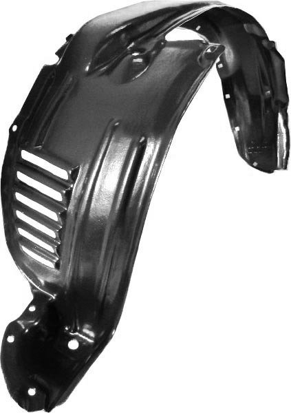

    Are you talking about these?
    If so, I have a passenger side I could ship out to you. I tore one up because I forgot to screw it back in after changing out the fog lights.
