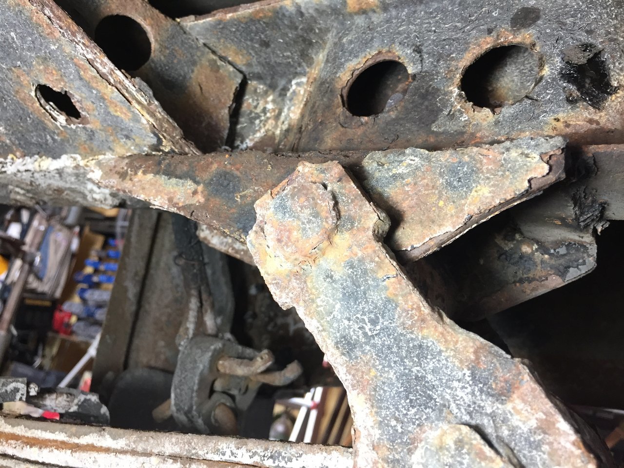

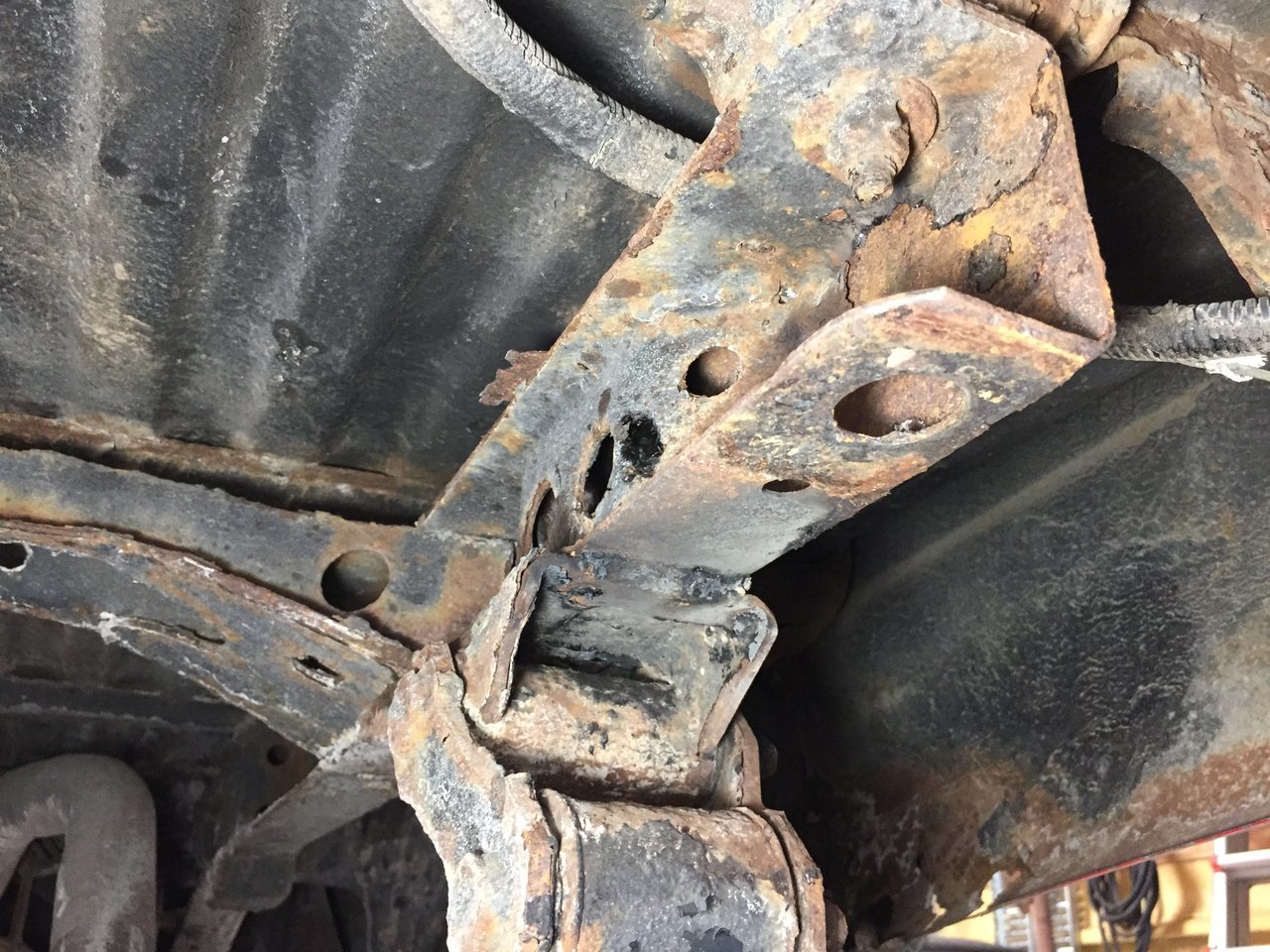

    Considering a utility bed, but if anyone has a bed that will fit like itchyfeet, I would really like to talk to you.
    Thanks again for the ideas and suggestions.
    Here’s some pics of my frame I took today.B7B51AC9-4072-47ED-8911-B2A51E7CB59A.jpgD5ED30DF-2B4F-4D6E-96CE-95B51C50BBF0.jpg

    That frame looks like it came from the Titanic, you guys go through a lot of maintenance on your older vehicles back east. We take used cars almost for granted out here.

    Given the state of the frame IMO that's a goner

    @Itchyfeet Yee of little faith, that frame is in need of some love but it isn't that bad.
    OP, look up a few frame repair threads on here. There is a ton of info on the subject. If you're any good with a grinder and welder you'll be just fine. Just don't let it go untreated for very long.

    Ho lee chet! I think its seriously time to list it or part it out, I wouldn't want to drive that more than I needed to.
    Good luck with it.

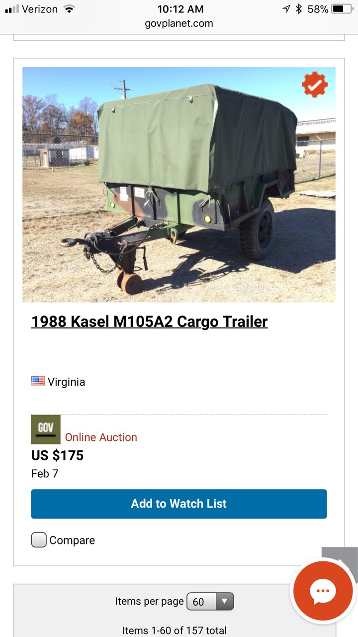

    Sorry about your truck, there’s a nice taco under all that if you are up to the project. If you are still contemplating an alternate bed, maybe one like this? You might find a good one from this site closer to your neck of the woods too.
    http://www.govplanet.com/jsp/s/search.ips
    Current bid opening price $175:

    You'll need to scrape off that old undercoat as it is junk (the toyota undercoat was just a bandaid, btw). It has dried and is now cracked and lets moisture and crap get underneath it, trapping it and making the frame rust even faster.
    You have to remove it all and remove all the loose rust (power washer and wire brush should do it). Then you'll see the whole extent of rust damage on the frame, giving you a better idea of the situation and what would need repairs. You'll also have to clean the inside of the frame, as it rusts from the inside too
    After that, you'll have to treat the frame with a rust killer/converter, then repaint it (optional) and grease it. Even if you are in texas, in a dry warm climate, you should rustproof it both inside and out, to not give rust a chance to worsen and spread further

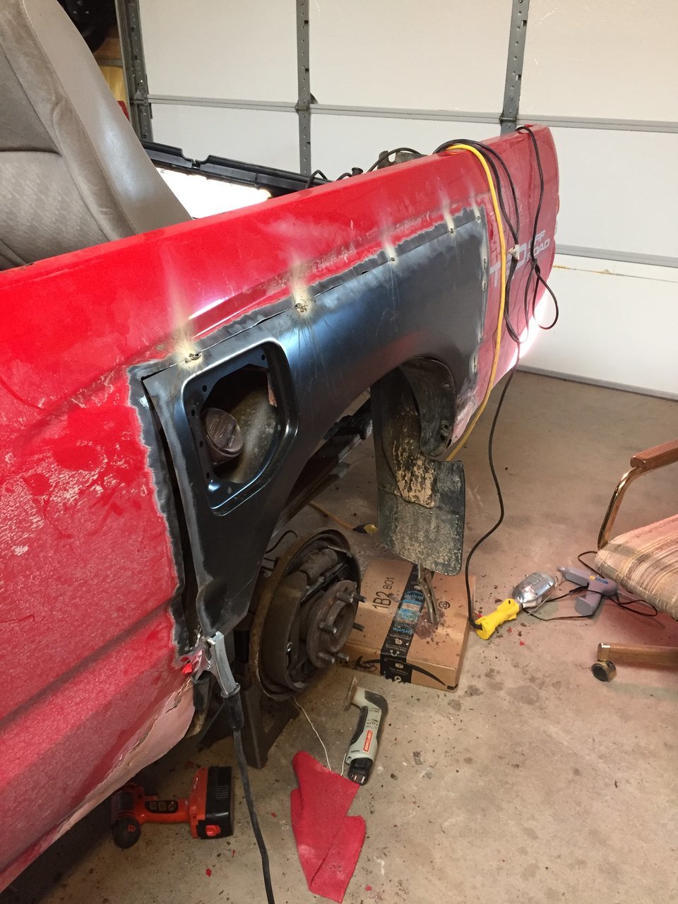

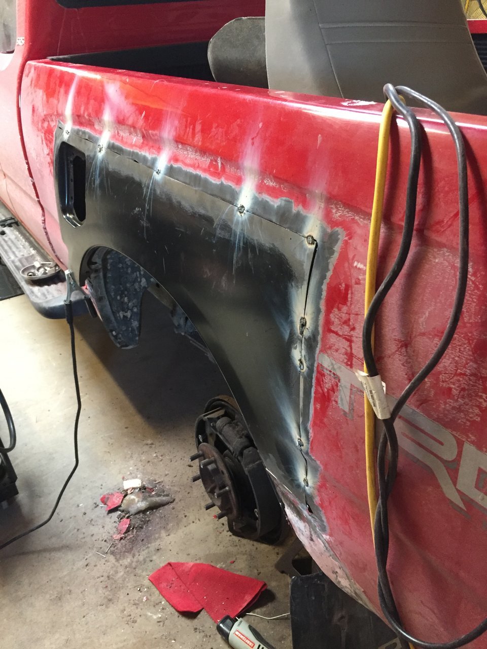

    Here’s where I am at this point

    I did that same repair panel on mine a few months back. Haven't taken the flare off the other side yet but there's a little bubbling around the flare so I suspect I'll be doing that one too. And fixing spots on the top corners of the windshield, putting on a new driver's fender, a new tailgate, maybe a driver's door, then respraying the whole truck. Project creep at it's best.
    I love the comments about it being a total goner. Apparently some people have never lived where they use road salt. I would treat the frame for sure though. Mine got a new one in 2012 and it was already a little rusty on the welds when I got it last summer. Cleaned it all up, painted it all, and fluid filmed the crap out of it inside and out.

    Are you welding with MIG flux core or stick? That doesn't look like normal 75/25 MIG, and obviously not TIG.
  18. Feb 2, 2018 at 8:21 PM

    It's a welder purchased from Harbor Freight on special. Flux core set on low power and slow feed. Just got started, but the spot welds went good.

    Props to you for making a go at it. :thumbsup:
    Hope it works out for you and keep the warping, or burn through down to a minimum. It's hard enough to do body work with the cleaner 75/25 mix MIG on super low settings. I can't imagine attempting it with the much dirtier flux process.
