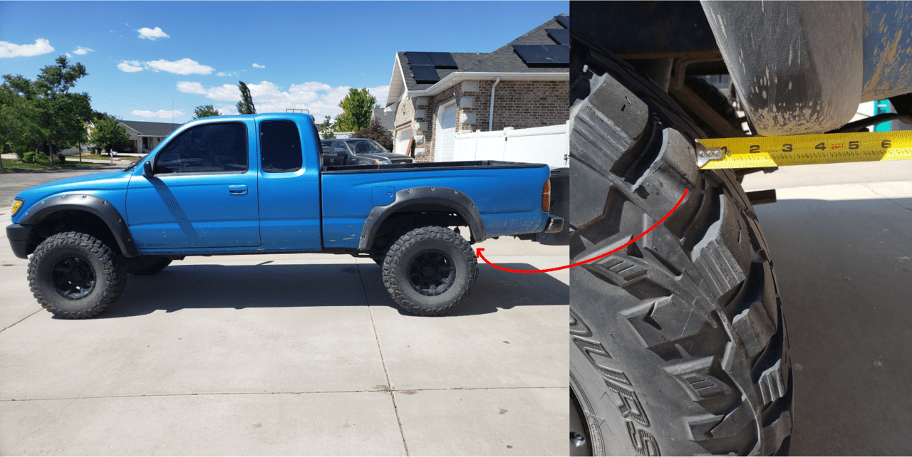

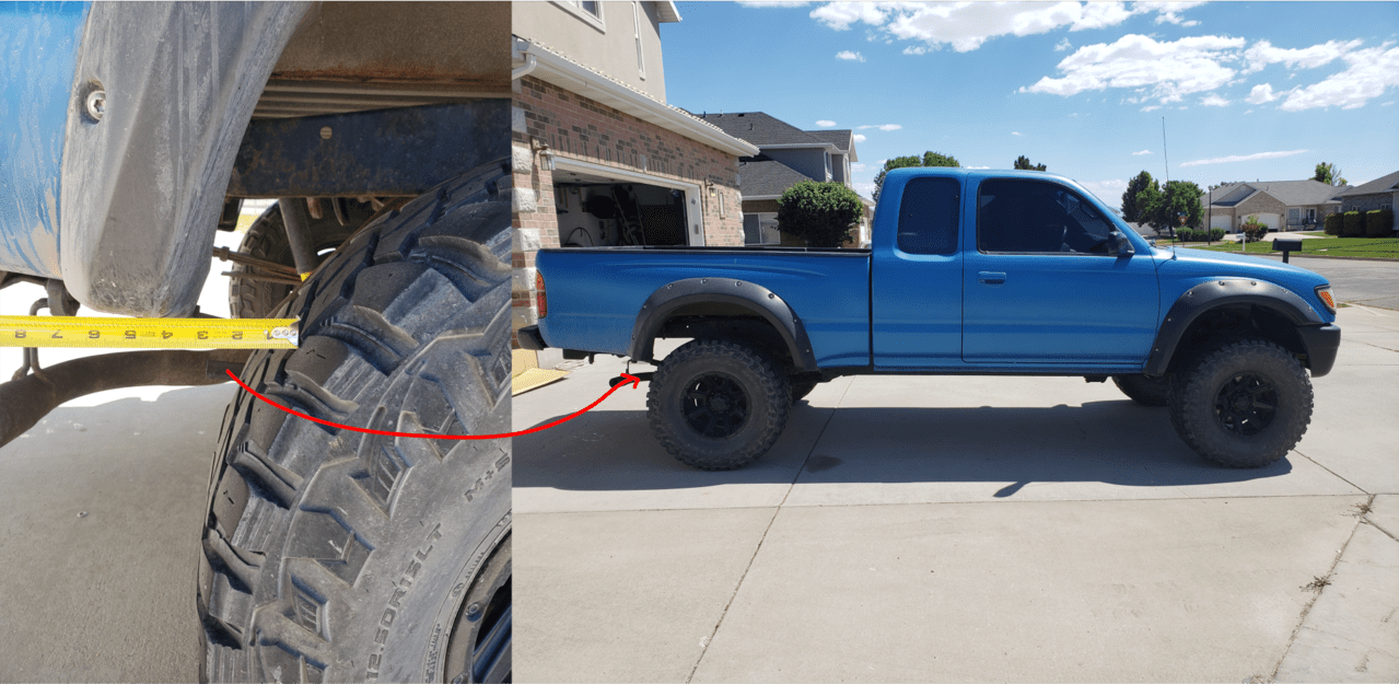

    I've noticed that my rear left tire appears further back than my rear right tire, has anyone seen this before? Tire wear looks normal, drives good, but looks off. Any ideas what to look at? ThanksLeftSidePic3.png RightSidePic3.png

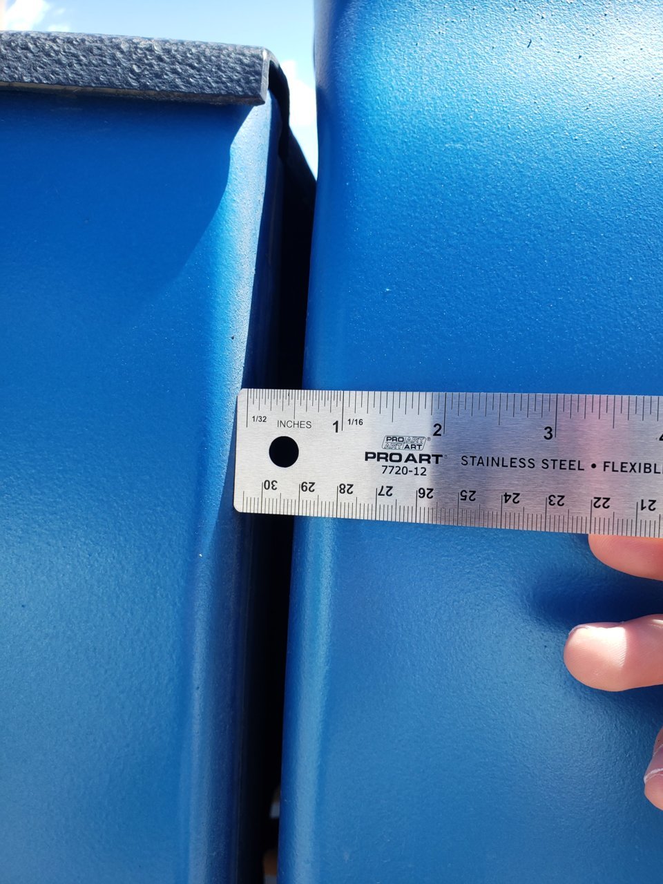

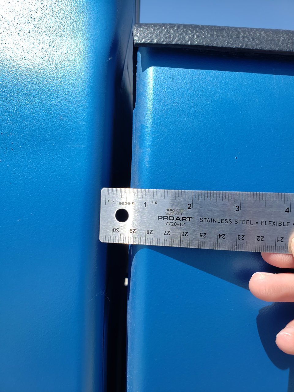

    Measure the gap between the cab and the bed on each side. See what you come up with to rule that out?

    Bed could be crooked. Easy fix. Start by checking that out.

    The gap between the cab and the bed are nearly the same on both sides, the right a little bit smaller.

    There seems to be about a 3/4 inch difference, but it could be within the margin of error for eyeballing a tape measure on the driveway

    My real advice then is to measure. When you want to measure suspension you can usually do it by starting from some point on the frame to a point on the axle or suspension .
    I am not familiar with your frame, maybe someone else can help. Try and find a place on the frame that is the same on both sides. Use that as a measure point to measure to each point somewhere on the end of the axle or hub. That can tell you if you are dog walking, or the axle orientation is crooked.

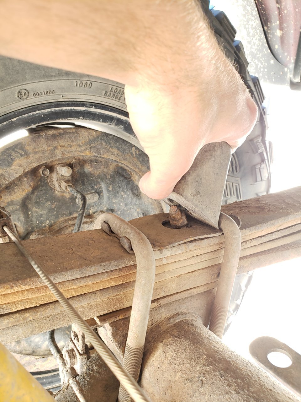

  19. Jun 29, 2021 at 2:52 PM
    #19
    a2lowvw
    a2lowvw Well-Known Member
    Jan 12, 2021
    #352533
    1,965
    Justin
    Bothell, Wa
    2019 DCSB Limited
    Stuff and things
    poke your head under the truck and see if the bumpstop is centered on the axle. Could have sheared the centering pin on the leaf spring and the axle is pushed back on that side.
  20. Jun 29, 2021 at 3:03 PM
    #20
    Cbiscuit
    Cbiscuit [OP] Member
    Jun 29, 2021
    #369937
    13
    1995 Tacoma
    3 inch lift Plasti-dip Fender flares
    Well, I think you're onto something!
