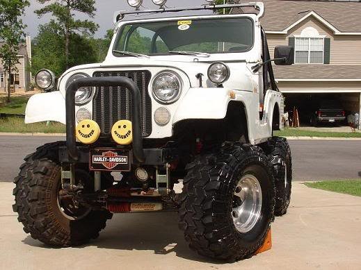

    A smaller width wheel on a wider tire will give the sidewall more "bulge" and make everything appear to be wider. On this jeep I had 10" wide wheel & a 15.5" wide tire.....the bulging sidewall makes them look wider than they actually are.
