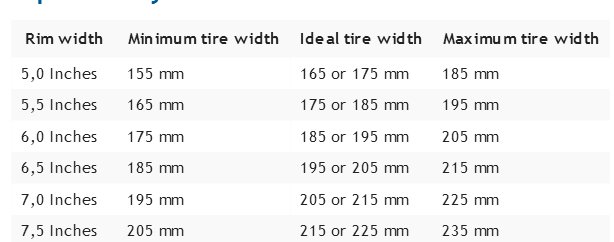

    My '03 Tacoma's tire info sticker in the door jamb lists for 16" wheel:
    P265/70R16
    I gather "265" is the tire width in millimeters.
    Given my 7x16 wheel, I'm surprised every online wheel width / tire size chart I find online looks like this:
    Why do these tables suggest the OEM tire (265mm) is far too wide for a 7" wheel?
