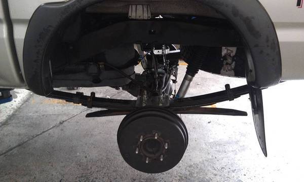

    I have a wheelers 3 leaf aal installed in the rear as of right now.. I was trying to level out my truck since it has a camper shell on it. I was thinking about installing wheelers 1.5 inch aal on top of the 3 leaf aal... would that work? Thanks guys!-Swanny...

    I don't see why it wouldn't work as long as the single AAL is longer than the top leaf of the 3 leaf AAL. It's just the the OMD leaf pack. The 3 leaf AAL has it's own spring retainers, correct?

    Yes it does. They clamp over the main leaf. [​IMG]

    Is it tall enough to take another leaf?

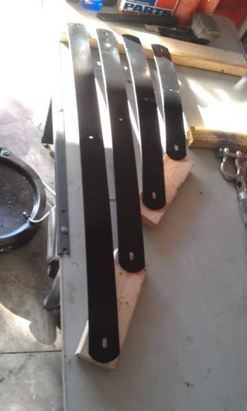

    Yeah probably about one more.. I have some donors standing by but I have to cut them to make the center pin off center. They are a little wider then stock.. came from HD jeep YJ springs. My buddy used the for about 100 miles..

    Yeah. I was thinking about shaving down both sides to that they are the same width. I have a aal but the center pins centered.. I got it for free off Craigslist I thinks its from a 2nd gen.. the guy had a tacoma..
