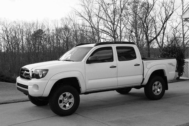

    I would go with the HD. Mine have been on for 10+ months now, I use my truck like a truck. I think the aal is good but now feel that it was putting a bandaid on the real problem; worn out, oem leaf springs. The real solution is an all new leaf pack.

    Your rig looks great! Did you leave the overload in as well? What did you do for lift in the front? I agree with the AAL being a short term fix. My leafs only have 8k on them so they are in pretty good shape, but I fully expect to replace the whole pack once they start to sag. If they make it to 50k I'll be happy, they throw in a set of Wheeler's 5 leafs. I want to maintain most of my factory rake so I'm going HD pack in rear, but have not decided as to 5100/eibach in the front or 5100/884. I want to keep the whole lift 2 in or under.

    Thanks. Non TSb & left the overload in. 10 months and still @ 2.5", did not settle at all. 5100 and 885's, solid 3", no sag and had to do LR UCA's to get the alignment.
