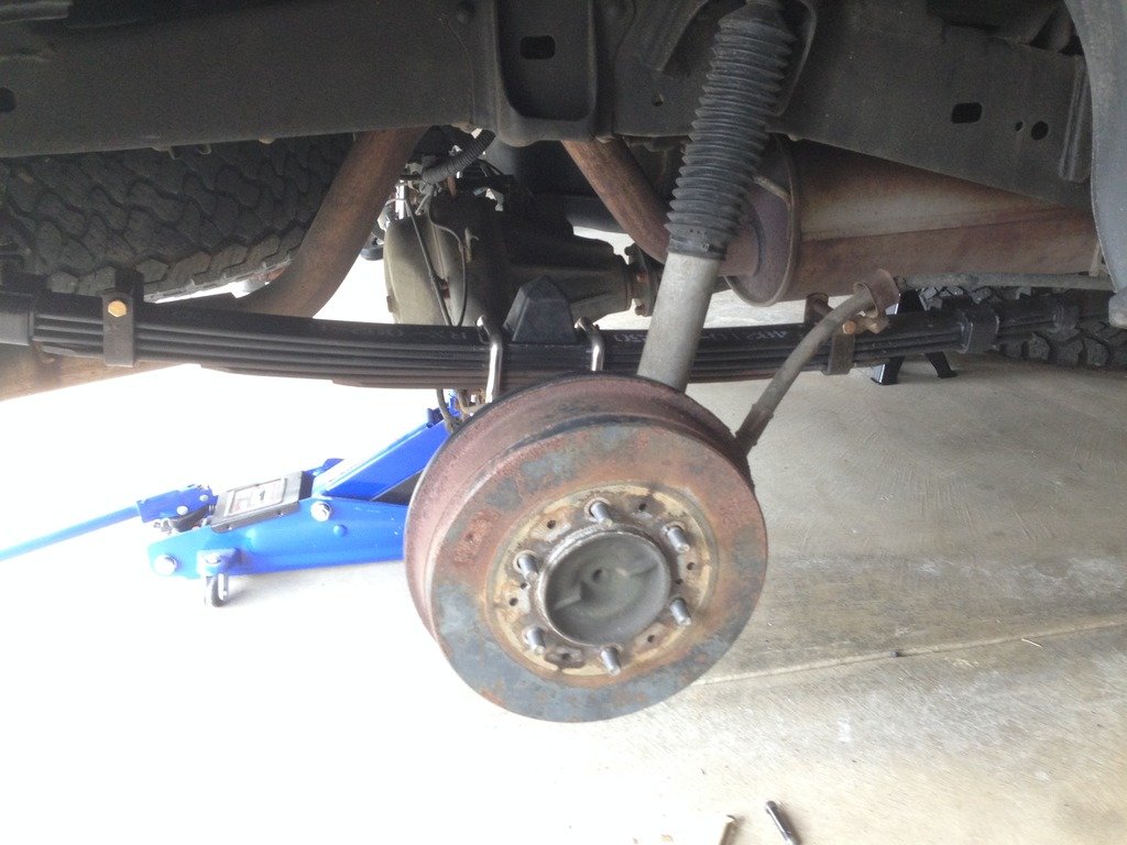

    FWIW, The brake bracket relocates to the AAL when the overload leaf is removed, like this:
    27F938D7-860A-4C52-B2D8-ECF96ECC79C5_zps_0a49c42ef2d42b630cd0b2725c0791d8b0d52400.jpg
    YotaDan likes this.

    don't know why I didn't think of that at the time. in that pic were you taking the overload out or putting it back in?

    The picture above is from when I installed the AAL in my new recall leafs that were installed by Toyota. I installed them with no overload.
    When I installed the AAL in my old factory leafs, I left the overload in. With the recall leafs, I installed the AAL without the overload because I thought the new 3+1 leaf pack would provide more lift. I was wrong and it ended up about 1/2" lower than my old setup (with the overload in). Hopefully I get around to reinstalling it sometime soon.
