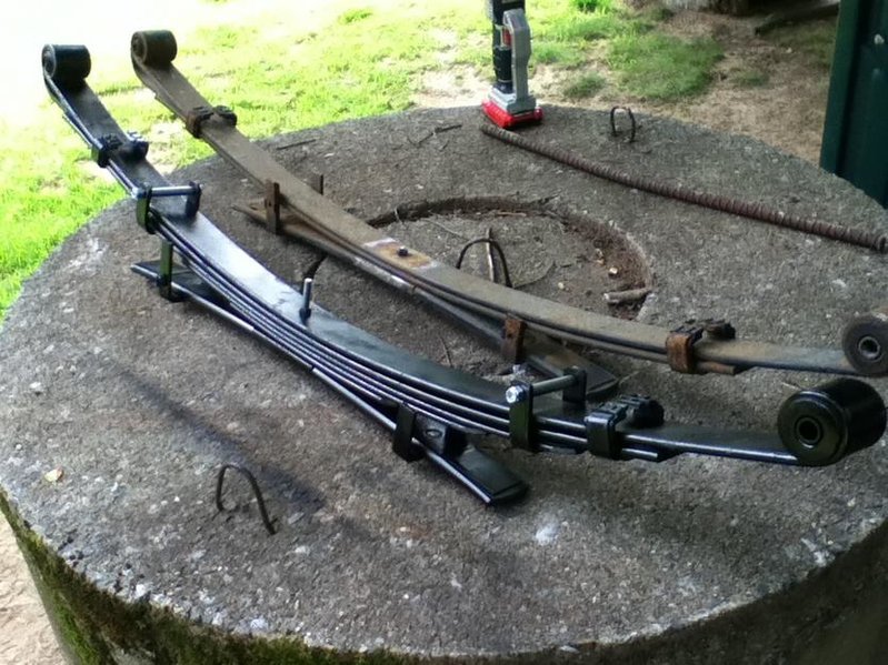

    Yeah, I'm leaving it in. wheeler's says to trim the overload leaf so it's a tad shorter than the bottom leaf of the 3-leaf aal. I was wondering if the people leaving it in did this or not.

    That's how it's suppose to look with the overload left in correct?

    yes. that's the factory 2+1 pack
