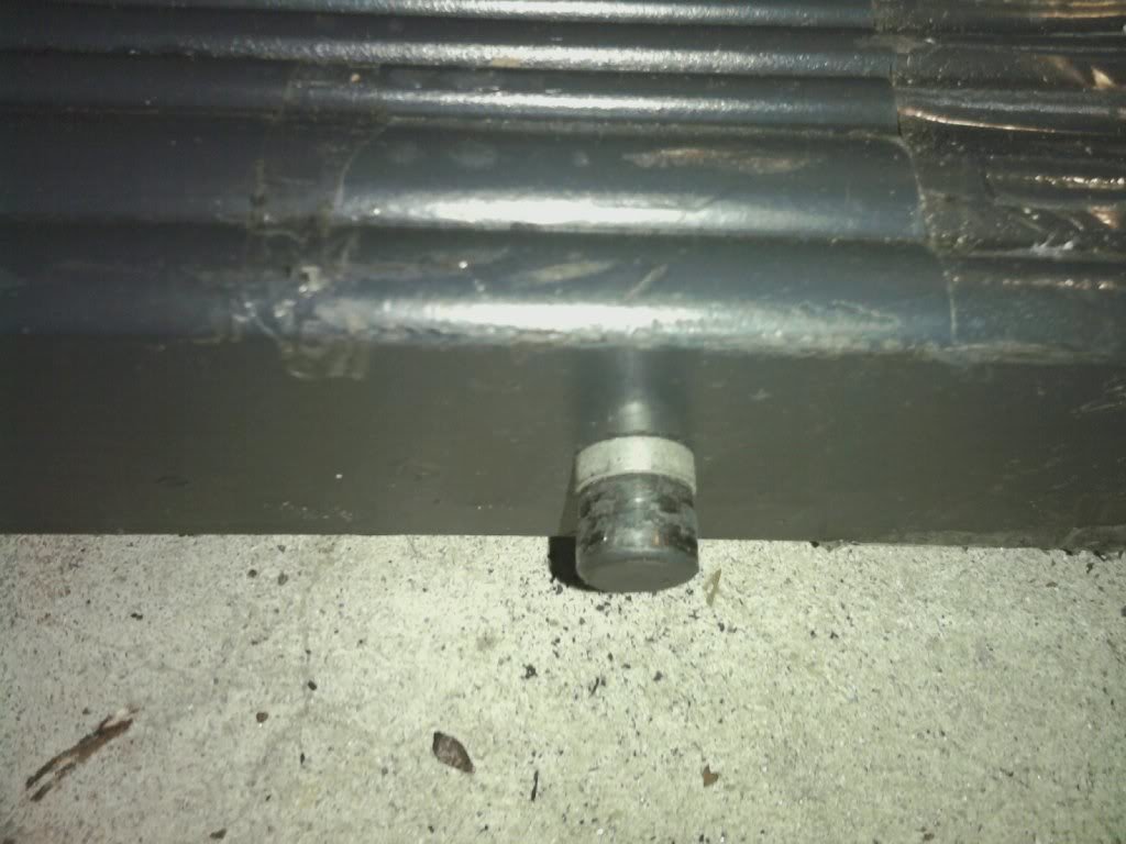

    One pointers from my install. When you install a new center pin for the leaf, make sure the head of the new center pin is longer than stock. The reason for this is if, in the future, you need to install axle shims to fix vibrations, the centering pin stock on my truck did protrude out enough to pass through the shim and engage the hole in the axle brackets. I ended up having to get new centering pins from Toytec that used a washer to make it stick out more before I could install my shims.
    Here is a picture of what I'm talking about and here is the thread discussing it....http://www.tacomaworld.com/forum/suspension/144224-dakar-installation-axle-shims.html
