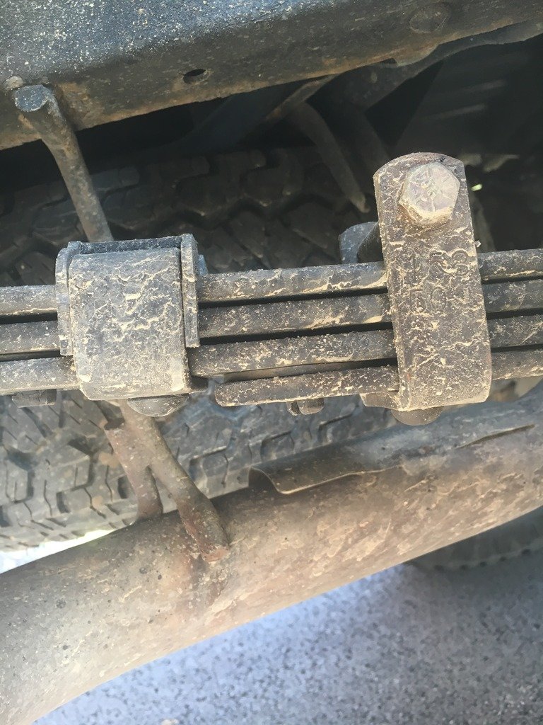

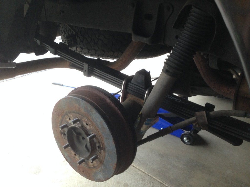

    3+1 recall leaf packs, installed a couple of months ago.
    Without AAL (two rear brackets)
    B63CAC93-0AAC-460C-8ED8-C7784A31C1D8_zps_4191630addc84607e29cce48e78887e5f15d996d.jpg
    With AAL (just makes it, no trimming)
    AA9F640C-51A3-4D77-AB6E-2768CCB57104_zps_f85fd691ba820ebc168886ed052e9090848ac2a4.jpg

    That sucks. Was hoping that was the deciding factor as opposed to no standardized clamp placement.
    Kind of silly, Toyota.
    Tectonic[OP] and Arailt[QUOTED] like this.
