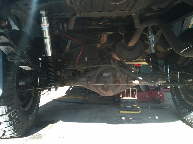

    Just finished putting in everything today (5100's/881's/5pack/brake line - Demello Sliders). It really helps to have a friend with the 'extra large' Makita impact driver and the experience. His air impact wasn't even able to free a few but the makita took care of it no sweat.
    Anyway - Take-away No. 1. Buy new top plates and cushions for the fronts if they're rusty, with the time wasted to take apart the old semi-rusted struts and pull the aged top-ends... I would pay the ~60$ (get your top-plates online or as close to cost as you can) to have all new on a ~1100$ suspension setup it looks better at the end, will last another 100k miles and save an hour-ish tracking down a spring compressor and eff'ing with trying to loosen rusted nuts/bolts and replacing a broken stud etc.
    Take-away No. 2. Careful with that damn hammer! - If you're re-using your factory shackles, be very careful pounding out the lower bolts! i ended up smashing a thread enough to have to get creative with the grinder so i could thread the nut back on.
    Take-away No. 3. Cutting the U-bolts and replacing with new will save you much time and frustration, again, the small price is absolutely worth the time savings.

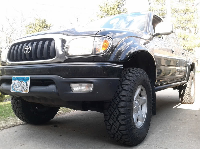

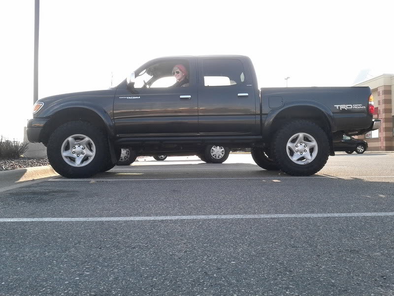

    Don't really want to muck up this thread too much, but here's a few before/after's. Currently have a 10-yard dumpster in my driveway making it hard to take a good photo.
    Pre-lift (with all the new susp parts in the bed)
    35fl
    36fr
    36rl
    36rr
    With (old susp parts in the bed.)
    37.33 fl
    37.5fr
    38rr
    38rl
    This will settle and works itself in i'm sure. Also, i noticed when i first installed my front struts/springs my CV Boots were tight, very small valleys. it worried me, but then i drove 15 miles home, and when i got out, they were 'plenty fine' pics later in a diff thread with more.

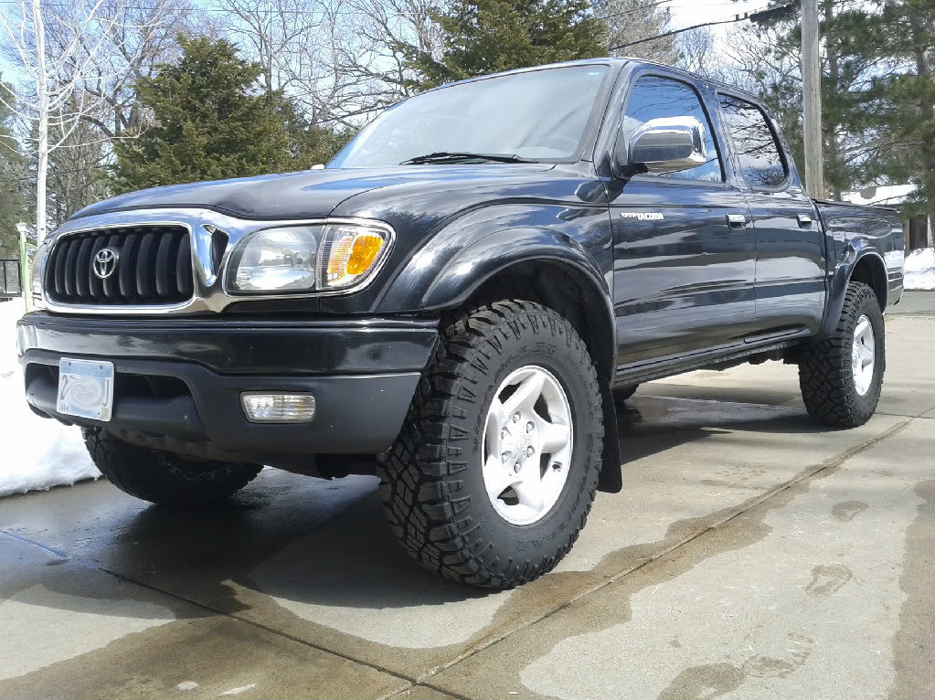

    Here's before with just the tires:

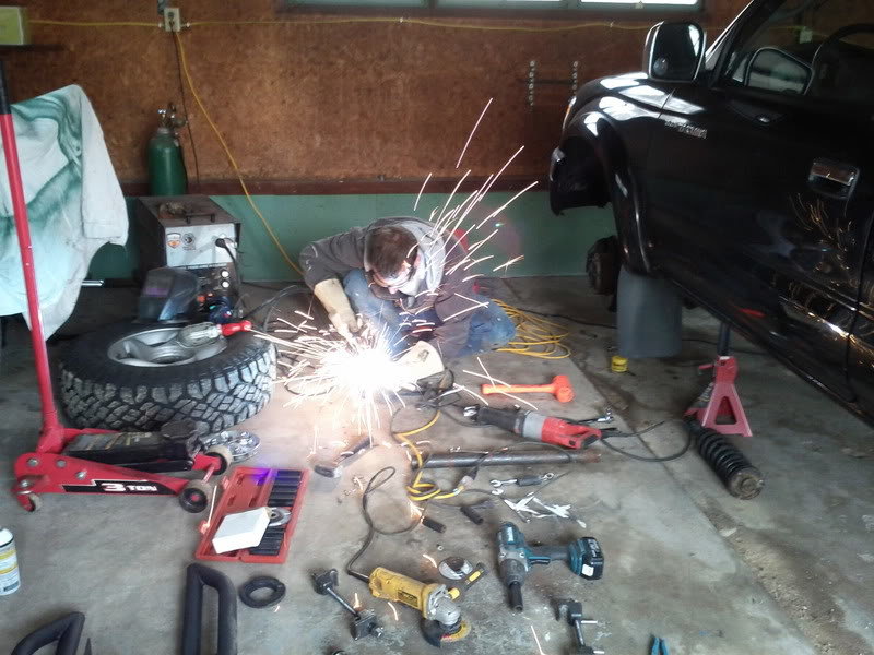

    Here's some of the process:
    replacing the broken top plate stud-
    Rear end after (Right side is slightly higher due to jack)-

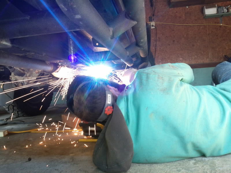

    Jeff Wwelding up sliders:

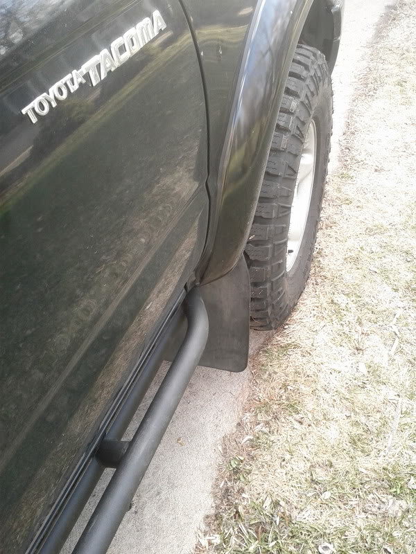

    Demello HD Round Sliders After:
    Front right After:
    The wife ready to drive me home after a few celebratory beers the day after!

    Looks awesome!

    Billy 5100's with eibach 3"coils and custom built rear leafs, brush guard and lights, sprayed in bedliner, camo interior, camo decals, new sound system, wet okole's, 265/75/16 tires, fog light mod, rear locker mod, deck plate mod
    That looks sweet. Nice job. You runnin 265/75's?

    Thx guys, yeah 265/75/16's.
    And let me say, to all you waiting to put a similar kit on when you had high mileage on your stock components. WOW. What a difference. On pavement, yeah sure, it'll be nice. When you really will love it... at 40mph on a rutted dirt shoulder... Seriously. I was on my way home and thought, "let's see what happens" so i just put it in the dirt, and no shittin', could hardly tell i'd left the pavement... jaw dropped at how smooth it was and how planted the tires stayed/felt.
