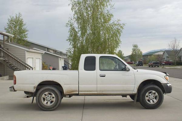

    Yes, I went all out on the suspension. Everything on my truck was pretty much shot so it didn't make sense to replace only part of the system... I have...
    Wheeler's 5 pack leaf springs
    Bilstein 5100's front and rear (front at zero)
    OME 881 coils
    new Ubolts
    new front eye bolts
    steering rack bushings
    All in all a good set up for the money. The ride is a little stiffer (I think that comes from the 881's) than I'd care to have some days but I'm still happy with it overall.
    I got about 2" of lift from everything.
    Before and after shots...
  14. Mar 8, 2011 at 8:43 PM
